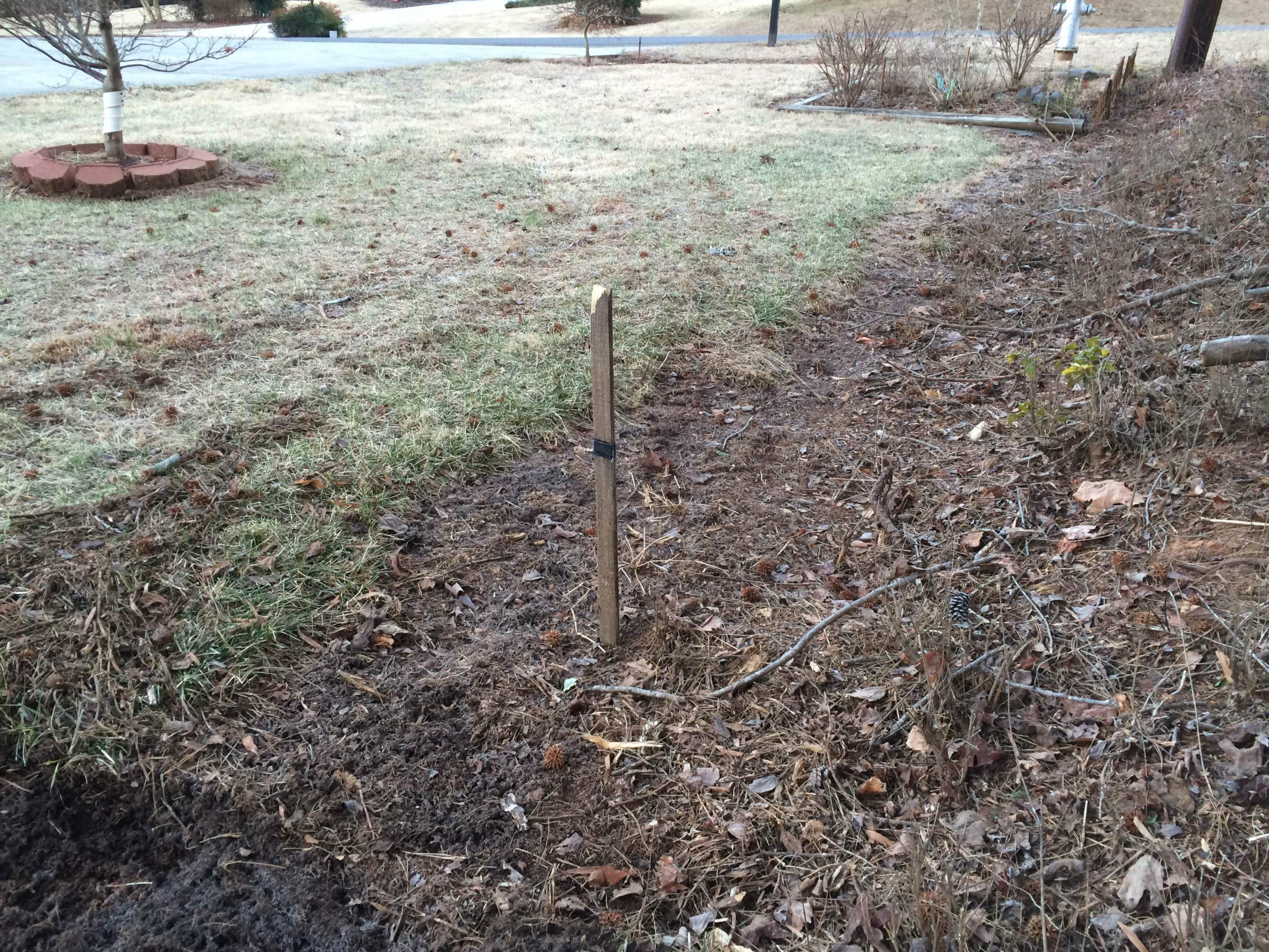

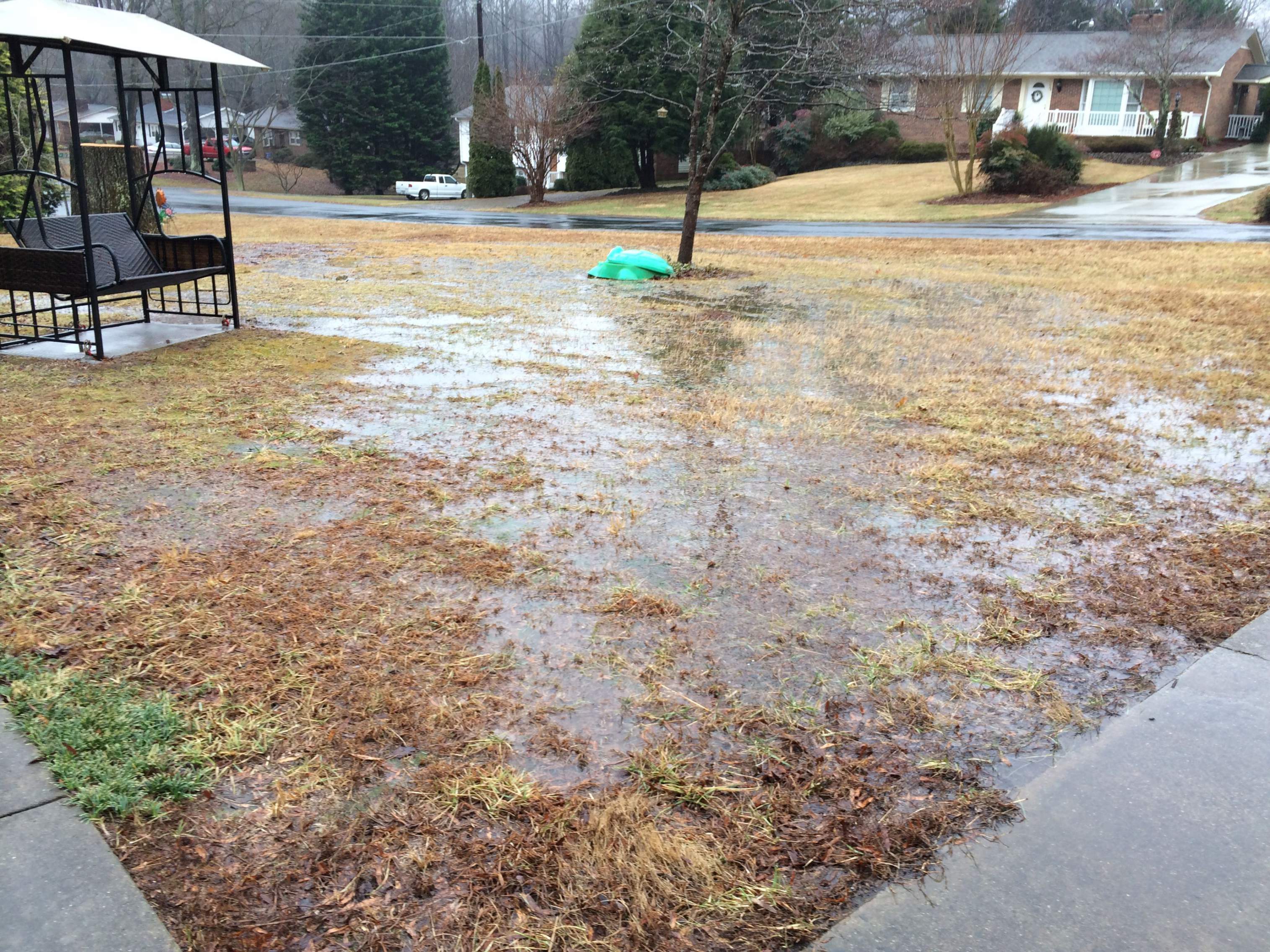

My Mom always warned me that if I didn't do well in school that I'd wind up digging ditches. I've come full circle now and that's what's it's come to. But this should actually be fun, especially if it works well.
The pictures tell it all. In photo #1, this existing ditch along the edge of my side yard goes nowhere - it just fills up and overflows onto my front yard, as you can see in photo #2. Photo #3 shows where I plan to start this ditch (foreground stake) and where it will end (stake in background), right into the ditch prior to the culvert under my driveway. You can see this in photo #1 as well.
It's total length is 50 feet, and I've measured a 10 inch drop from the ground surface at the start to the ground surface at the end. At the end the ground surface that I'm talking about is at the bottom of the ditch just before the culvert.
I plan on using a catch basin at the start, kinda like this:
Shop NDS 12-in L x 12-in W Square Catch Basin Kit at Lowes.com
And a pop-up emitter at the end, kinda like this:
Clog Free Pop-Up Drain Emitter - 4" - Amazon.com
With 6 inch flexible corrugated solid drain pipe between the two.
And of course a Kubota BX25 with backhoe to do the work. (Or most of it anyway.) I'm not that experienced in this stuff. I've got maybe 30 hours of backhoe time under my belt - dug up trees, dug a boat slip, grave for a horse, footings for a gazebo, but nothing yet that called for an even surface at the bottom of the hole/ditch.
Any advice from any of you ditch-diggers out there would be appreciated. I don't want to screw this up too badly - my wife will be watching. :)

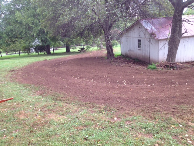

my preferred method is swails. it's not easy with a backhoe, but for this small project you might get by with a backhoe, FEL, a rake and some time. if the water is coming from what i am guessing is the right-hand side (when looking out your front door), why not dig a swail parallel to that tree line to stop the incoming water and pitch the swail to divert the water to the roadside culvert? a boxgrader angled with the 3PH would make quick work of this project, FWIW.
here are a few photos of one of my projects, to give you an idea. water coming down the hill during heavy storms was flowing into my barn. i dug a swail around the building to stop and divert the water around the building. i did this with a box grader and a rake (for finishing before seed). a drag harrow is also good to have for the finish work but definitely not necessary.

HeLa: A swale would be the best choice I think, if only the ditch at the road was lower than the low point on my side ditch (where the stake is in pic #1, on the right). It's about the same elevation next to that fire hydrant but it is lower by 10 inches at the point where it enters the culvert, and to run it there means I'd have the swale running right across the side yard. I can't drain to the other end of the side yard ditch because it would dump the water into my neighbor's yard.
Smooth bore pipe is expensive but I may take your advice on that anyway. Last thing I need is another maintenance chore.
And what is "atrium" style emitter?
Edit: Oh I see. You were talking about the basin, not the emitter. So you're experience says to use an atrium rather than the grate? As you can see by the photos, that ditch I'm starting from DOES have it's share of debris.

I would start by just opening up the ditch past the telephone pole /flower bed/fire hydrant. I looks like those three activities has produced a large mound of dirt that is stopping the natural flow of water from your yard. It may drain sufficiently by just digging that out so the water can drain. The photos may not show the whole story, but open that up first and see what you have at the next big rain. You may need to put in a swale back to the property line ditch to the telephone pole but perhaps you will be lucky enough to not need it.
In one photo it looks like you created a dam with your sidewalk and didn't provide a drain under it. This might be fixable by digging down and then driving a 4" drain line under the sidewalk. It is really hard to tell from just a few photos.

I believe I looked at extending the ditch before, but after measuring the drop I had to the bottom of the ditch next to the culvert I estimated that it wouldn't work. But to be sure(er) I drew a string from the ditch stake (at the tape) to the ditch near the hydrant. String all the way to the ground and it was still uphill. In addition I took a picture with this amateur theodolite and it showed a 3 degree rise from the tape mark to ground level at the hydrant. Would be worse than that if I went to ground level at start & end.

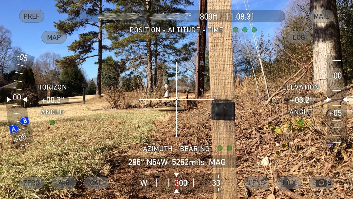

very cool. i just downloaded this. thanks for the tip!
