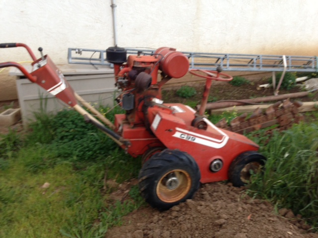

I have found that 1) I can trench more with rentals than I can possibly install in one shot, and 2) trenches do not age well.
The upshot is re-digging all those trenches out by hand with a contractor's shovel, or cobbling up something that allows the CUT to help with the chore. Neither have turned out well for me. Rain also disperses or compacts your backfill.
So, I bought a trencher off of Craig's List. Been stalking them for some time, but the $$ or condition put me off. Until now....
This "antique" Ditch Witch C-99 is an awesome little digger. It was $950 and I will call that good. The rope start kicks it on first pull every time (so far). It was well cared for and home-serviced.
Shifting forward and reverse is a little tricky. I can share one painful way not to do it, but it works pretty well once you get the hang of it. I can run an easy 2' deep when and wherever I want, and it's at least a little more maneuverable in some of the tighter places.
You trench in the reverse creeper gear, and once it's all going you can sit down and watch. It will just pull a straight line unless you hit something you should have known was there. Or an undocumented rock.
If anyone else has one, I have scanned the owner's manual and have the parts book as well. It's been out of production since at least '99.
I have finally got my pipes from the well to the house (and under the driveway, courtesy of a rental UnderWonder) and am finally making some real progress.

I junked one about like it last summer. It was way too far gone to do anything with. Engine was locked up, all sheet metal had fallen off, tires rotted, rims rotted off of tires, no chain! You get the picture.
It was given to me and I thought it might still have some life left in it until I looked it over.
Trenchers are FUN!!
I had a Bobcat Ride On w/6' chain and 35hp Kabota Engine that I got a great deal on but found out that Bobcat didn't build it and didn't parts support it. The hydraulic drive motor quit working, I sold it for over twice what I paid.
I also bought a Case 100 (about like yours in size and design) at an auction for $90. not running. I got it running and played with it then got a lot more for it!

Thanks for your reply. The manual might be useful for someone, as I found they are hard to find via Google.
Rats, still woulda been some good parts on that junker.
I now need to replace the main drain down to the septic (they installed drainage pipe, instead of ABS, and the roots have gotten in) and I am wondering if I could trench either side of the existing pipe to remove and replace. Everything is possible when you have a trencher. The poor man's backhoe!

I seem to use my trencher about once a year and it's more then paid for itself already. Once you have one, you'll find all sorts of things that you want to do that you hadn't considered. I even use it to dig out footings!!!!
Congratulations,
Eddie
   / Ditch Witch C99 #7
It looks like a great find. I've been looking at them, but most of the ones I see on Craigslist are either really expensive, or in really bad shape.
Good luck with it.

What's cool about these is that there are few safety features. Once you get the hubs locked and set it in reverse, you can go sit in the shade... it will just trench and trench a pretty darned straight line on level ground all by itself. Of course it will also trench through AC lines, sewer and irrigation pipes, sleeping deaf dogs, and anything else.
Getting it into reverse is inelegant, at best. Idle down, disengage drive belt, reach down behind rear right wheel, flip the lever around the Planetary Reducer (when they are pinched together, it's reverse). That's the hard part. After re-engaging the drive, it has to rotate around until it "catches" and it starts to crawl.
Do NOT try to pop the belt in drive to free up the reverse lever with your hand... that's what I did.
More painful than bloody, really, due to my cat-like reflexes. :eek:
