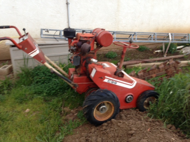

So, I bought a trencher off of Craig's List. Been stalking them for some time, but the $$ or condition put me off. Until now....
This "antique" Ditch Witch C-99 is an awesome little digger. It was $950 and I will call that good. The rope start kicks it on first pull every time (so far). It was well cared for and home-serviced.
Shifting forward and reverse is a little tricky. I can share one painful way not to do it, but it works pretty well once you get the hang of it. I can run an easy 2' deep when and wherever I want, and it's at least a little more maneuverable in some of the tighter places.
You trench in the reverse creeper gear, and once it's all going you can sit down and watch. It will just pull a straight line unless you hit something you should have known was there. Or an undocumented rock.
If anyone else has one, I have scanned the owner's manual and have the parts book as well. It's been out of production since at least '99.
