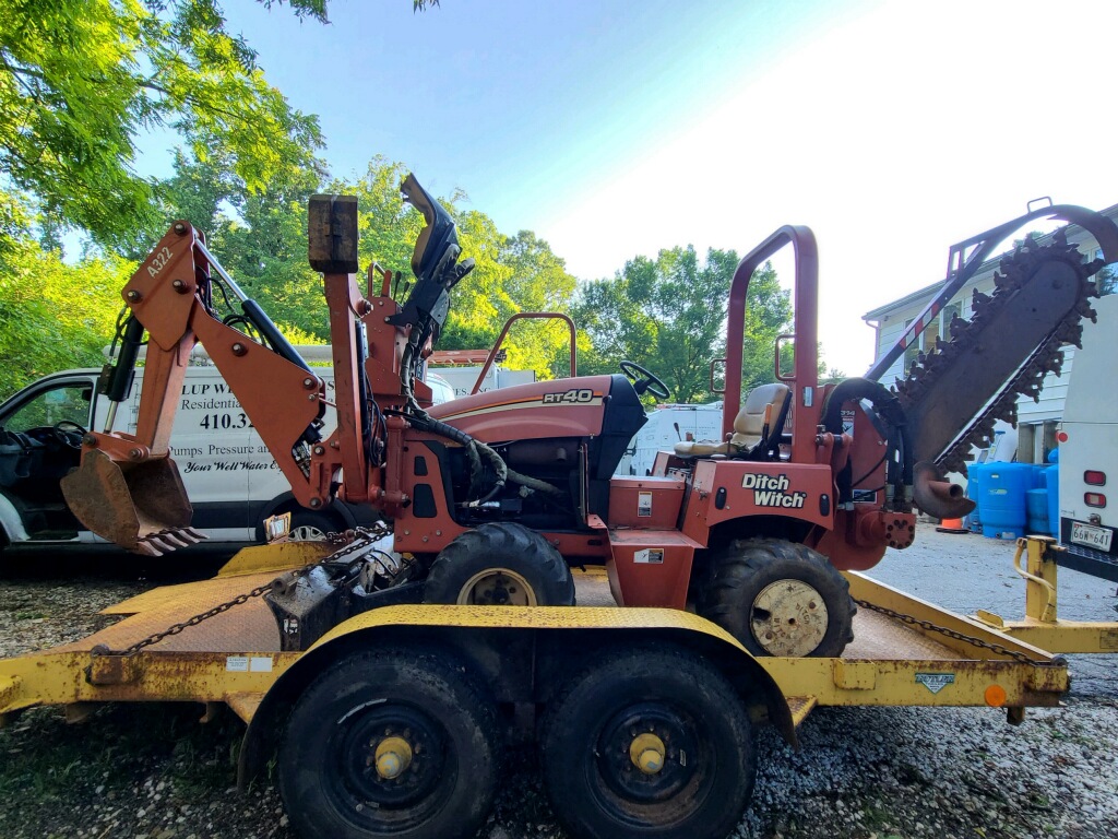

I purchased the RT40 now waiting on delivery hopefully one day next week.

It hard to see from the pic but it looks like it might also have the additional valve set that lets you work the 6 way blade and move the machine both forward and backward from the back hoe station...(in mobile drive)...these machines have two drive methods...gear and hydro...!

Yes it does and also the drilling tool and 100' of rod.
I used it at my oldest sons house to put in 90' of sump pump line and it did great but only needed to trench 2' deep, Soon I'll be off to my youngest sons place to install 1200' of water line in Mt. Olivet, Kentucky.

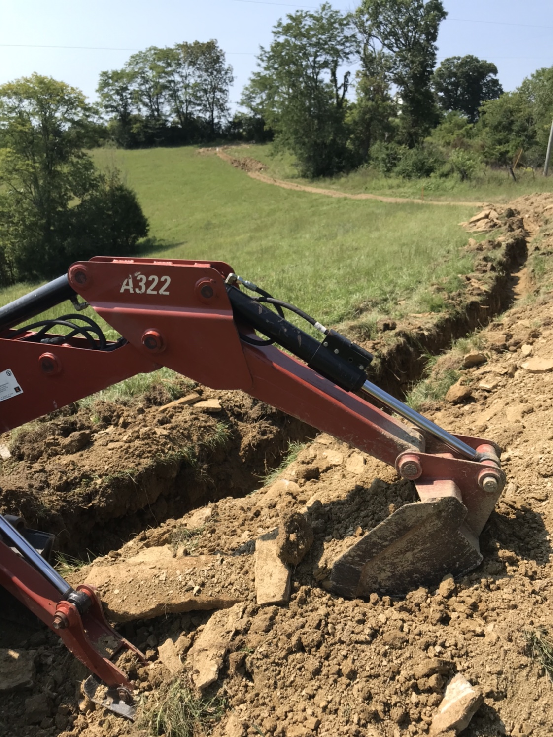

Started the project and ran into rock big rock so had to quit trenching and use the hoe. After about 200’ sprang a hydraulic leak as line rubbed on motor mount , ordered new hose $75 shipped and off to install. Installed hose and back at it but had flat tire which only needed new inner tube.

That rock doesn’t look that bad and you’ve got a rock chain to boot. I’ve ditched through worse with a similar trencher. Mine doesn’t have a backhoe but it kinda needs one for digging the end of the line out. Does the backhoe on these work pretty good or is it more clumsy than useful?

The backhoe works really well as far as the rock chain the bits keep coming out and at a creeping pace the engine will stall because of jamming,some of the rock are very large limestone and hard. Maybe I should go slower and maybe saw through the rock I’m not sure.

Finally got the water installed except for completing the backfill since I blew a hose on the blade which was my fault because I seen it was a rub problem prior but forgot about it.
I did have about 100’ where I could trench really well but besides that I had to use the backhoe.

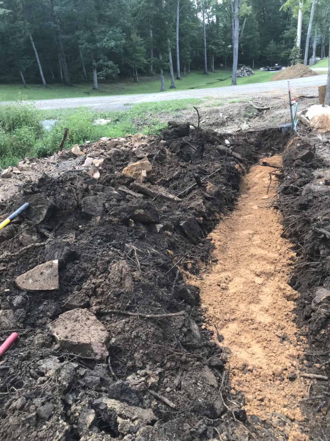

That’s a mess. I hope you’re taking precautions to not bust the line with that much rock. When I’m dealing with one that bad I usually put different dirt in the bottom and a little bit over the pipe. If it was a short run I might put the line in conduit but I’d hate to buy 1600 foot of it. IMG_8975.JPG
