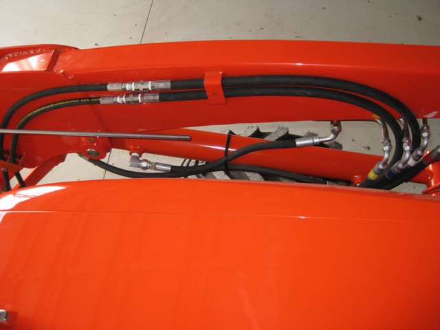

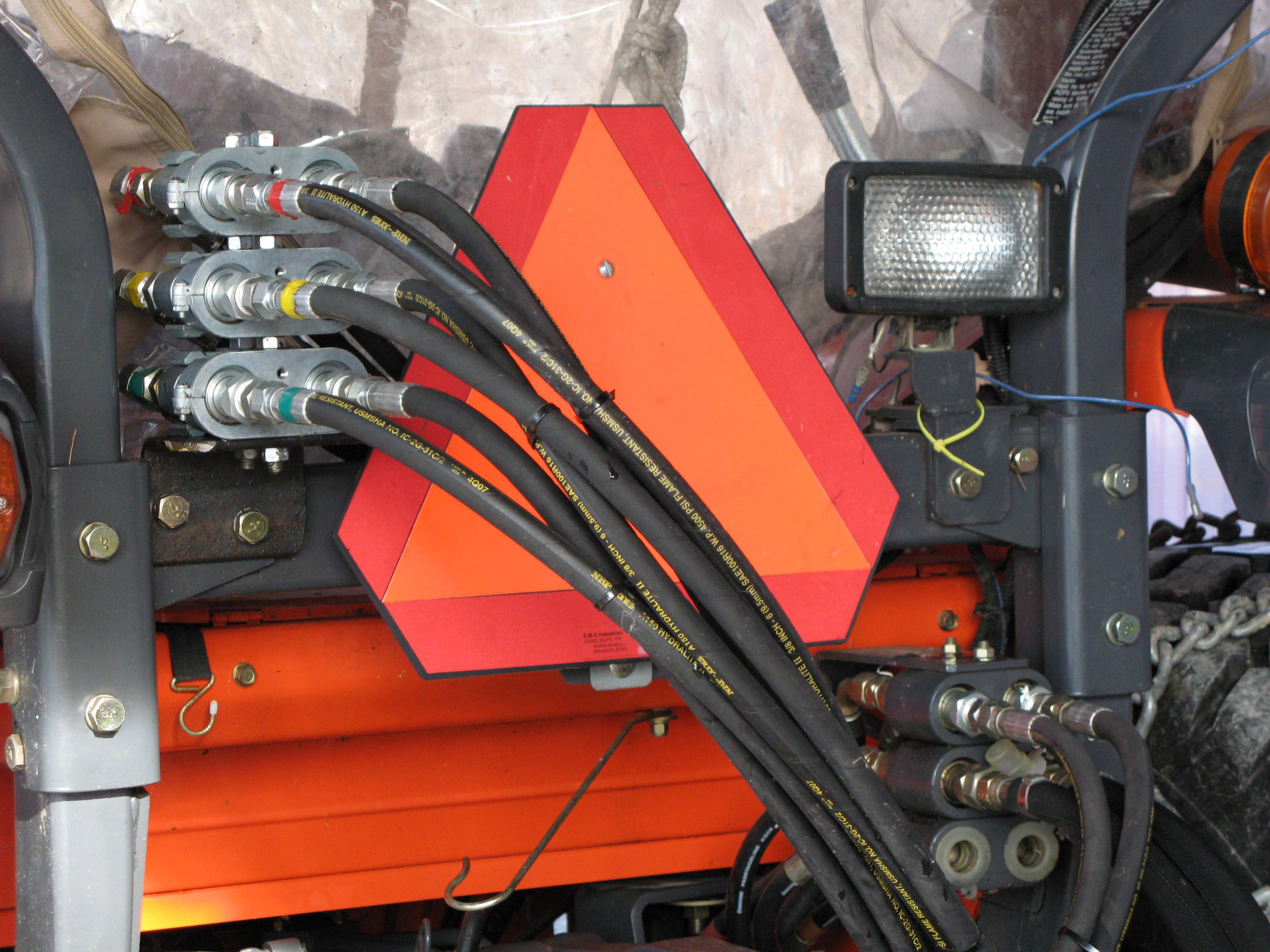

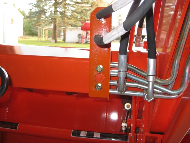

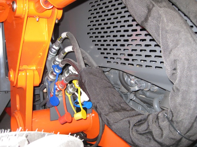

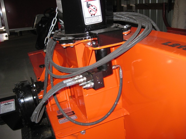

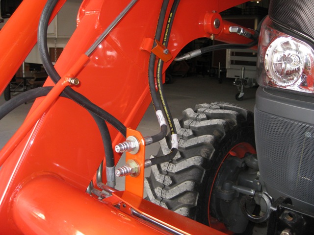

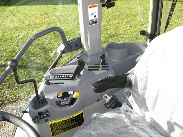

This is one of the reasons why I was looking to add the 3rd function to my tractor. Just got done plumbing it all in and everything works according to plan. Tonight I will park in on the cement floor and tomorrow I will check for any drips that may show up. But I see no obviously leaks as of yet. Next up the hyd. chute deflector on the front mount snow blower.

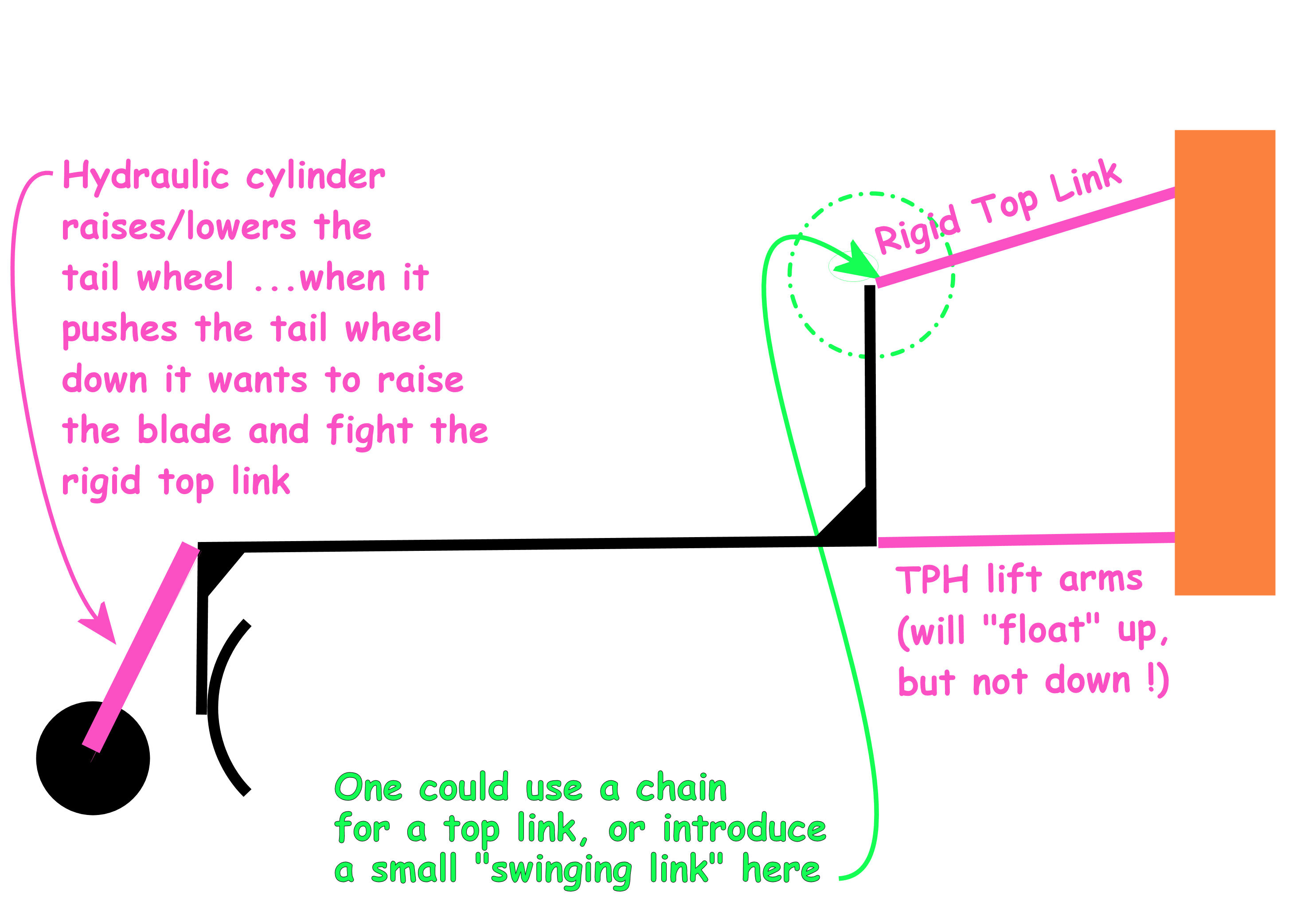

The reason I went with 8' and the Land Pride, which advertises 30" of offset, was to get well outside my big rear Turfs so I can ditch without driving in the ditch. It is heavy, though. Incidentally, I have a "cushion valve" on the angle circuits to avoid serious strain if I catch something immoveable. Another feature I find very useful is the hydraulic tail wheel ...comes in handy if I use it to clear snow and don't want to lose my gravel. This caused another complication: when the tail wheel wants to kick the blade up it fights the top link ...so, I use a "swinging top link" (actually the HF top link, which is much discussed here) ...see the pix

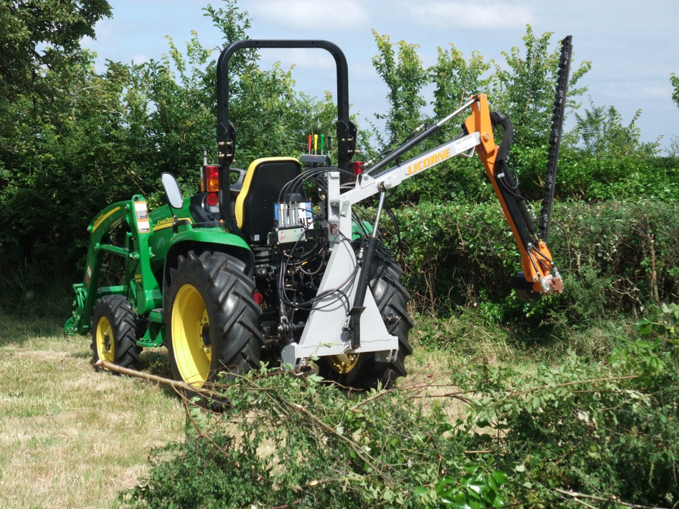

Some hydraulic motors are built with a case drain, and sometimes they call that bypass fluid. It also helps to cool the motor, and the output goes back to reservoir.
   / DIY - 3rd function joy stick - kind of #27
I have the same system for the hydraulic motor on my hedge trimmer, had to add a small direct return to sump (red arrow).
