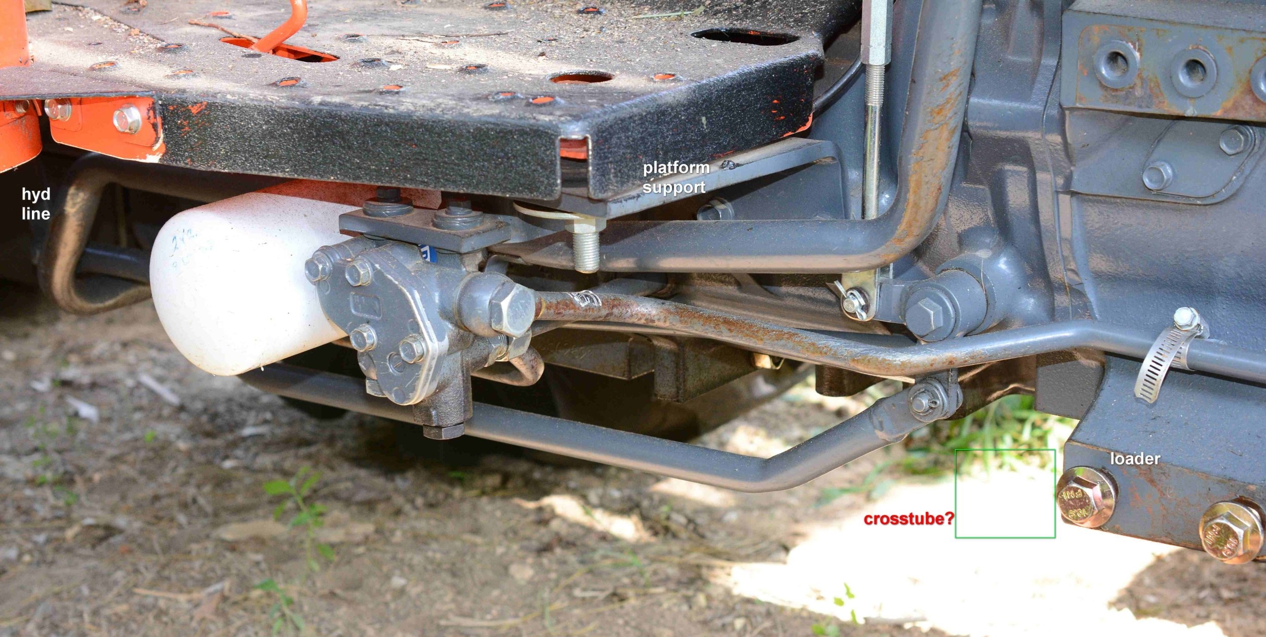

I need a canopy for my mx5200 which will primarily be used to mow about 20 acres which takes several hours in the sun.
I previously made a canopy for my L2501 that bolted onto the ROPs with four u bolts, but this time, I am considering a 4 post style mount. The reasons would be 1) stronger; 2) having a post for me to grab to get on and off the tractor since I don't have a FEL; and 3) of a lesser importance, the posts being there to push briars away from the operator's station.
I also want to fabricate a belly pan to protect the hydraulic filter and line under the operator's platform.
Both the canopy and the belly pan will require some place to be bolted to the tractor. The available attachment points seem to be the (a) steel plate to which the operator's platform is bolted; (2) the open bolt holes where the FEL would attach or (3) I could add a cross tube to bolt up to the FEL attachment point and then attach the canopy post and the belly pan frame to the crosstube.
I tend to think it will be difficult to find a FEL which to me would be in the way when mowing. However, I might could be persuaded to sell the L2501 and get a FEL for the MX because the MX is so much more stable than the L2501. If I were to use the platform as the attachment point, then nothing would interfere with using the FEL attachment points in the future.

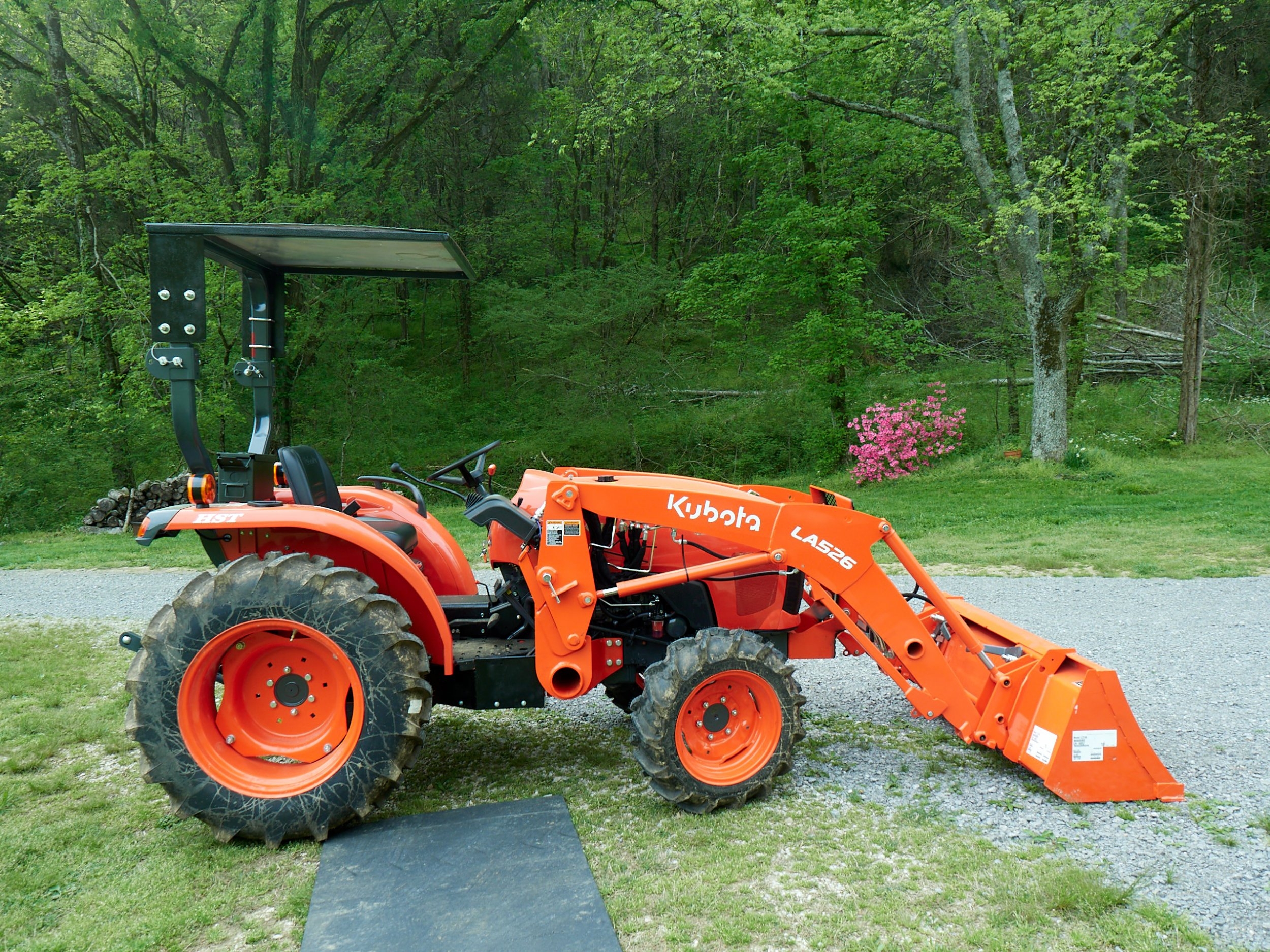

Another option is to keep the canopy entirely separate from the belly pan as was done on the L2501 like in the picture. The L2501 canopy won't just swap over because the ROPs are different widths on the two tractors.
Appreciate any insight.

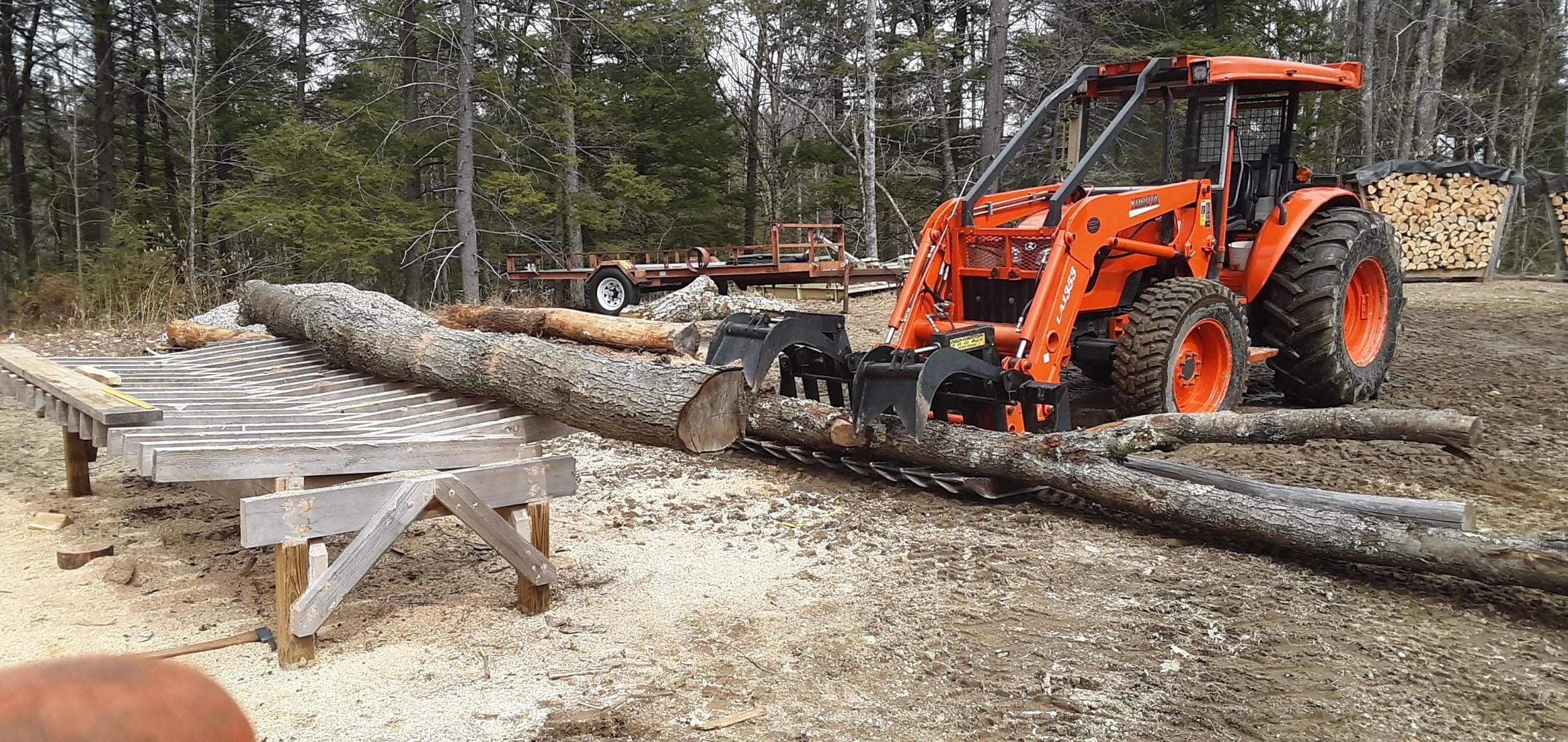

Here's what I built for a 4 post canopy, the front "legs" use the loader mount but maybe you can use some of the ideas.
I have one for a skid plat plate storage box also.

That is awesome fabrication work.
