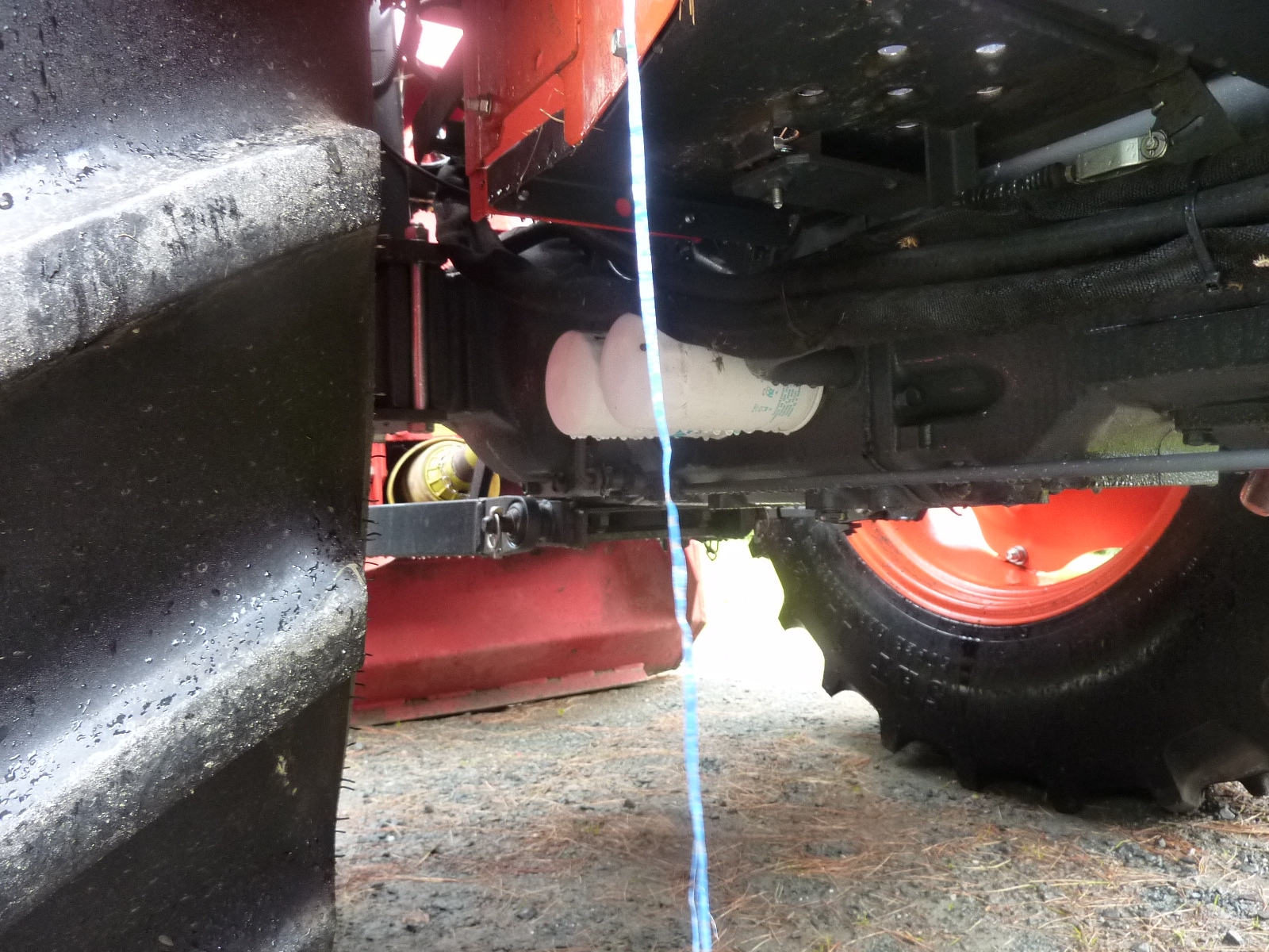

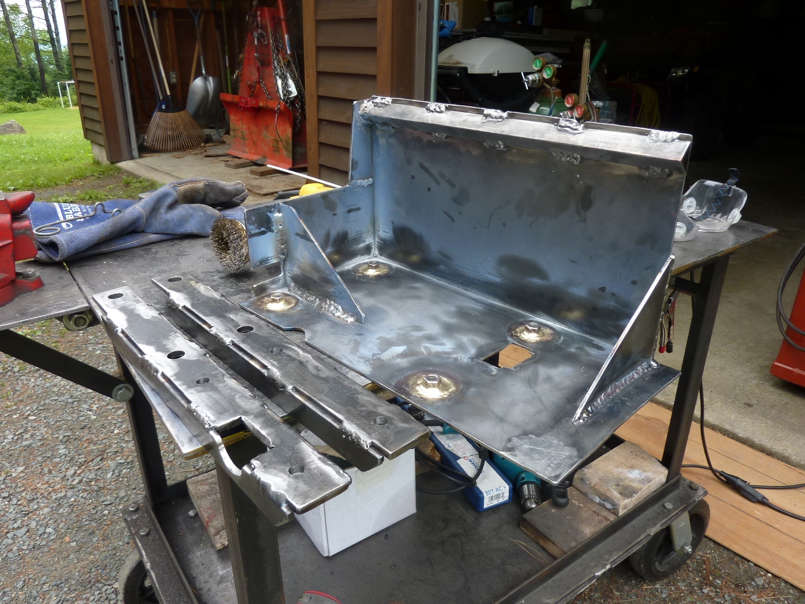

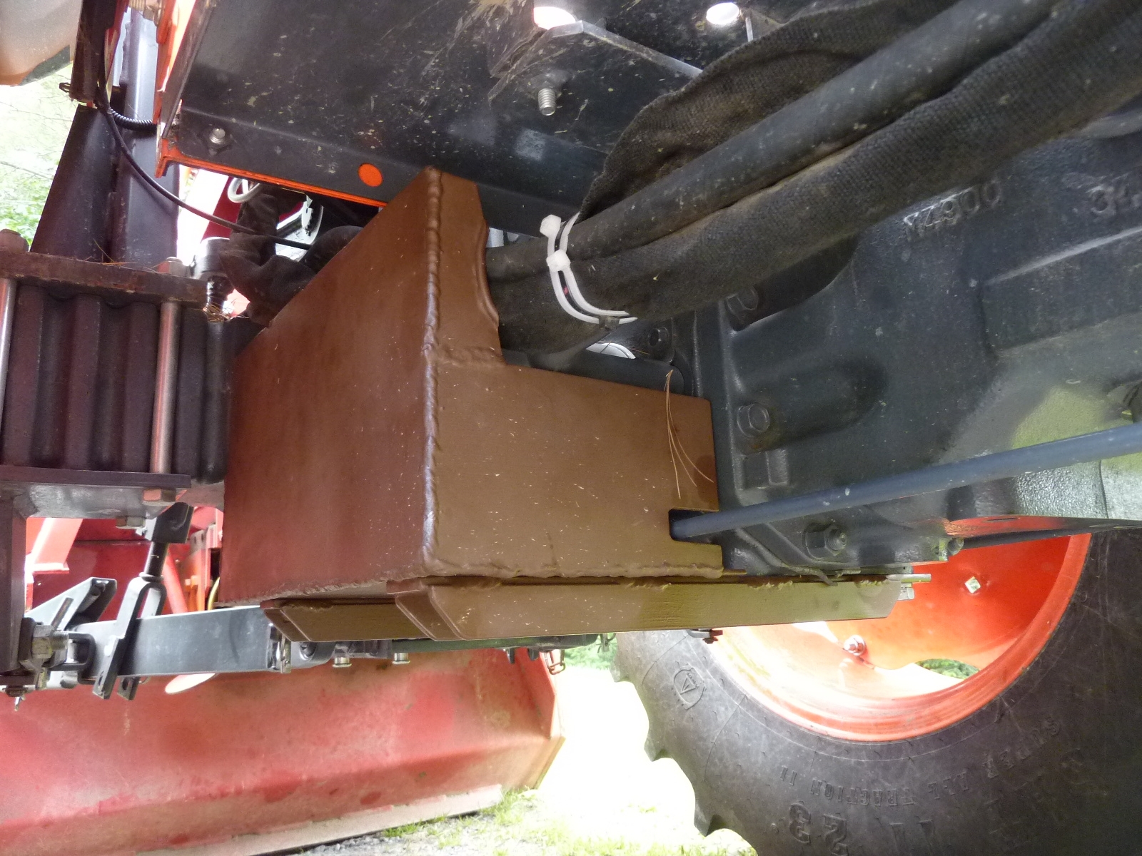

Here's what I built for a 4 post canopy, the front "legs" use the loader mount but maybe you can use some of the ideas.
I have one for a skid plat plate storage box also.

That is awesome fabrication work.

I don't have a full skid plate (yet) but protected the oil filters. Used threaded holes on the bottom of transmission to mount the filter protection.
