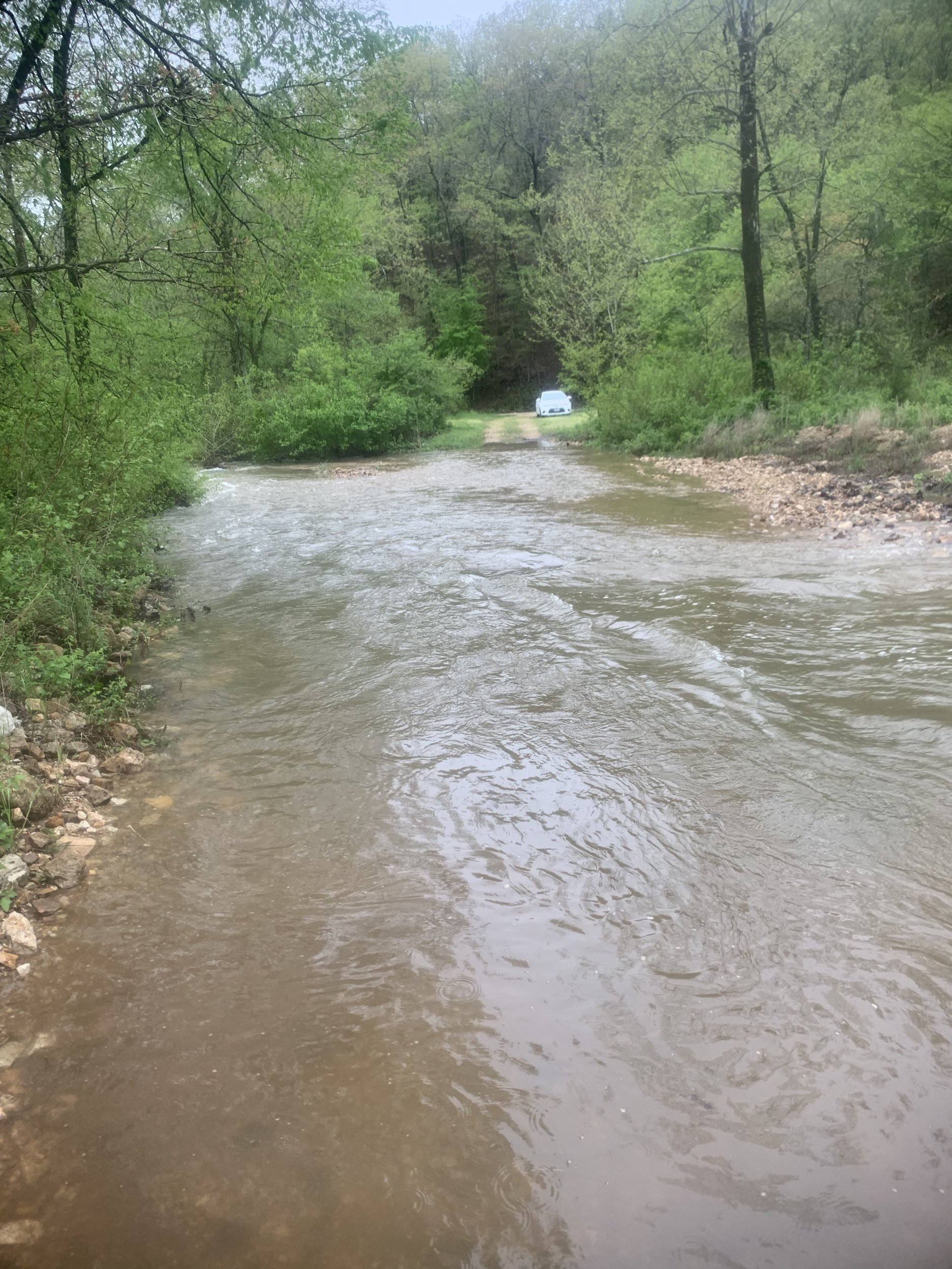

I had a similar problem to yours. Not quite as big, but similar. Ended up doing it 3 times before I got it right.
Totally agree with Spike56 to get your county storm water dept out there to eyeball it, and see what they say.
If the water gets to 4' deep, in 2"-3" rainstorms, then a bridge may indeed, be a better and cheaper (long term) solution.
Have considered having the creek bed dug out, pouring concrete ‘buttress’ walls on each side and then pouring a thick concrete slab over the buttress walls to drive over but I don’t think it will support heavy equipment. Thanks for comments.

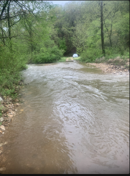

It looks like you are crossing it at an angle... is that correct? Can you go upstream or downstream to find a narrower place with higher banks to cross? It may cost a bit more to move the road but it is the only access to your home, after all.
We build a lot of bridges using concrete waste blocks for embankments; simply poured blocks, 2x2 feet by 4 or six feet wide. They also are stackable if you want to go higher. That gives you something solid to build on. We often use wooden mats to cross them, made of 16 foot long 12'x12" timbers bolted together.
Looking at your pictures, any culvert is just going to wash out... personally I hate doing a job twice.

Is a bridge not an option? Pretty easy to engineer and build a 10-12' span that can hold concrete trucks and heavier. The cross sectional area for water flow under such a bridge would be immensely more than your listed culverts.
I don’t know what sort of materials I would need to make a bridge. Know nothing about the strength of concrete when it comes to spanning any distances. I agree the an open channel will flow better than a low water crossing with culverts.

I can have a bridge built to span a 10-12 foot stream for around $3-4000. That's a few hours with an excavator, 4 waste blocks for abutments; a load of stone for rip rap; and three "skidder mats" to span the stream with. If you need to go higher than 2 feet it will cost a bit more; another $300 for blocks, Geotek or something else to use as a "deadman", and a bit more time for the excavator. You may also need a load or two of gravel. That is the route I would take based on the pictures you posted. Do that and be done with it.

looking at his pictures it appears that he is crossing at an angle. If so that is part of the problem.

Remember that at saturation the 3 foot culvert allows more water through than (2) 24" culverts. [1017 sq ft vs (2x 452 sq ft.)]
Based on the pictures you've posted though, they both will blow out at saturation.

FWIW, creek beds usually wash out to a size that naturally handles the flow of water including seasonally heavy flows. I'd be very cautious about putting anything into a creek bed that obstructs the natural channel because one has to assume that the creek bed is the size it is because of the water flowing through it over time.
I’ve followed this dry creek bed about 5 miles. Above me there are 3 places where this creek & smaller creeks feeding into it cross the road. Each crossing has a low water concrete slab. The largest crossing is maybe 30 ft. The reason it’s so wide at my drive is because of it jogging west, east and then west again. I think just cleaning up the creek bed and taking the turns out will help tremendously.
