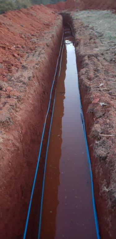

#98
I was amazed how well my tractor is doing back filling the trenches. I was able to spend 5 hours back filling using the dirt between the two trenches.
I got a lot done. Very impressed with the tractor. I have 440 cubic yards to fill the trenches in both were dug a little long.
Here are the trenches partly filling in it is going to rain for the next 3 days so it will be a while before I can finish.
