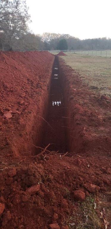

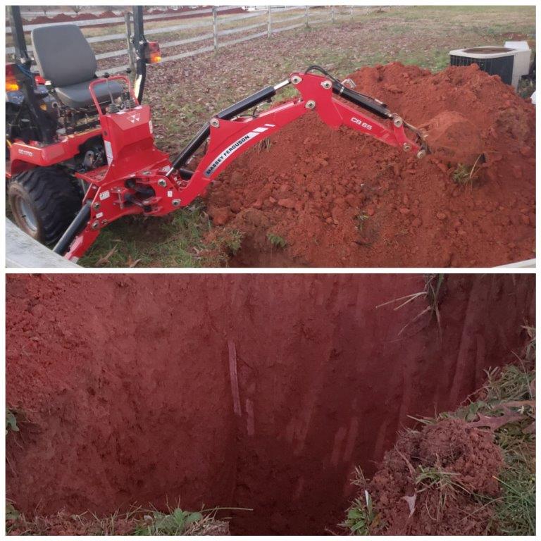

We had to deal with a lot of rain on Saturday and Sunday a couple morning showers. But after lunch we were able to dig. One 270 trench 3 wide 6 foot deep is done.
I have started digging from the house to the fence 4' wide 5'-6' deep.
I sure wish I had bought a 16" bucket but I am getting it done with the 10" bucket.
I guy that is digging has a day job digging for someone else so he will come after work to finish.

Try to get some good topsoil in direct contact around the geopipe. Clay is not good.

Clay is what we have here the top soil is very thin here just a couple inches. That is why we put in extra loop in because of the clay soil.
I am putting in 800' pre ton.

Yeah, but... but... your dirt is RED! :eek:
Yes, I know, "in the south"... but it still gets me every time I see that! :laughing: First time was when I visited my brother at Redstone Arsenal, in Huntsville, in 1966. Had never seen red dirt before. :confused2:
