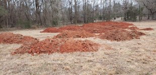

My tractor is working hard. I have moved about 75% of the dirt. I spend all day on the tractor yesterday. I used 6 gallon diesel fuel.
It is raining again today and tomorrow. I am still slowly getting it done. 440 cubic yards is a lot of dirt.

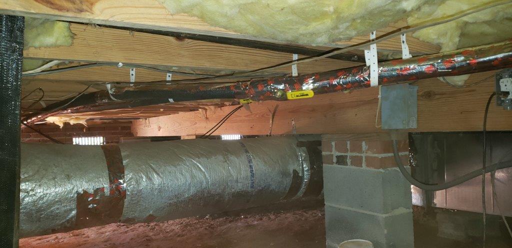

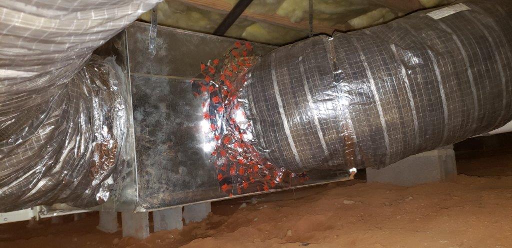

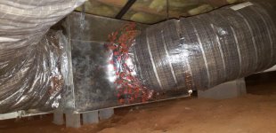

The last quote I got to just rip out my gas heat and install Geo unit only connecting duct work was 3K.
I had a local HVAC metal shop make the transition and a new plenum.
I did the whole thing myself for $350 that is new duct pieces and every screw and hangers... It was a lot of labor.

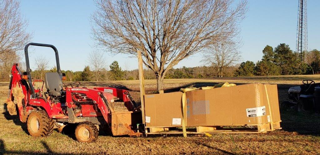

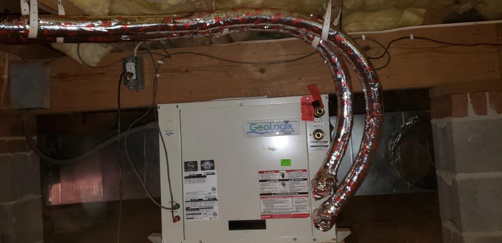

This is my tractor delivering the Geothermal unit to the crawl space. It is 369 pounds without pallet and packing.
I did enlist help from my son to get this thing under the crawl space.
We used 5 3" 3' long PVC pipe to put under it and roll it into place.

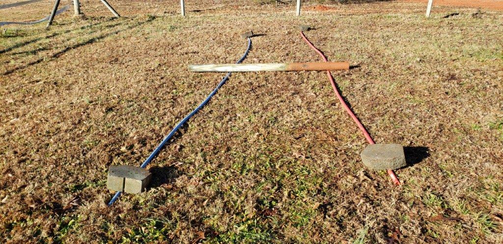

The 1" pex was rolled up and it was cold out so we let it out in the sun for a while this really helped.
t was all connected up and I tried to run it yesterday. I just would get communications error on the thermostat.
I double checked the thermostat wiring all good. I looked for loose wires and there were none. I read the whole manual and there was one board jumper out of place I turned that on and we were in business.
It ran all night heating last night and it worked great.
Being that we are in South Carolina we are now running AC EWT 50 degrees LWT 58 degrees nice cool air.
I still have a few things to finish up like run condensate line and reinsulate a couple pieces of duct work.
This week I will be getting some top soil to put over the trenches so some day we can have grass again.
I am very happy to have it up running.
Here it is installed.

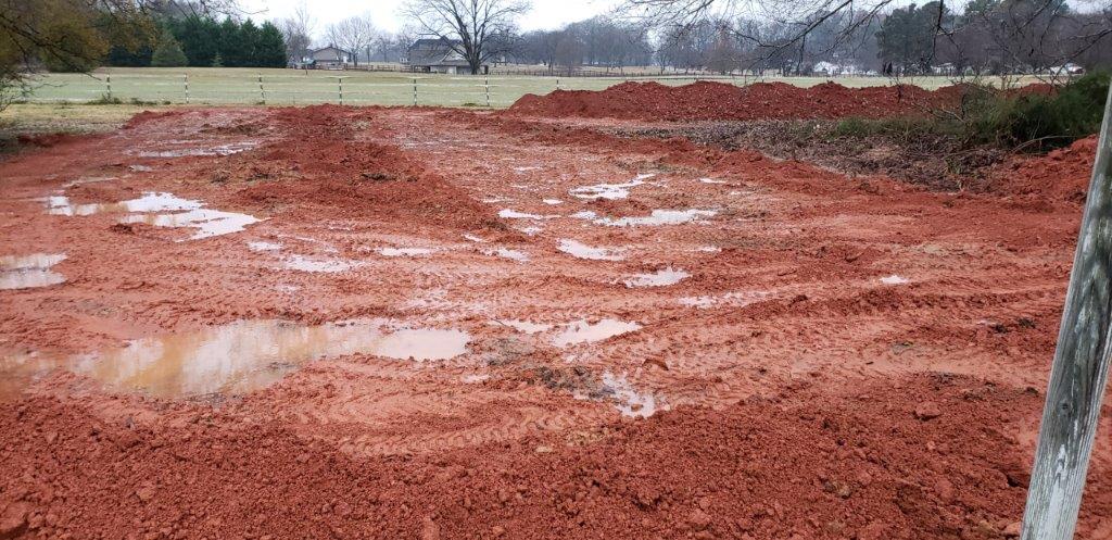

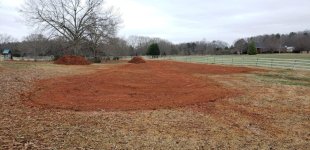

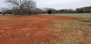

I have the trenches covered back up. I put the land planer to work.
I will get some top soil next if it dries out long enough to get it hulled in.
The two plies of red clay will be moved to the back of my property for a shooting range.
I will rent a dump trailer and use my tractor to load it and move it to the back of my property.

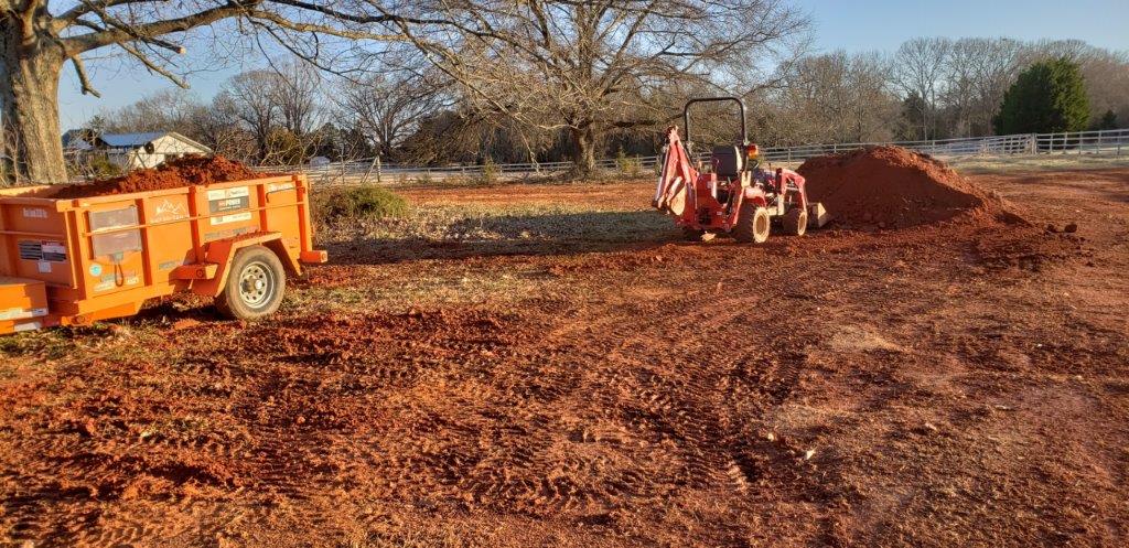

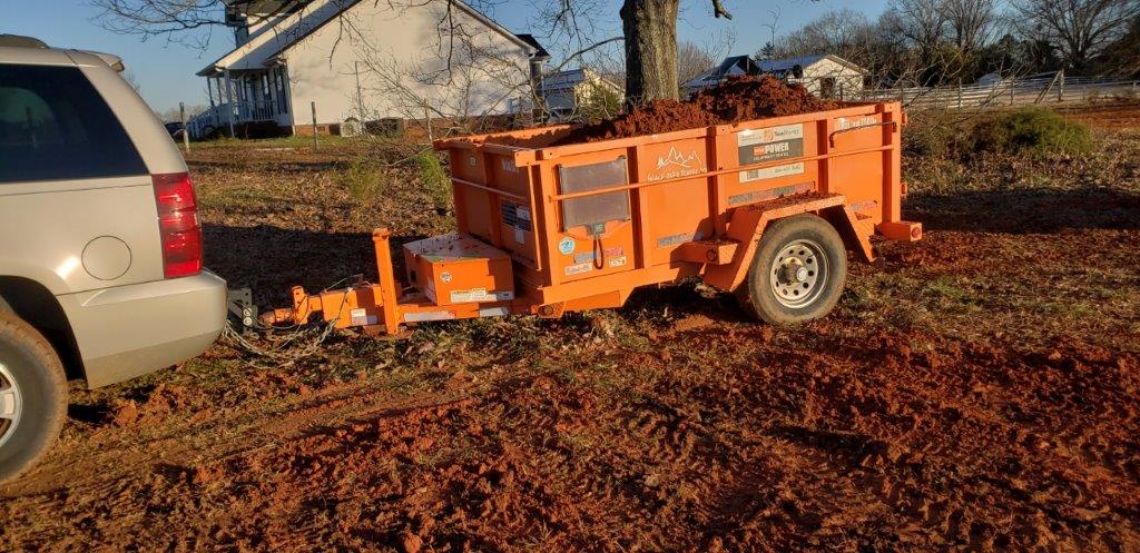

I had two piles of dirt that needed moved to my back pasture. I will be making a shooting range with this dirt.
I rented a dump trailer from Home Depot $115 for a day. I moved 23 loads or 69 cubic yards of dirt. I needed the whole 24 hours.
The dump trailer was pretty powerful it would dump with whatever I filled it up with.
I am now ready for my top soil hopefully I can get it this week.
   / DIY Digging trenches for Geothermal #110
Unless you had a compactor you'll probly want half of that dirt back to fix trench settling. Only needed to haul away the cubic yards of your piping.
Self contained dump trailers are very handy!!!
