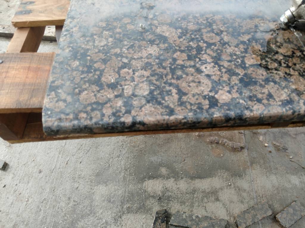

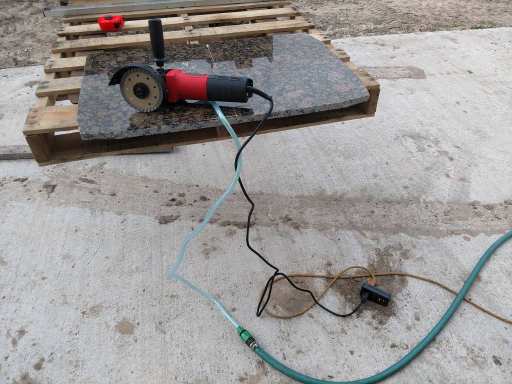

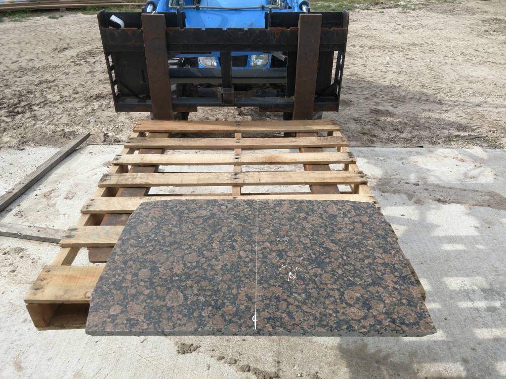

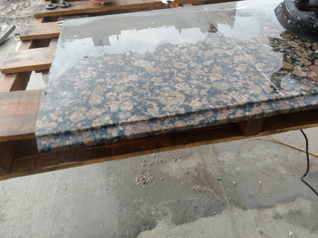

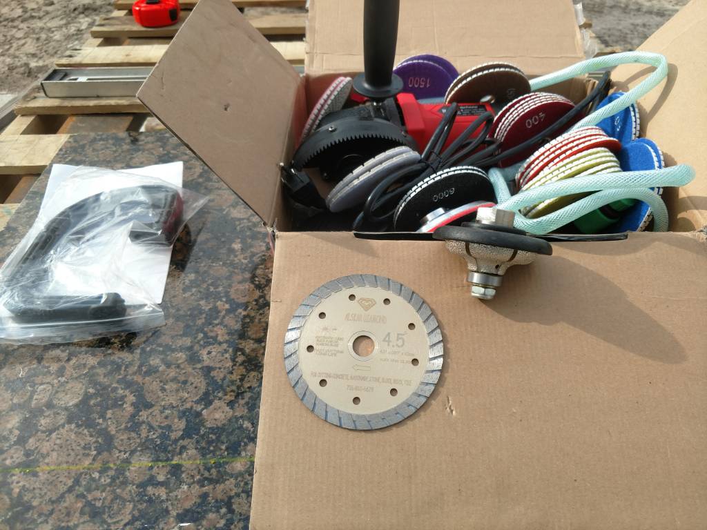

I'm going with it's possible to DIY this. Better tools would make the job easier and I would suggest learning with a round over or bullnose instead of an ogee but, there nothing overly complicated here. I still have some polishing to do but, if you can finish auto paint or furniture, it's essentially the same process.
Pictures:
1 - The scrap granite
2 - Oh, the smell of Mainland China!
3 - Wet/dry diamond wheel, I trickled water on from the hose, couldn't feed through the arbor as pictured. Don't plunge all the way through with your cut on the first pass, score it about 1/8" and go another 1/8" on each successive pass until you're all the way through, you have more control that way.
4 - Start of the ogee
5 - After a couple of hours. I've started with the 200 grit wheel, still have a little shaping left to finish out and polish. My cut wasn't as smooth as it could've been so I've got to clean up the edge some as I polish it. IMG_20190107_141812289.jpegIMG_20190107_144346203.jpegIMG_20190107_145126145.jpegIMG_20190107_151740480.jpegIMG_20190107_155911021.jpeg

That's coming along really nice. What tool did you use to create the ogee?
