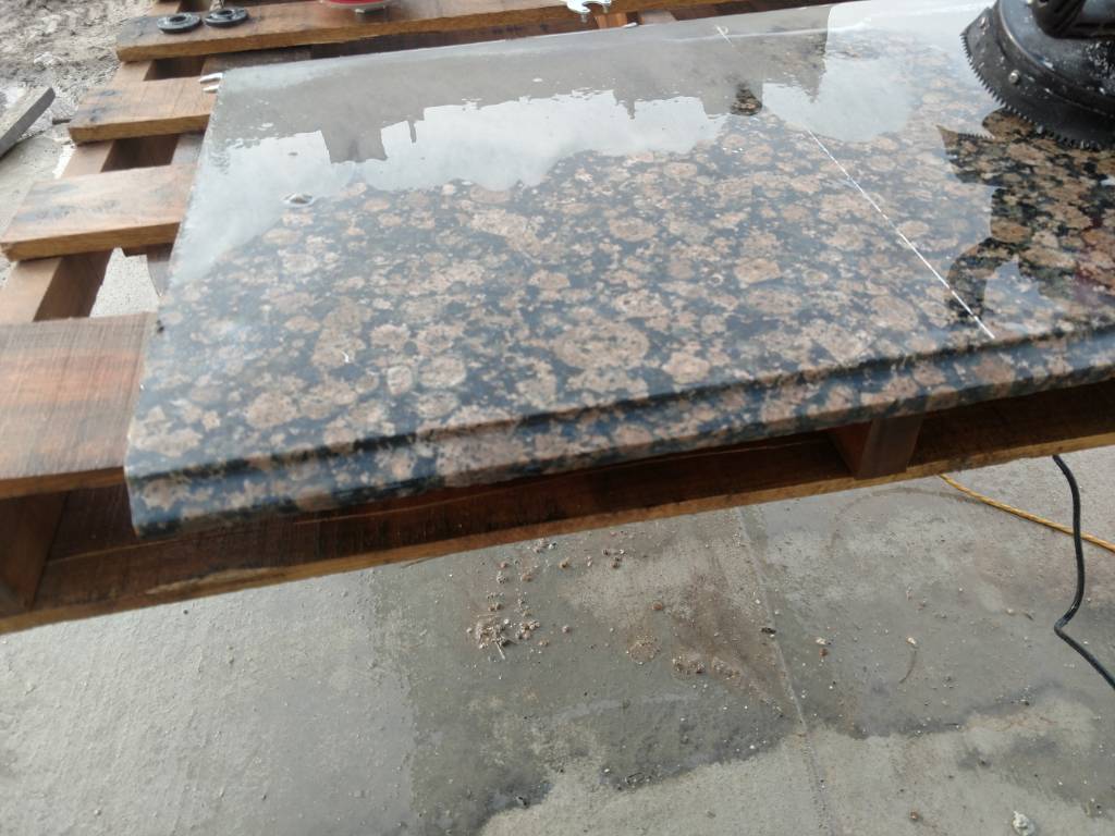

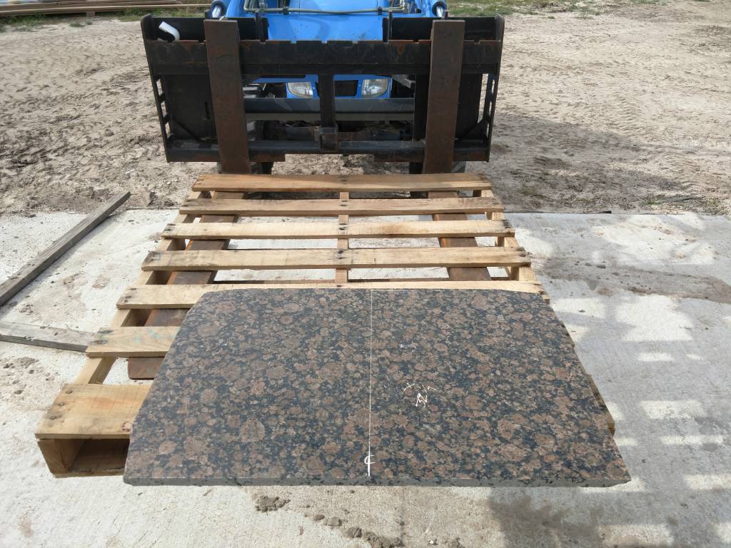

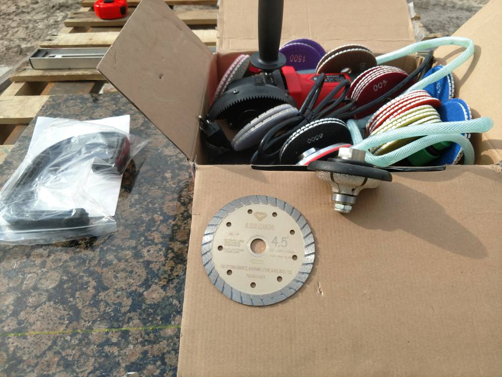

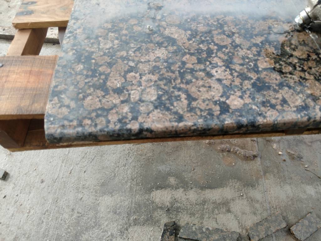

I'm going with it's possible to DIY this. Better tools would make the job easier and I would suggest learning with a round over or bullnose instead of an ogee but, there nothing overly complicated here. I still have some polishing to do but, if you can finish auto paint or furniture, it's essentially the same process.
Pictures:
1 - The scrap granite
2 - Oh, the smell of Mainland China!
3 - Wet/dry diamond wheel, I trickled water on from the hose, couldn't feed through the arbor as pictured. Don't plunge all the way through with your cut on the first pass, score it about 1/8" and go another 1/8" on each successive pass until you're all the way through, you have more control that way.
4 - Start of the ogee
5 - After a couple of hours. I've started with the 200 grit wheel, still have a little shaping left to finish out and polish. My cut wasn't as smooth as it could've been so I've got to clean up the edge some as I polish it.View attachment 586233View attachment 586234View attachment 586235View attachment 586236View attachment 586237

I marked the line with a straight edge and then cut it free hand. Since I used a grinder to cut it, I'm not sure how I'd use a guide.
I don't see any appreciable wear on the edge bit but, this is only a 32" piece of granite. Without having a lot of experience, all I can say right now is that I kept plenty of water flowing. With metal or tile cutting, heat kills the tools faster than anything else so I'm assuming the same holds true with stone.
