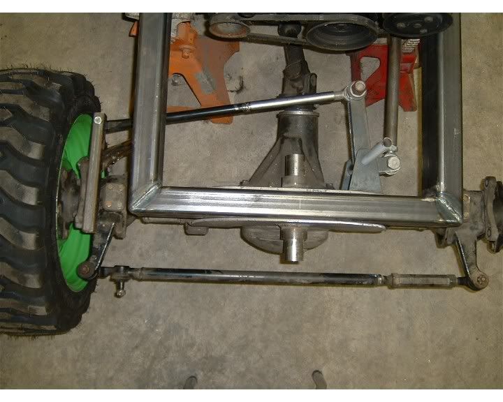

I've got the steering links mocked up. Please excuse my temporary tacked together tubes and rods and bolts:rolleyes:.

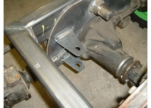

After dinking around on paper figuring lengths and angles I tack welded these brackets to the back of the front axle pivot plate.

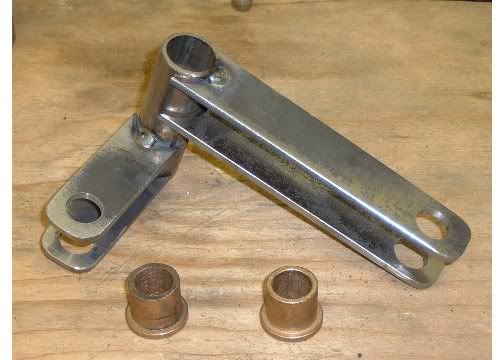

I then tacked up this bell crank. I found those bronze bushings at Lowes. I'm going to add a zerk to the pivot tube.

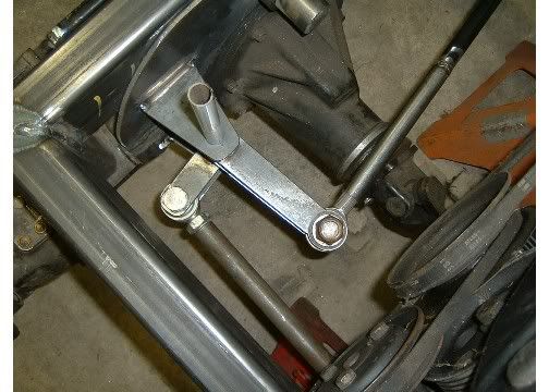

Here is the pic of the bell crank temporarly installed.
On the right is the rod coming from the steering box, the rod on top going left to my temporary steering arm, and the tie rod (bottom) connecting the spindels. It works well with 2.25 turns lock to lock! Yes I know the tire/wheel is on the wrong side:p !

bx23barry said:
Kool! :cool: Why didn't ya mount the box up front instead of the bell-crank arrangment? :confused:
Believe me I racked my brain trying to figure how to do that.
I would have had to design a complicated set of shafts and universal joints to get over/around the engine and in the end all that stuff would have been in the way anytime I wanted to work on the engine.
Thats my story and I'm stickin to it!:D
It would have been much easier to use a steering cylinder hard mounted to the frame and just run hyd lines from the steering column. More $$, but easier!
