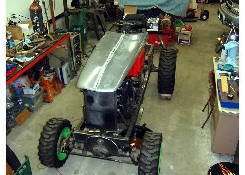

Wow!! You just went from amazing builder to super-hero-thinking-outside-the-box-amazing-master-fabricator. That is so simple and so perfect. It's one of those things that half of us are sitting here wondering, "Why didn't I ever think of that?"
That's an impressive straight cut, too.
I second that!! Who would have thought to use a hood for a hood?

Thanks Guys!
I had about an 1/8" gap in the center area after cutting, but yeah it was a pretty straight cut.

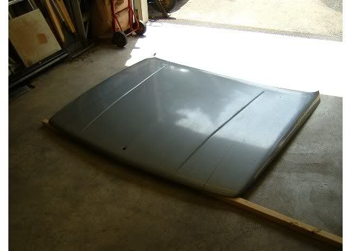

When I was at the wrecking yard I was getting worried because all the hoods were flat. I was about 1/2 way around the yard when I found the Park Avenue which had the rolled sides like I needed. There were a few Saab's that had a nice edge on them, but were too short for my needs.

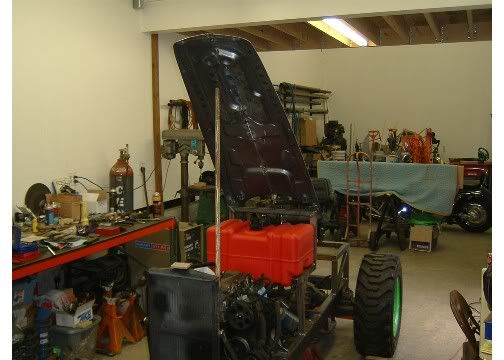

Got some work done on the fuel tank and steering column mounts.
One of the things that I didn't like on some tractors was having to fuel them up high, through the hood. While comparing tractors, that became one of those things that stood out to me. Mine has two small tanks on either side of the transmission, under my floor boards. I can rest a five gallon container on the front tire and tilt it over to my fuel tank, which is at the corner of my floor board. If you have a fuel pump, then it's not an issue. If it's too late, that's that, but if not, you might consider swapping it to under your seat if there's no room under the floor boards.
It's really coming together nicely. The hood is brilliant.
Eddie

Went to the wrecking yard today and found a canadate for a tractor hood. Its from a Park Avenue. After some carefull measuring its in two pieces.
Here it is tacked together and sitting on the tractor. I need to finish welding and add some hinges.

Good point Eddie, I was thinking what would I rather have, hot hyd oil and a battery over my feet or a diesel tank. Did not think about having to heft the fuel jug up there, but alas the tank wont fit under the seat!

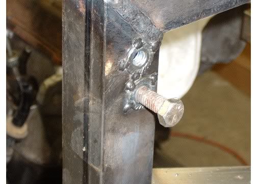

I thought I'd show you my poor mans nutserts. Here the hood hinges are preped. Flange nut in the hole.
I use a bolt to hold the nut while tacking, then weld all around. Then grind flat. These sit a little proud.
I lightly bolt the hinges in place and weld to the hood.

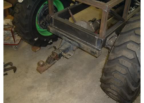

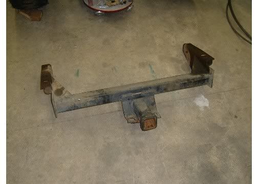

Went to my favorit pull a part and got a hitch for $8.50! A little triming and I've got a hitch/draw bar. I'm going to add some plates to the end tubes, triangulating them to the frame. My plan is to add thick tabs under the cross tube for my lower 3 point attachment arms.
