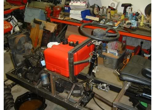

Got some work done on the fuel tank and steering column mounts.
I used some 1.5" square tubing and 1" for the steering column.

Realy nice work, great looking welds.
How do you cut your steel?
Thanks,
Joel
   / DIY Home built compact tractor
#304
Thanks,
Joel
Thanks,
I use a chop saw and a small vert/horz band saw.
