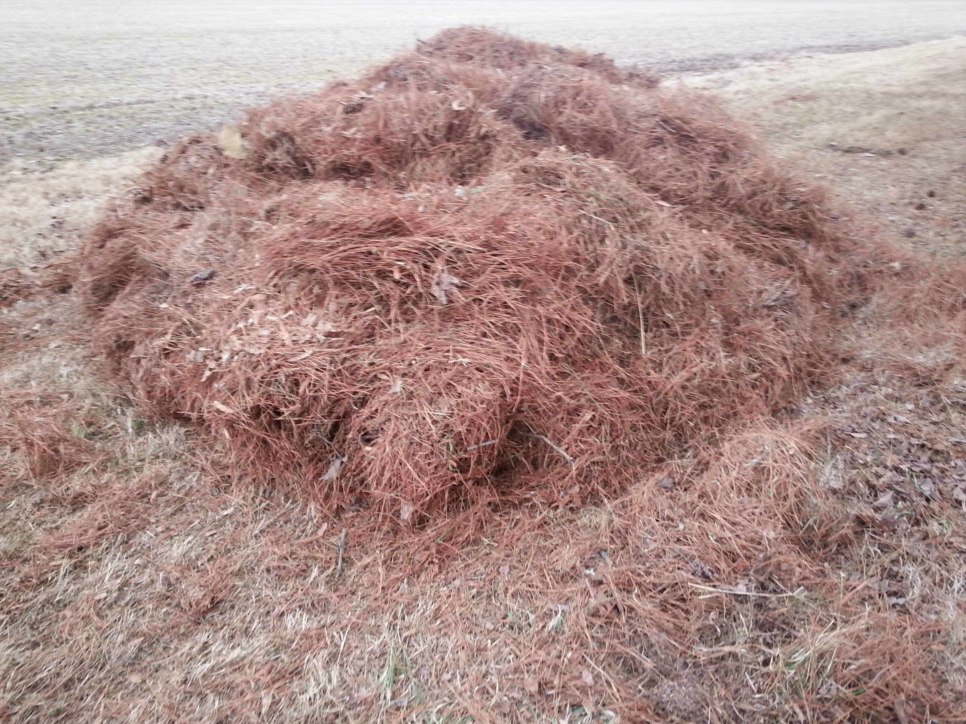

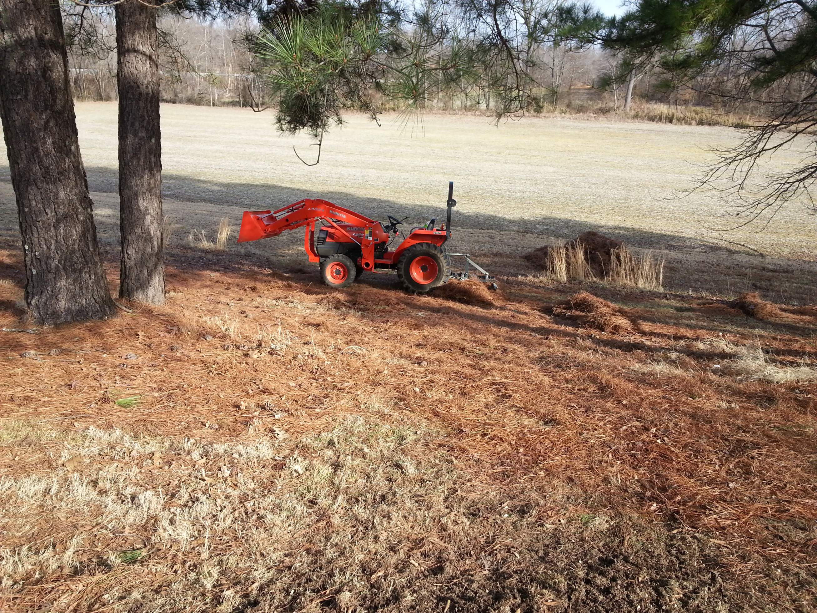

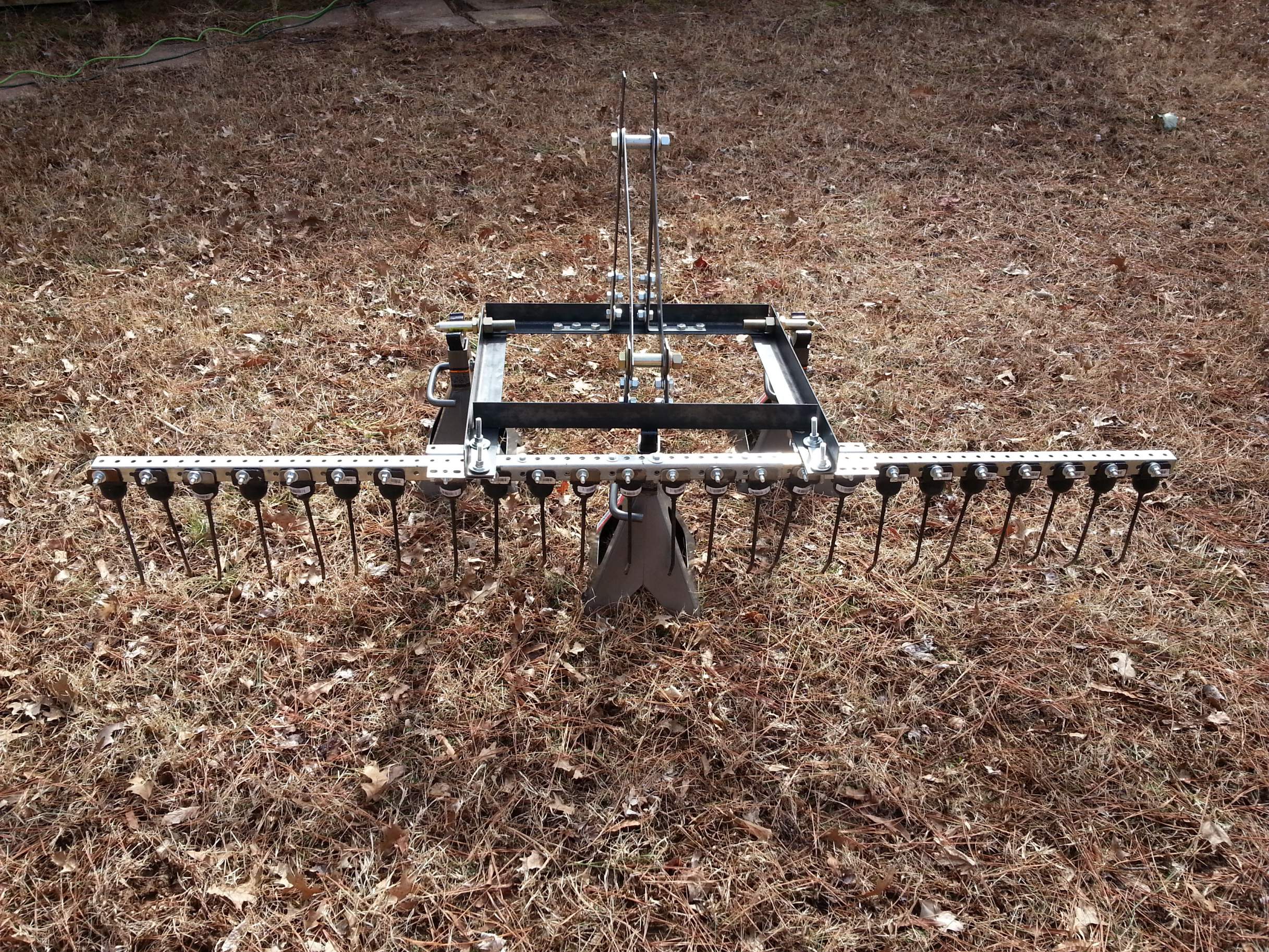

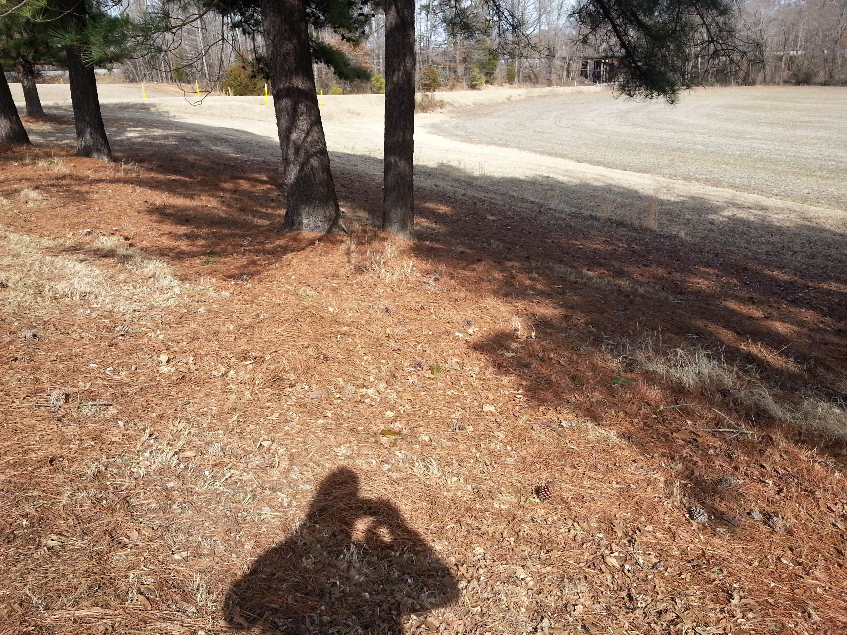

Here's a thread on something I built. It's titled "Good Landscape Rake", but its more of a pine needle rake and I just learned a dethatcher of sorts. But, not welds, it was all cut and bolted together from stuff bought at Tractor Supply and Lowes.
http://www.tractorbynet.com/forums/build-yourself/300969-good-landscape-rake-cheap-part.html
Here's the meat of it:
I've steadily worked, weather permitting, on the mods for my yard/pine needle rake. I added tines to get the spacing to every 3 inches and built a 3pt hitch so I could raise it higher to get it out of the pile of needles I just raked.
1. View attachment 361686 2. View attachment 361687 3. View attachment 361688 4. View attachment 361689 5. View attachment 361690 6. View attachment 361691 7. View attachment 361694
8. View attachment 361696 9. View attachment 361697 10. View attachment 361698
1., 2., & 3. 3pt hitch I made
4. & 5. rake on tractor
6. &. 7. before raking
8. some raking done
9. after raking
10. pile of pine needles 10ft in diameter and 3ft high. About halfway done on this side of house. I have a pile similar in size on the other side of the house.[/QUOTE
