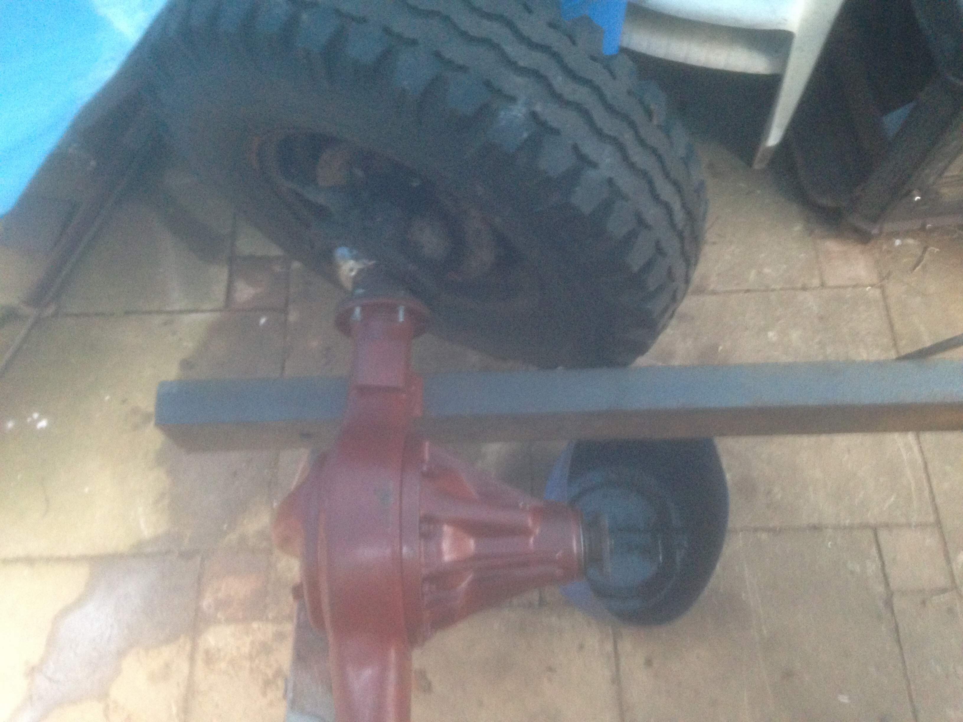

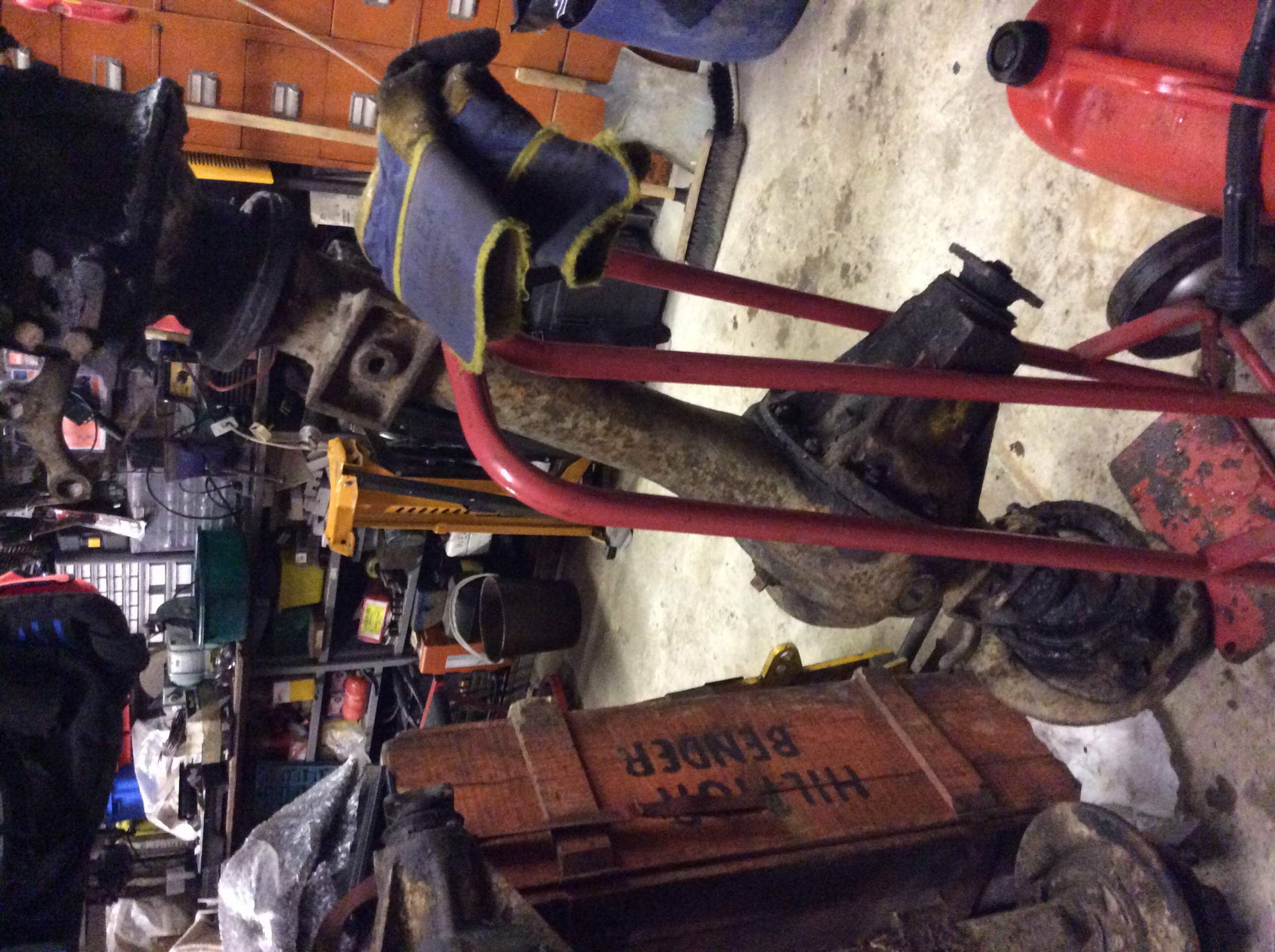

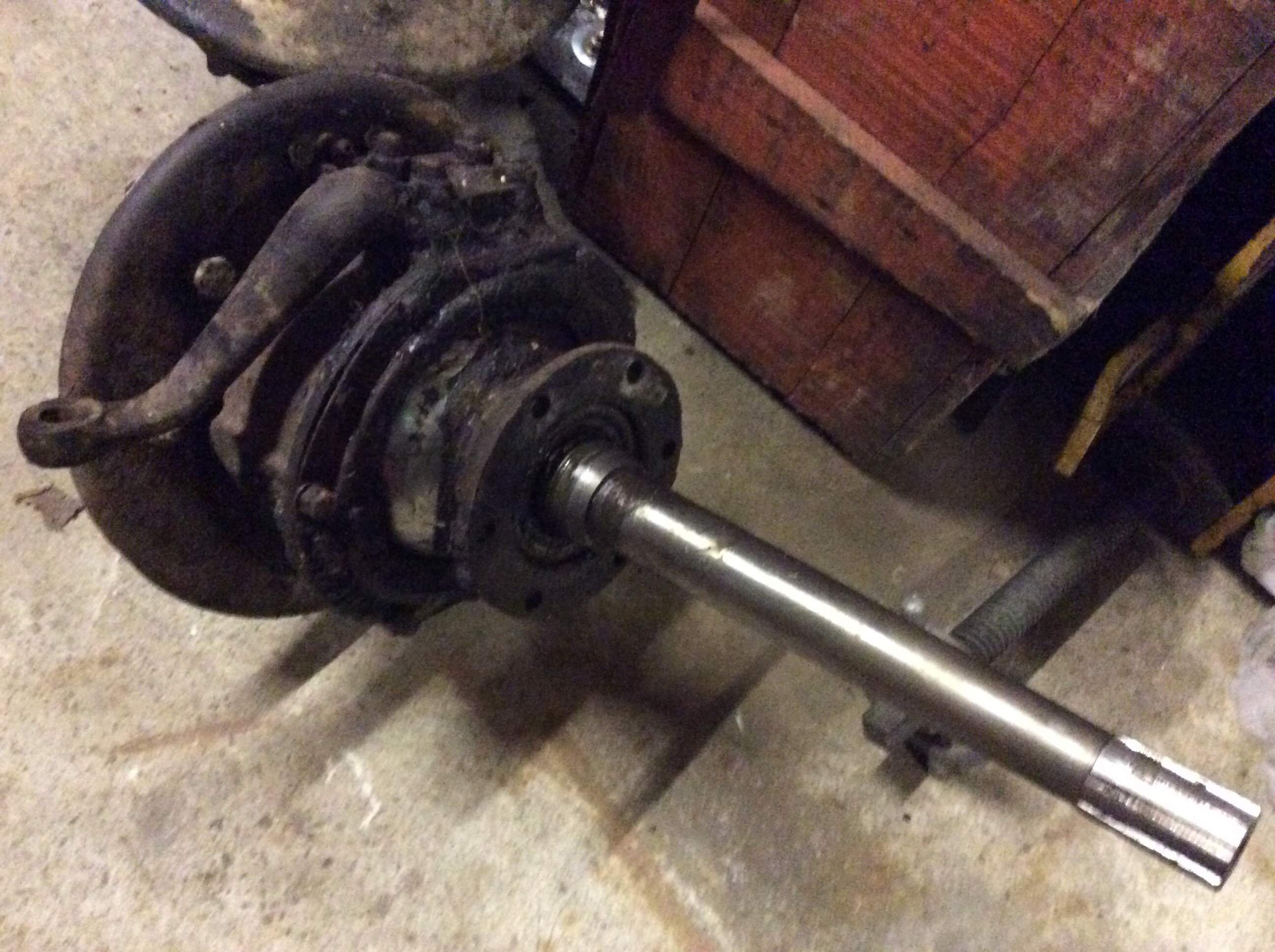

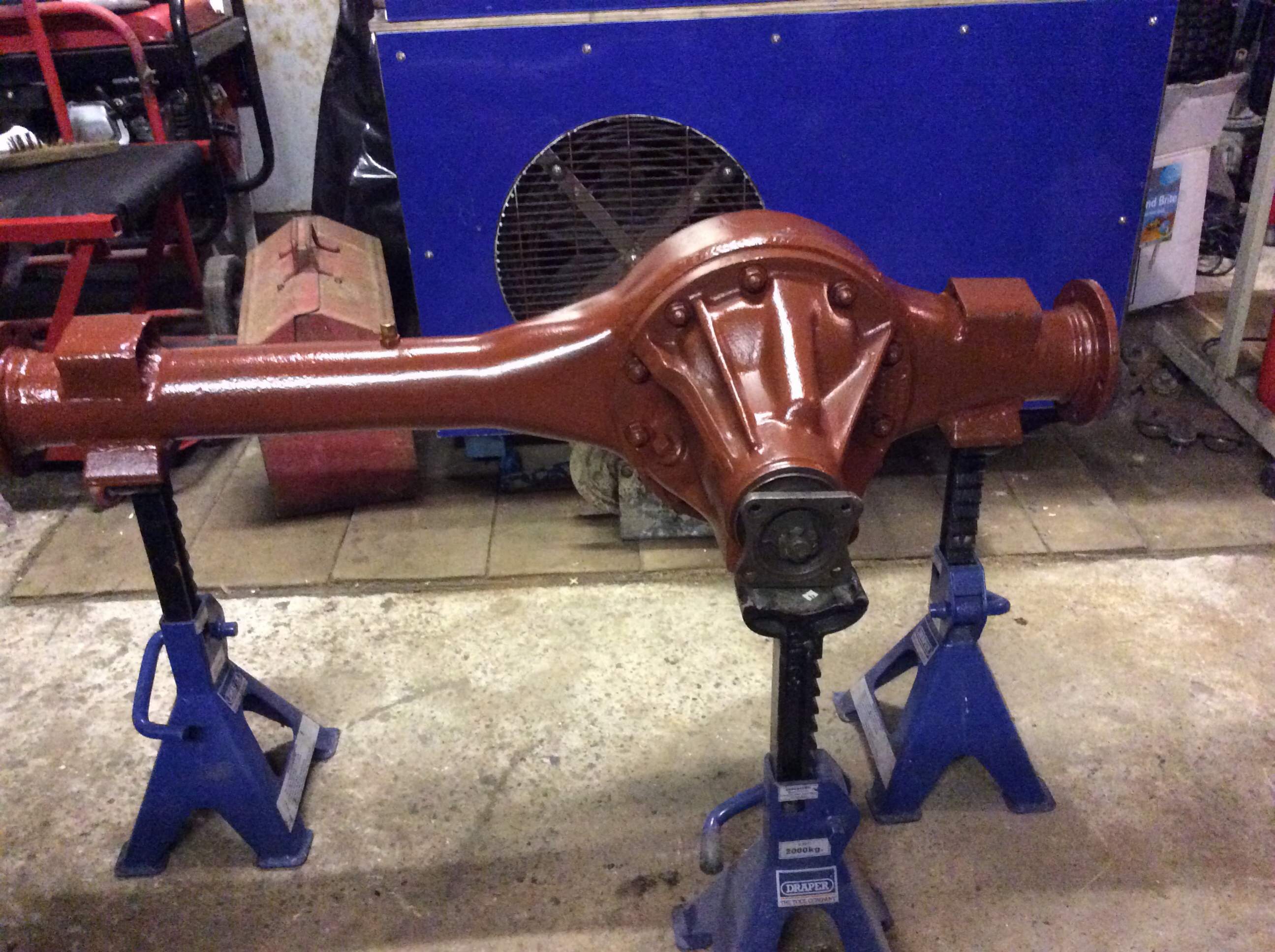

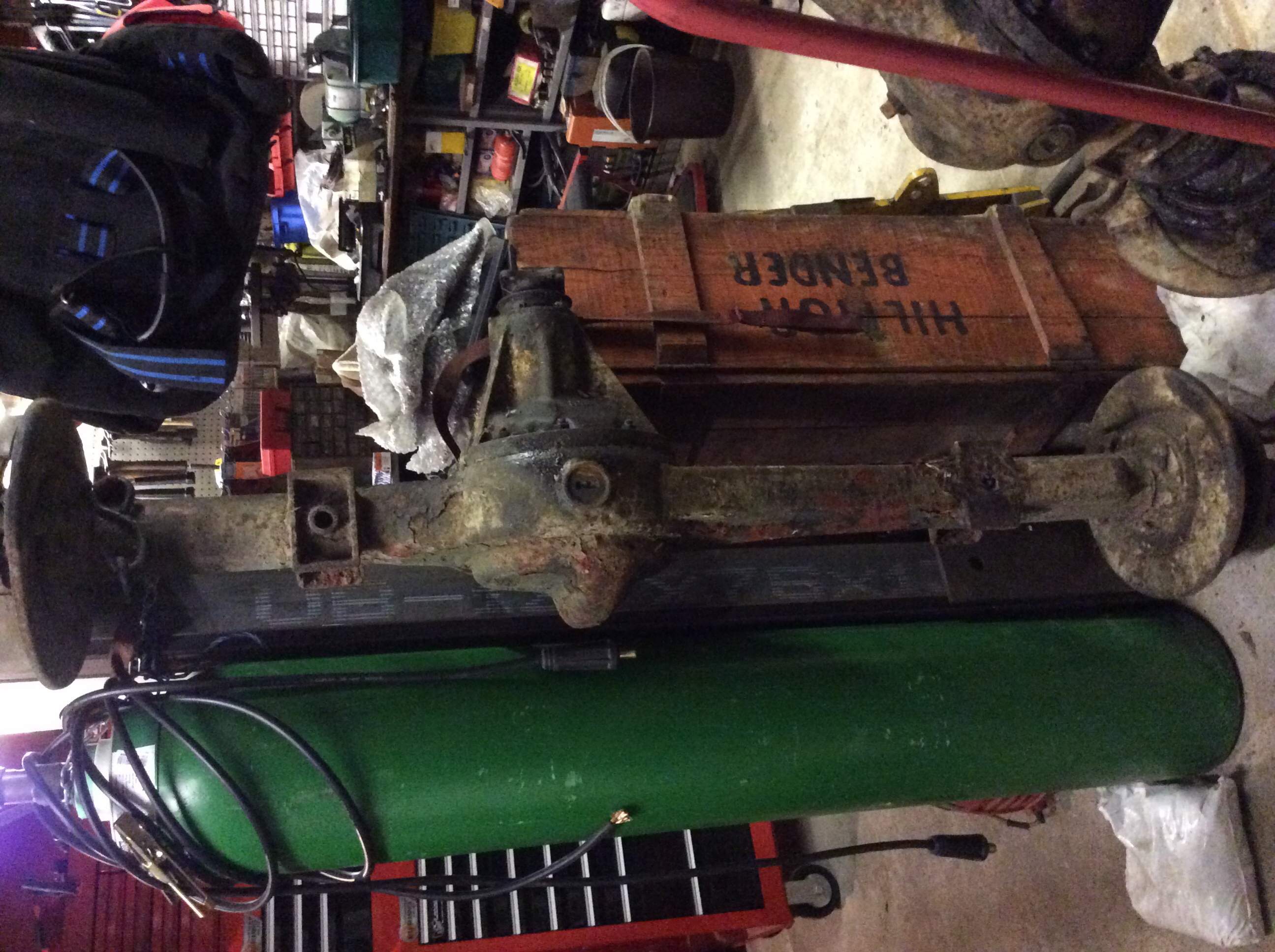

Strip and clean the axles which will be cut and narrowed.
No plans or drawings, not even a sketch just going to make it up with what falls to hand.

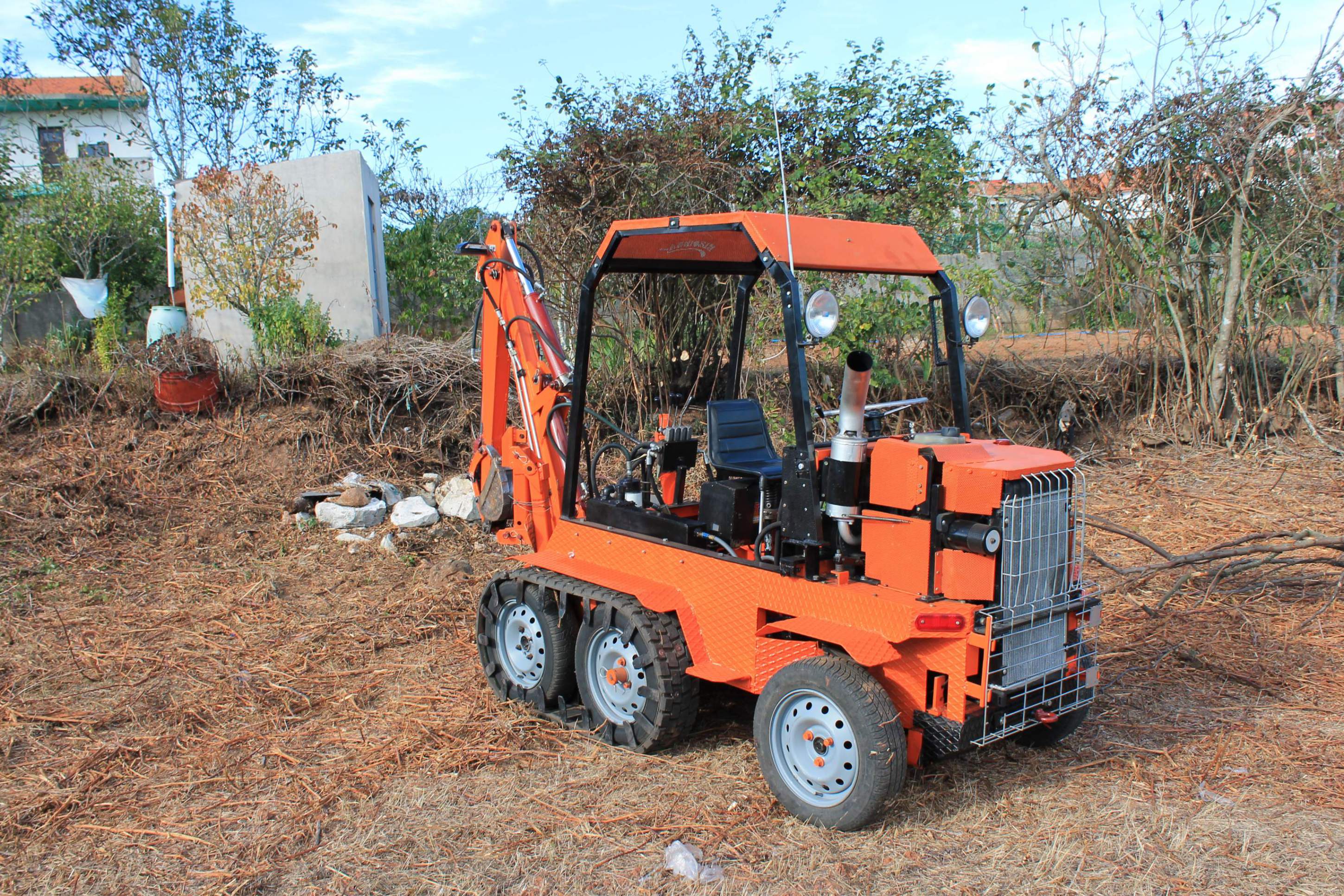

Here is mine I built from scrap:
I started building it with my dad with 10 years old and finished it with 18 years old. So don't worry about time as long as you get it running :)

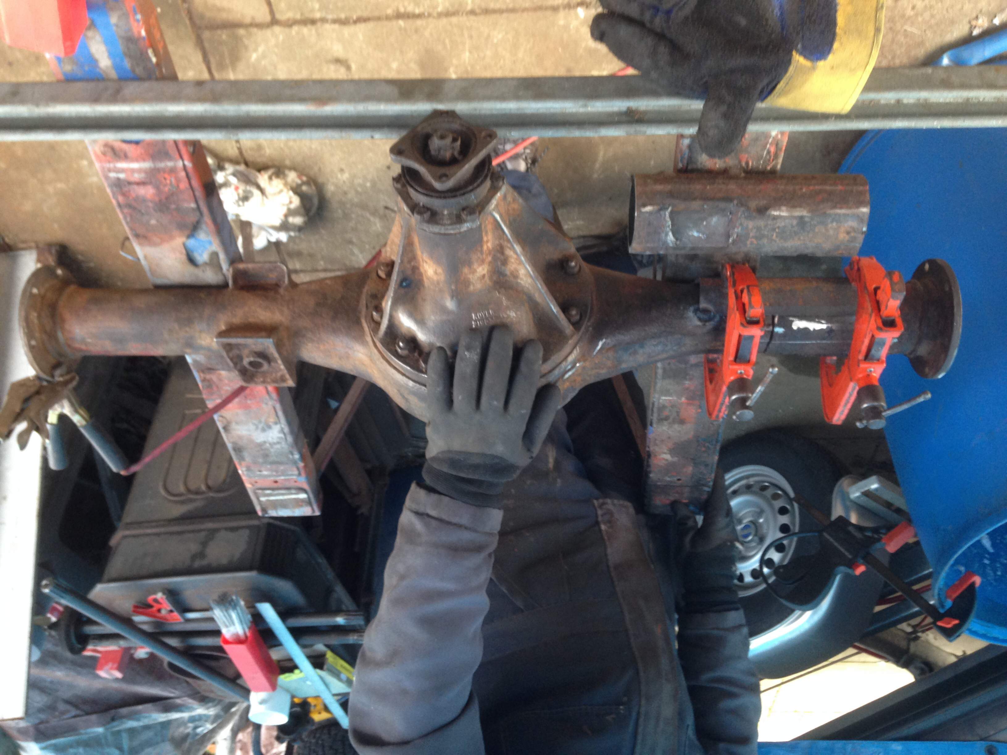

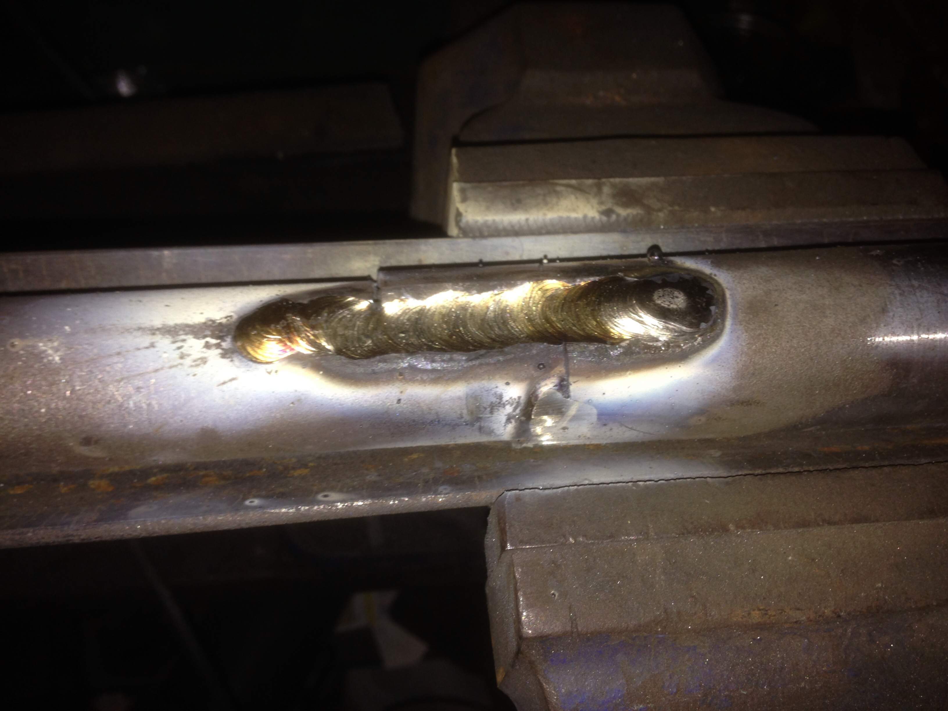

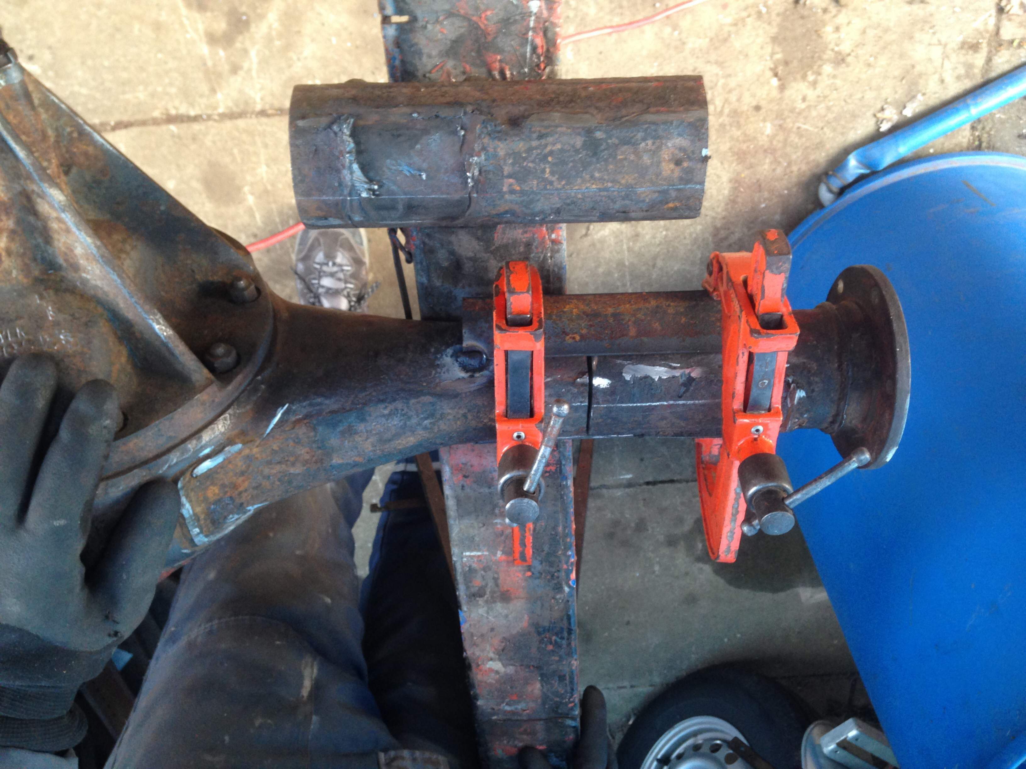

I agree two front axles would be great for manoeuvrability or even an articulated chassis steer but I'm happy to keep this simple and run with what I have to hand. Here's the axles being narrowed.

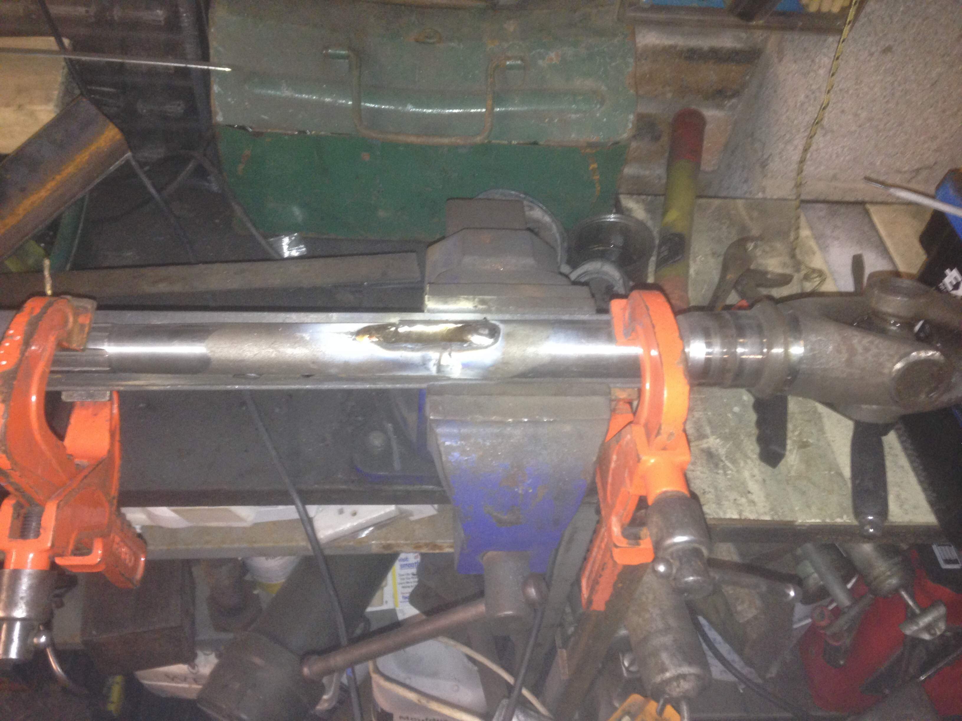

I've cut 8 5/8" out of the long side of the rear axle to match the short side. I can use another short half shaft here. The front axle is offset differently so I've cut and welded the long halfshaft to keep the overall widths the same at about 4ft.
PTSG your digger looks awesome! So many questions... Do you have a build thread somewhere or link to more pictures?
/ DIY Mini Digger #5
Ask whatever you need to ask! :) I don't have a build thread but I can post whatever picture you need here, if you don't mind.

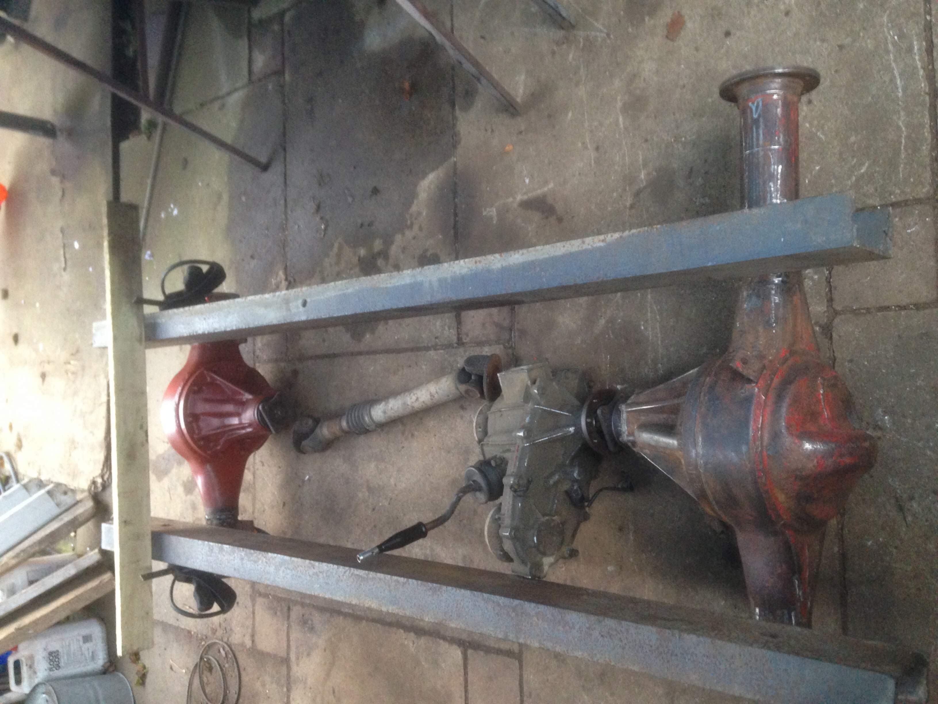

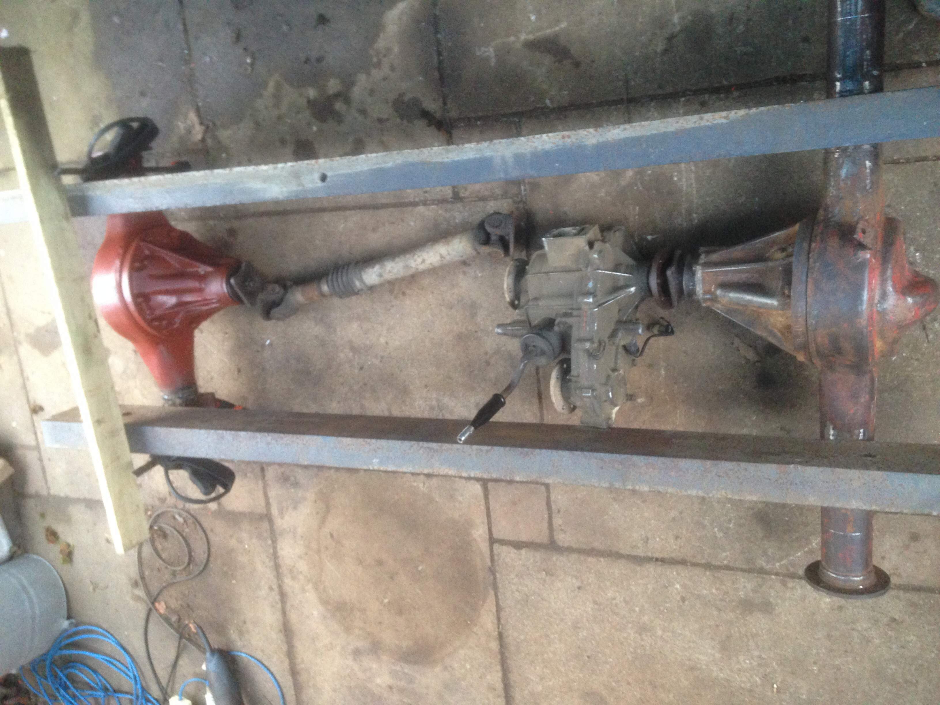

Chassis layout with narrowed Land Rover S2 axles, Suzuki transfer box and a Range Rover prop shaft.
The 6ft steel channels are 5" deep and fairly heavy so plenty strong enough for this job. The wheel/tyre on full lock has determined the width of the chassis rails.

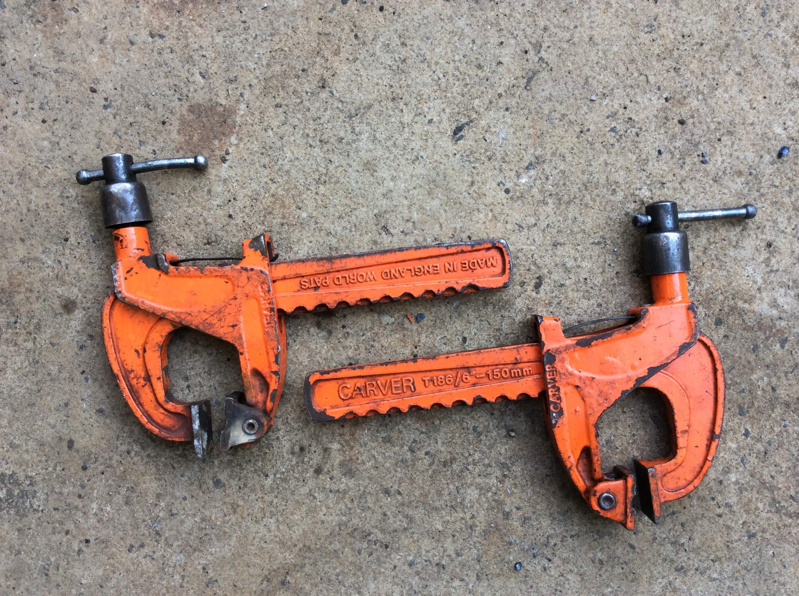

I've never seen heavy-duty clamps like those in your axle shortening photos. They look much more rigid than C-clamps.
If you tap your keyboard space bar after each photo attachment, they will be easier to see and select.
Bruce
/ DIY Mini Digger
Bruce
They are Carver Rack clamps made in the UK specifically for welding and fabrication. The clamp thread is shielded to avoid spatter, best clamps around but expensive. I'm a time served sheet metal worker but have been off the tools for 20 odd years.

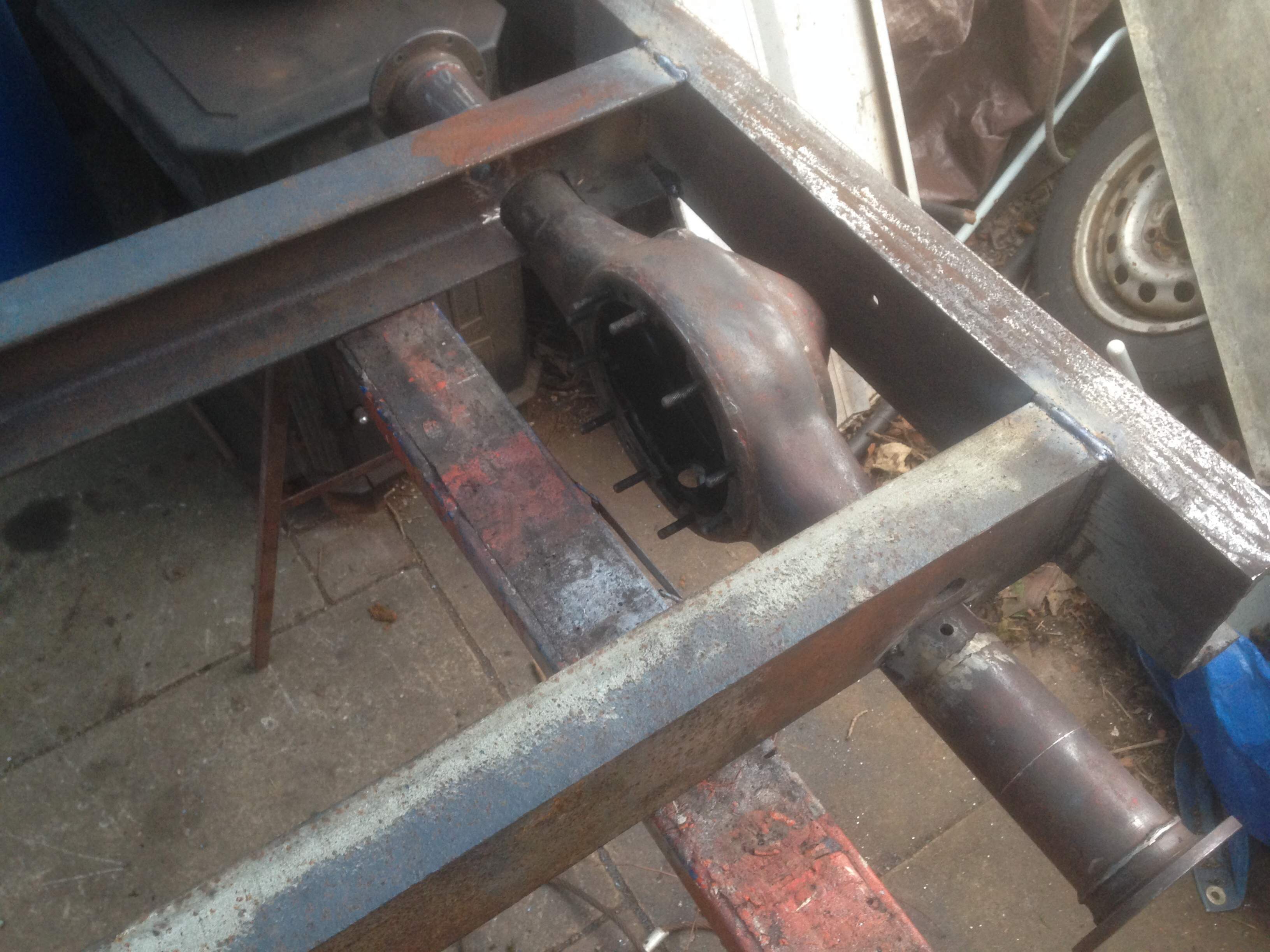

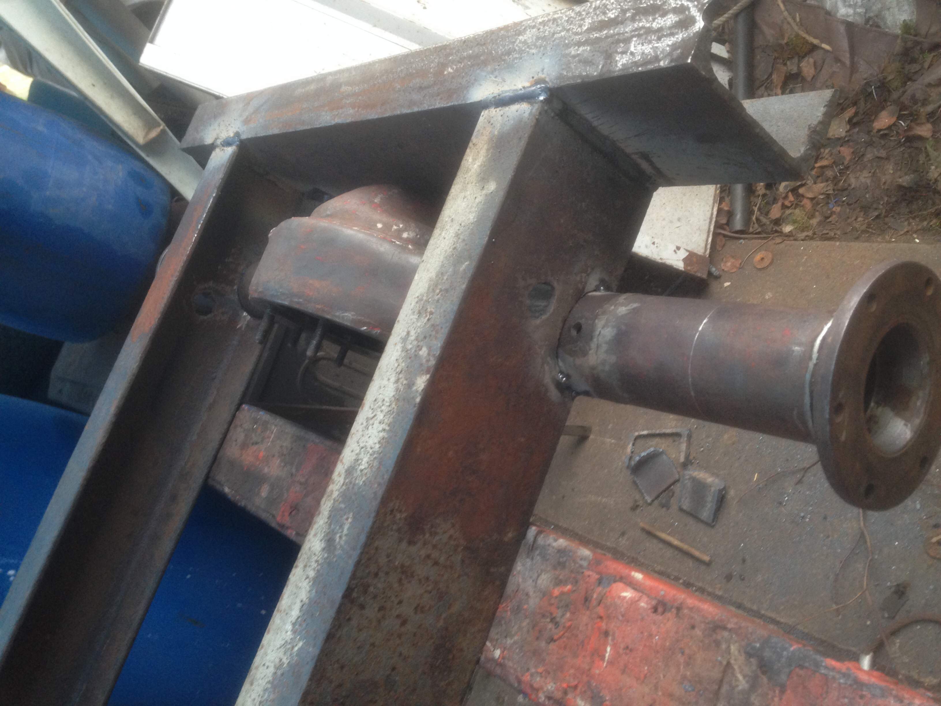

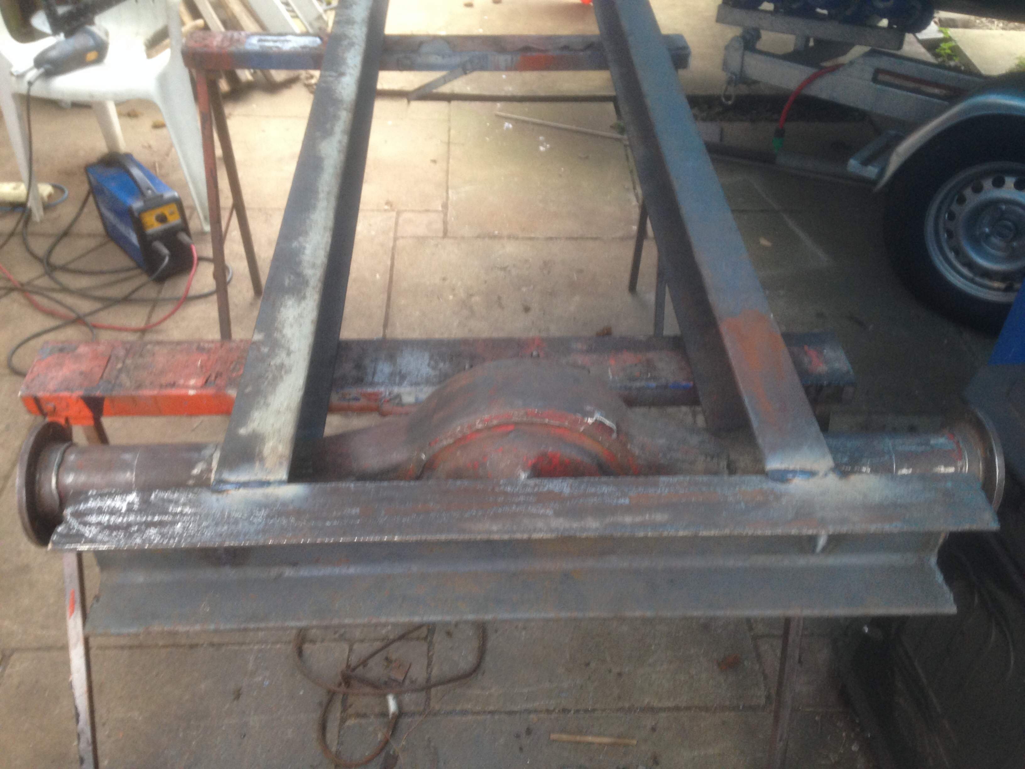

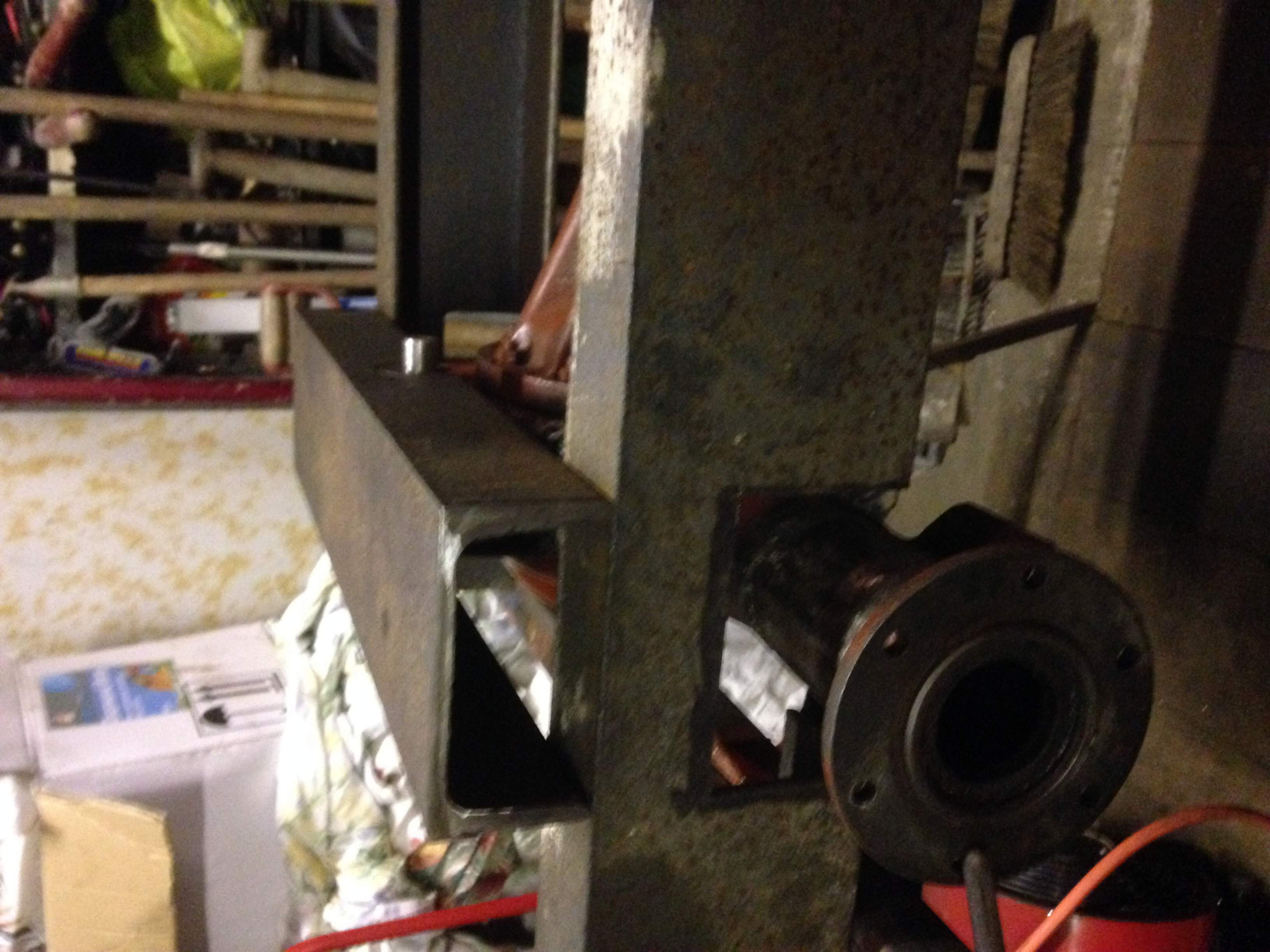

A few more pic's, rear axle tacked in place and rear cross member welded
Need to figure out the front crossmember and axle pivot. The chassis rails at the front are spaced with a temporary brace.

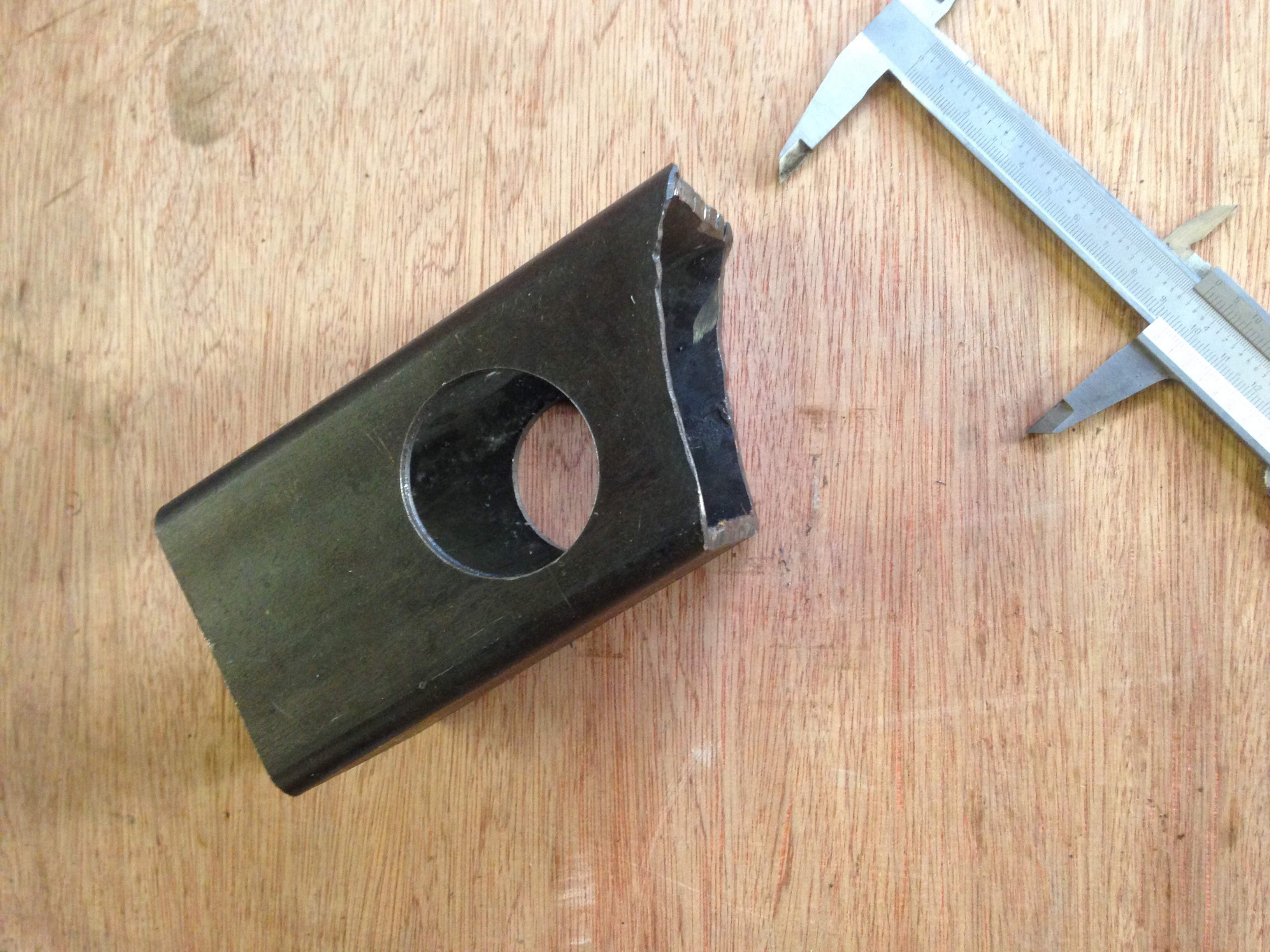

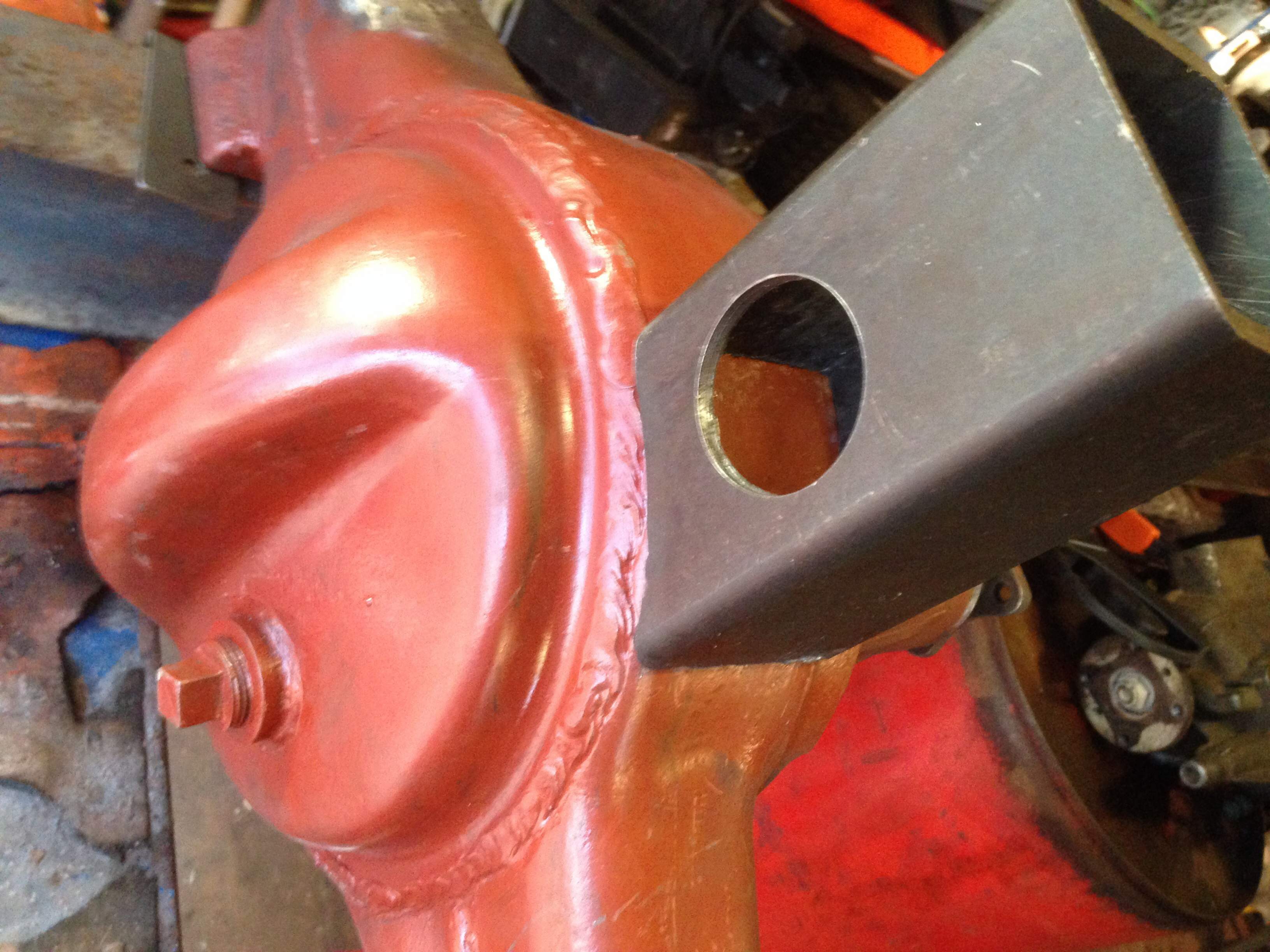

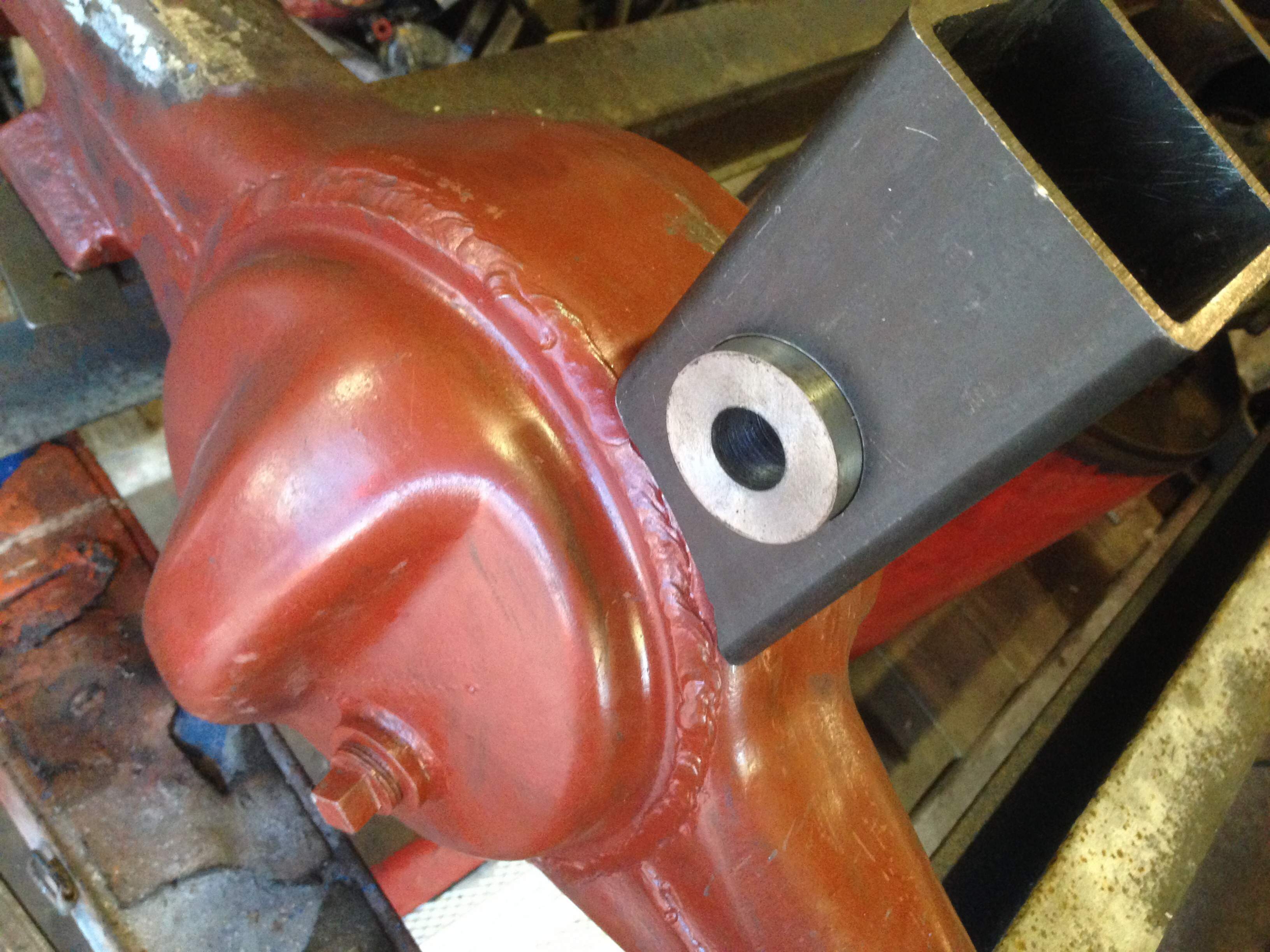

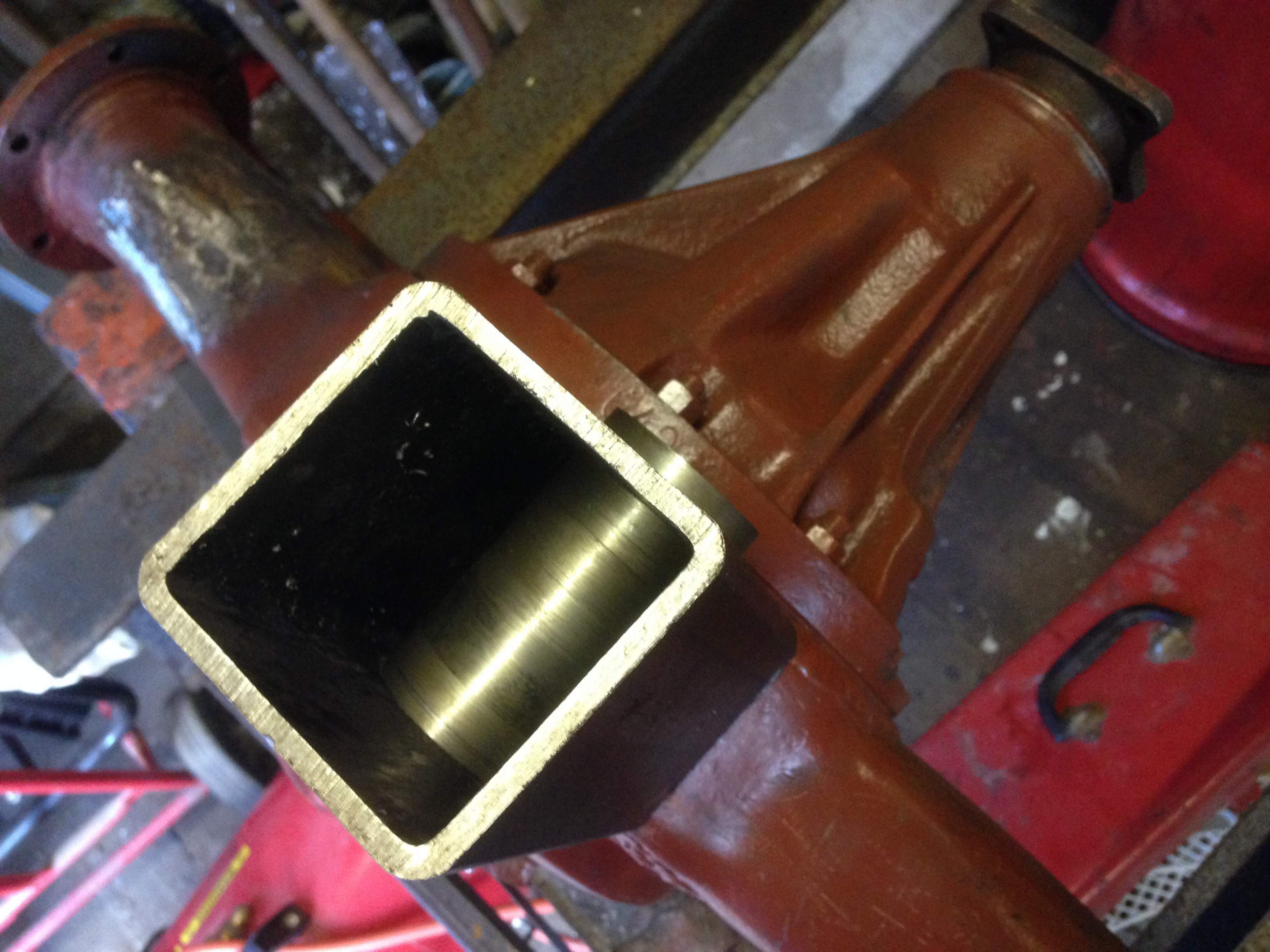

Front axle pivot, the diff housing is still slightly off-set so I've shaped the end of a piece of 4" x 1/4" box section to fit the contour of the casing. I have some 2" round bar that I can turn bushes from for all the pivot points and some EN8 bar for pins. Might need some radius arms but will see how it looks when it's rolling.
I will cut the box section down, radius the top and weld it in place on top of the axle casing.

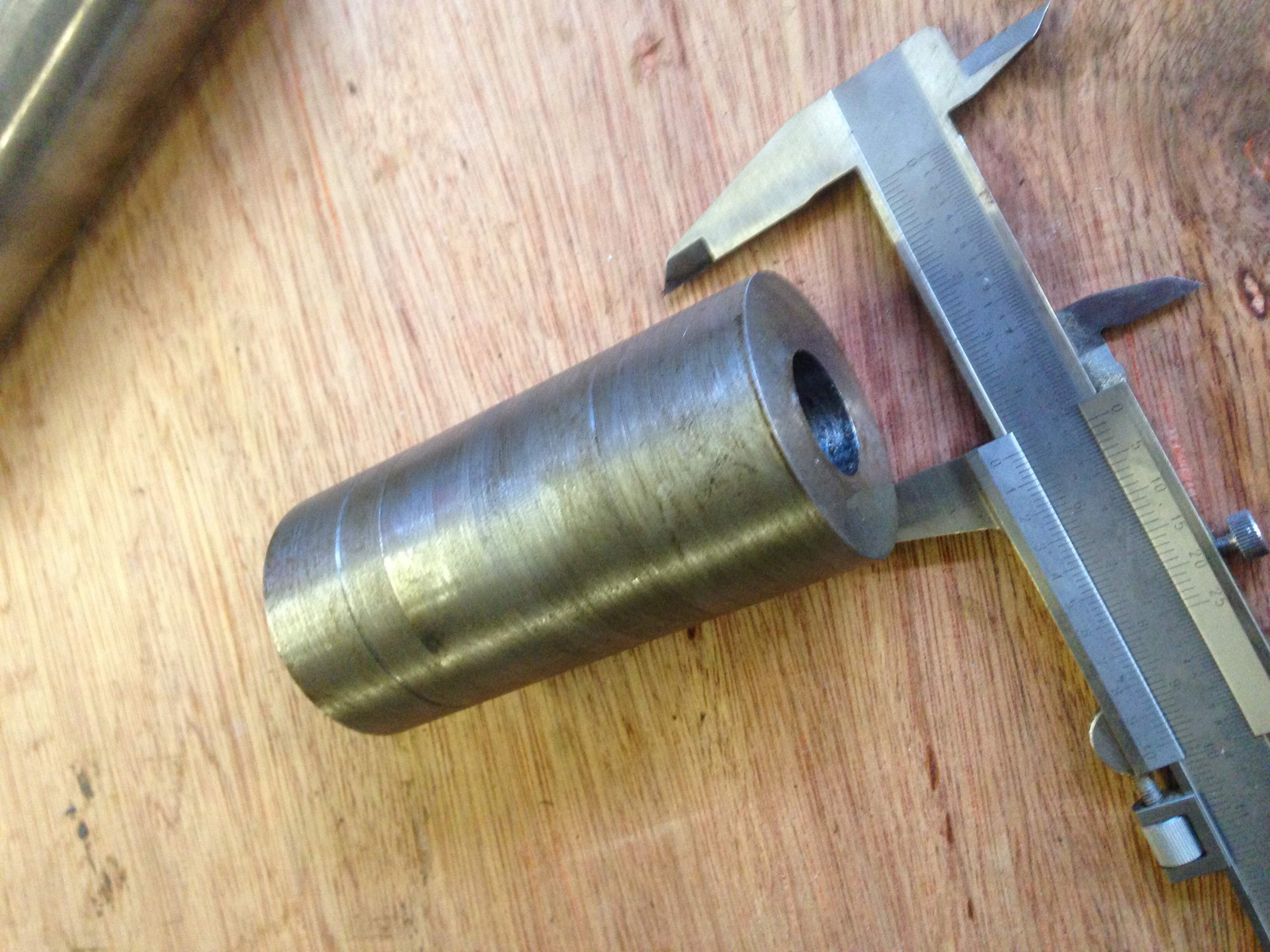

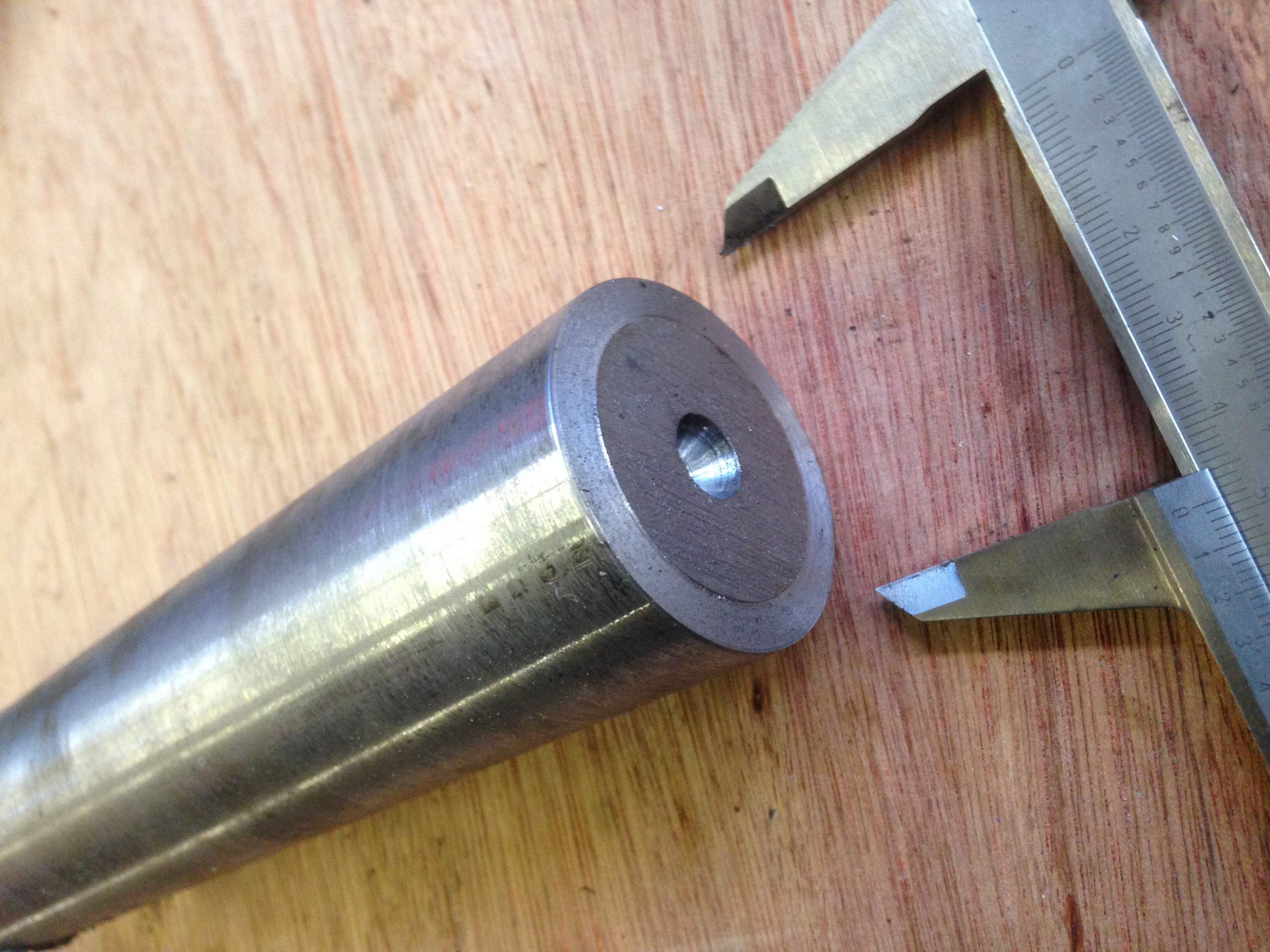

Pivot bush cut to length, pilot bored ready to be test fitted.
I will bore it out and ream it to suit a 30mm EN8 pin once I have made the cross member and support bushes.

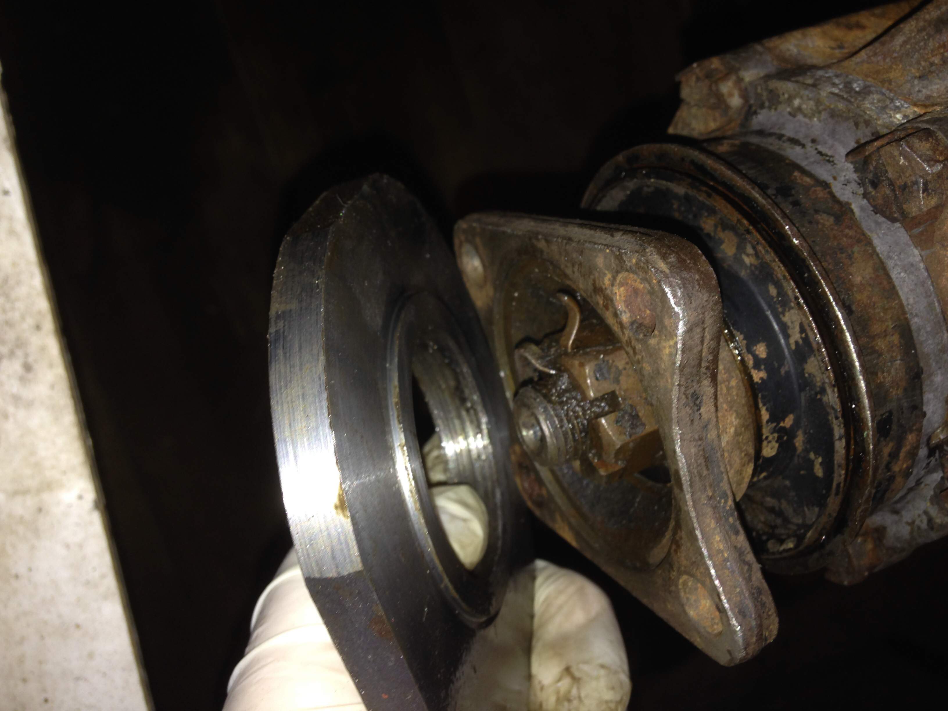

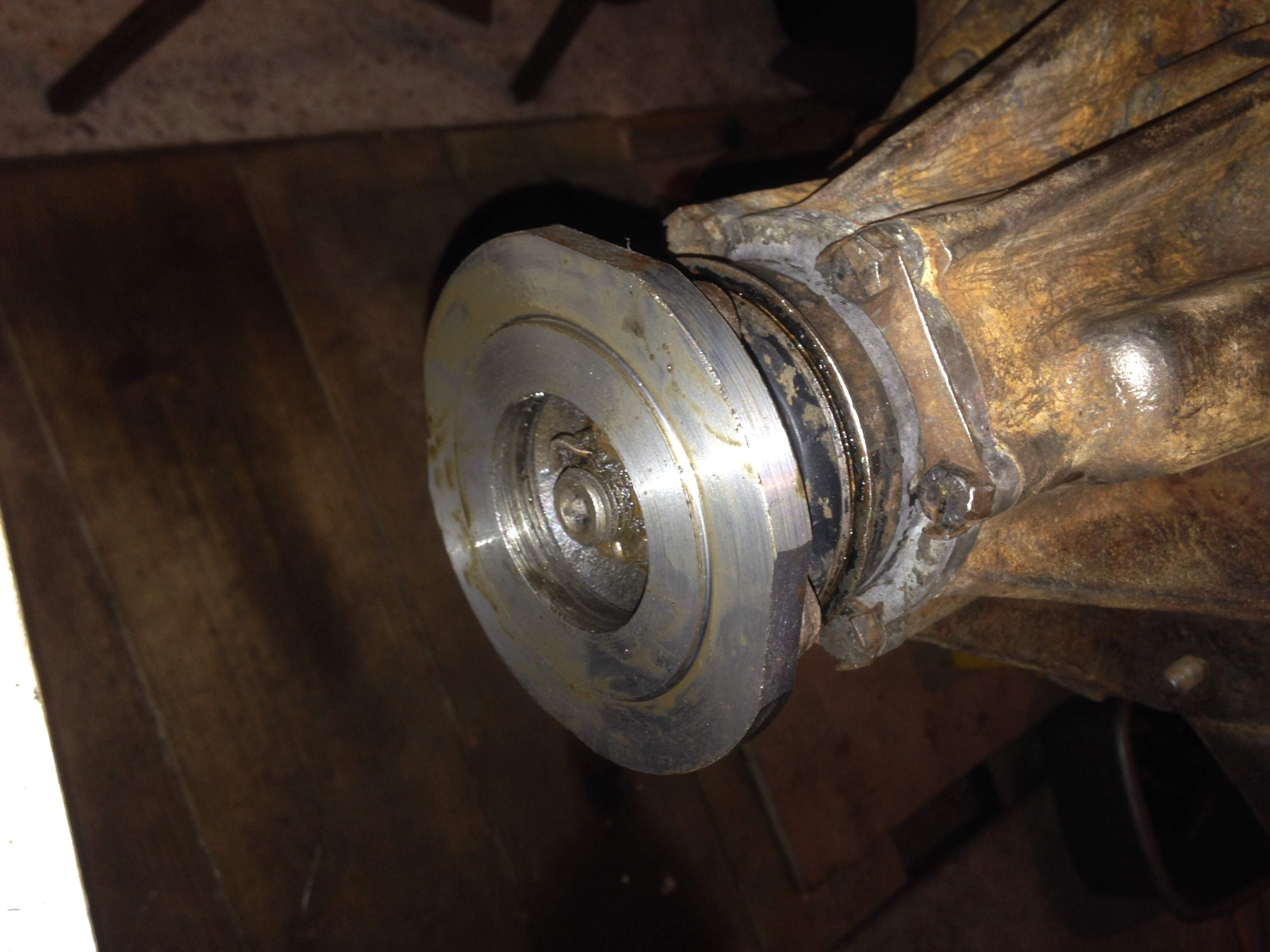

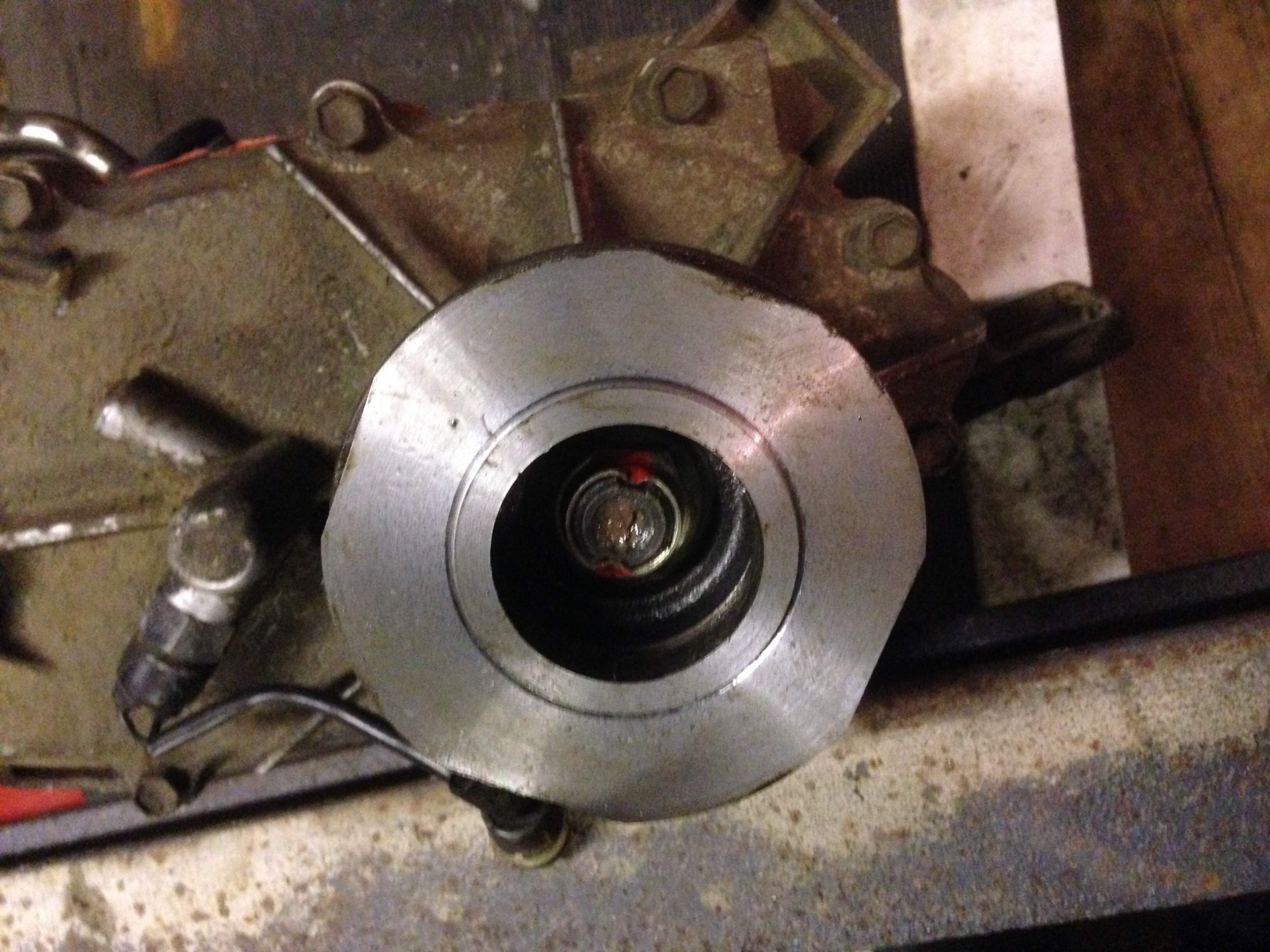

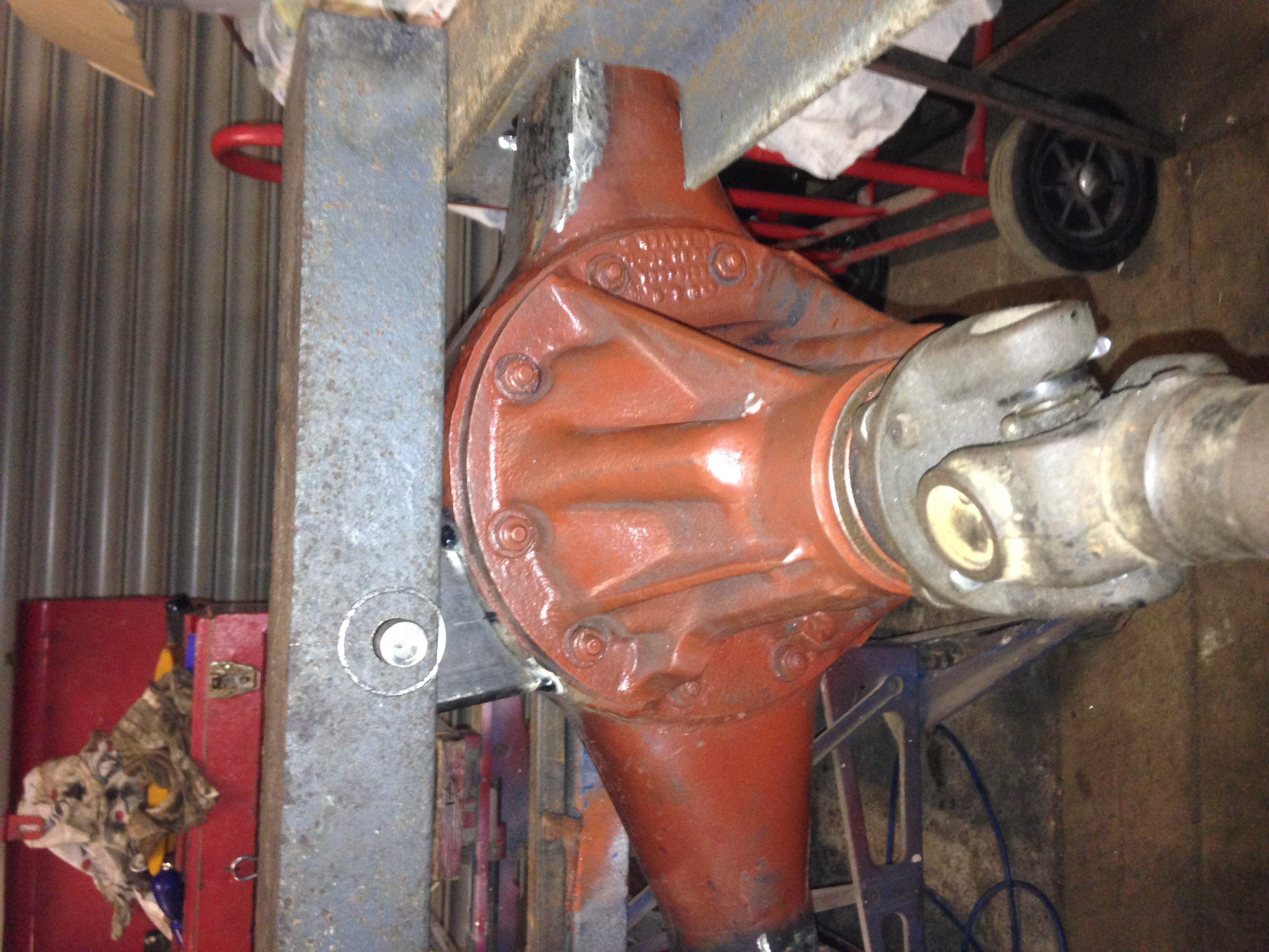

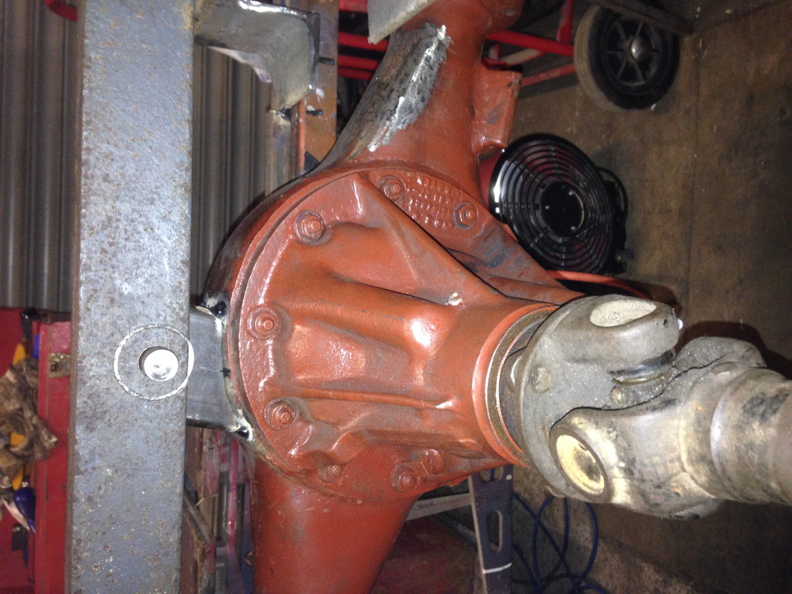

I spun up a bit of steel plate on the lathe and made an adapter to mate the Suzuki transfer box directly to the Land Rover rear axle.
With the Suzuki box in place and the Range Rover propshaft pointing forward I can now position the front cross member.
/ DIY Mini Digger
#17

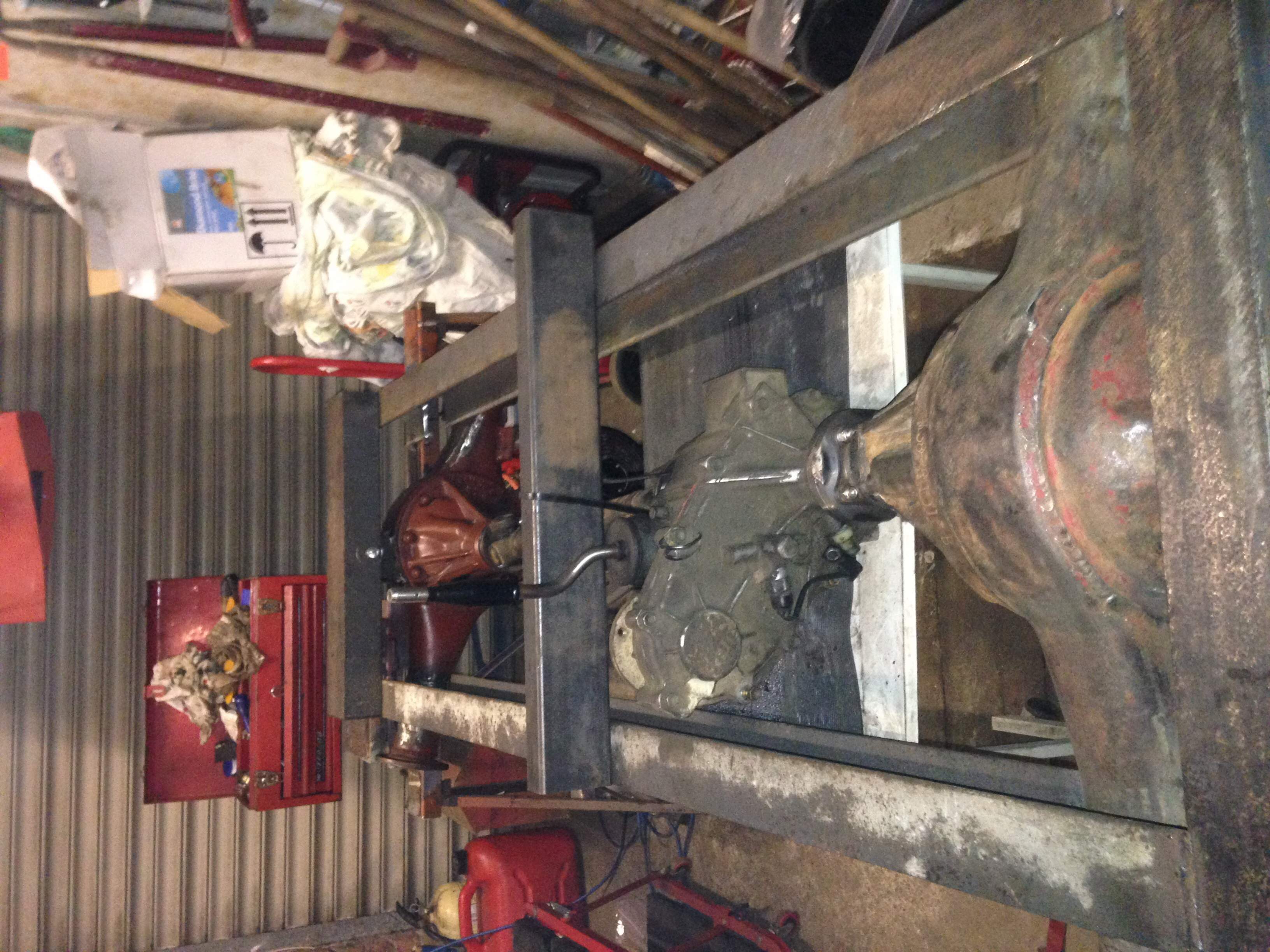

Here's the chassis layout!
The front axle is just hanging from a temporary pin while I chopped out the chassis rails to give travel clearance and yes that's a cable tie holding the transfer box.....
I've part drilled through the cross member with a hole saw both sides so I can finish it off properly when I've made the bushes and pin. Just wanted to get it set up temporarily to see what it looks like.
