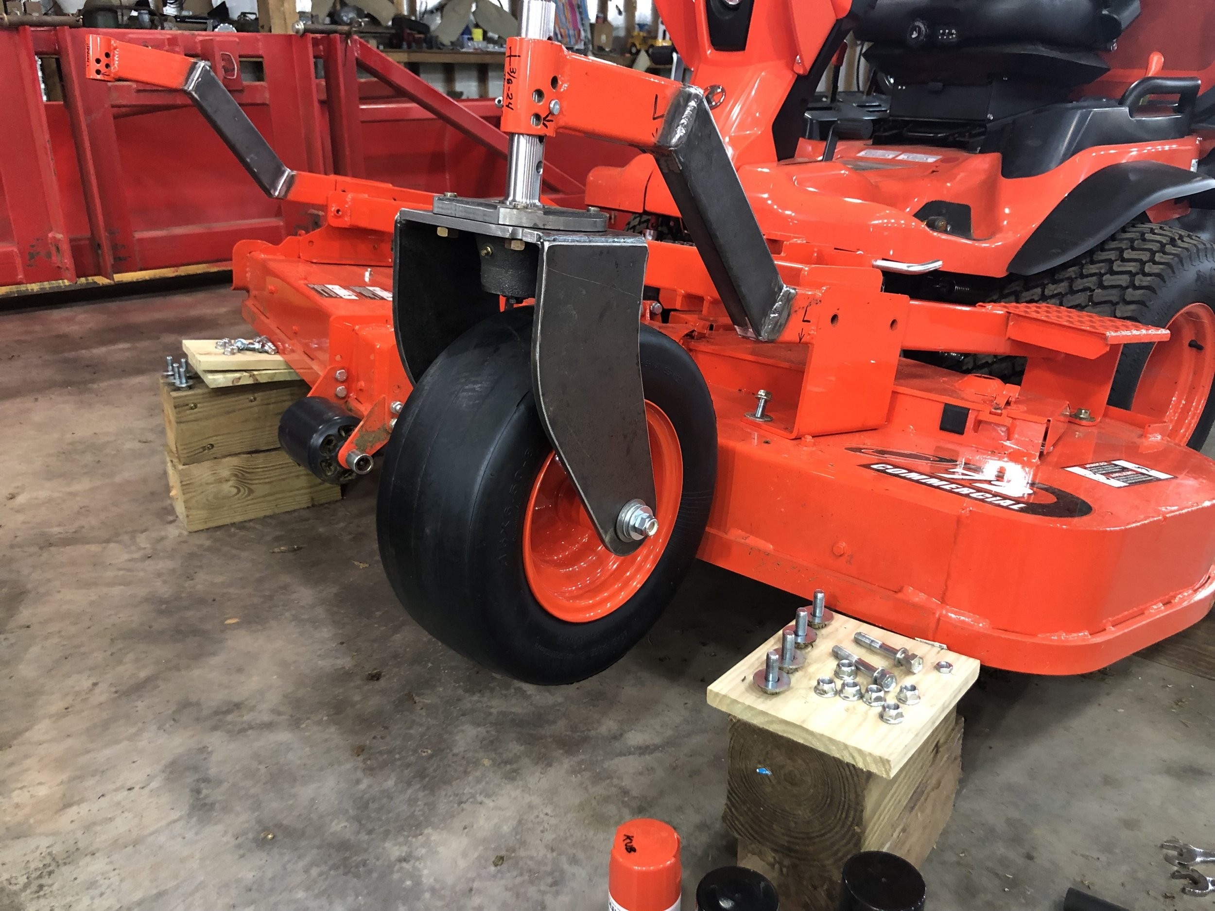

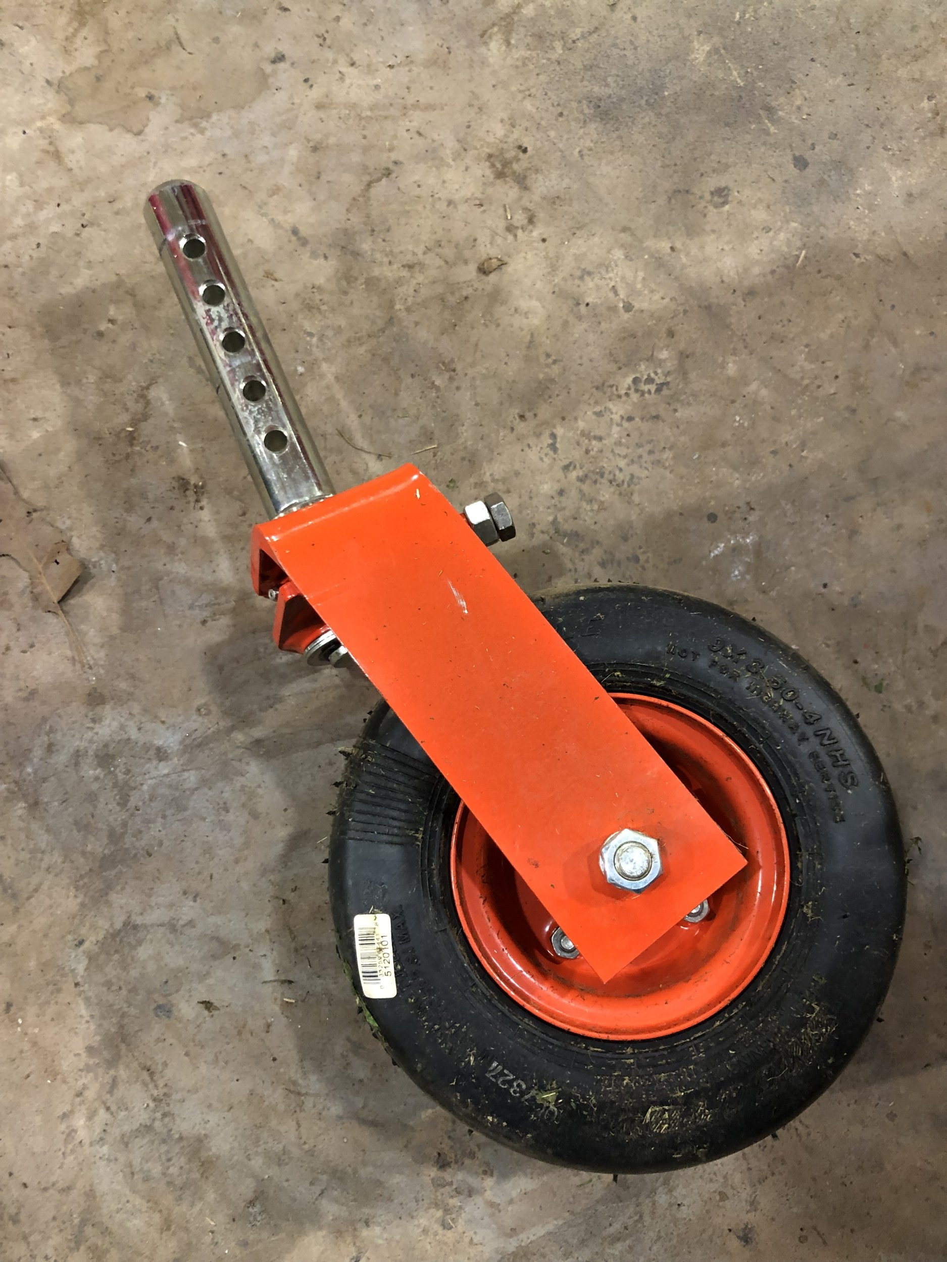

My new 15" Gauge wheels arrived and here is side & front view comparison.
These are aftermarket wheels and have conical roller bearings similar to Kubota ones.
There are some rock bottom price 13" aftermarket wheels which have ball bearings but I decided to stay away from those.
Like said previously, this will be a winter time project for me.

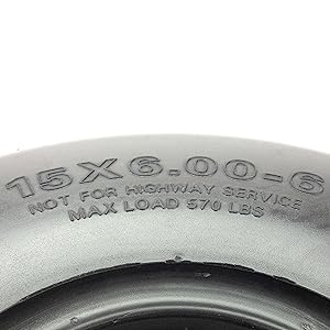

@arto98607 is your 15” tires on 6” rims ?
They appear to have more sidewall than my 8” rims with 15” height
   / DIY replacing worn out gauge wheel assemblies Kubota F series #33
@Brown Dog
Yes they are 15x6.00-6 rated for 570 lbs each.
   / DIY replacing worn out gauge wheel assemblies Kubota F series #34
Ok that explains why yours has more sidewall than my 8” rim (y)

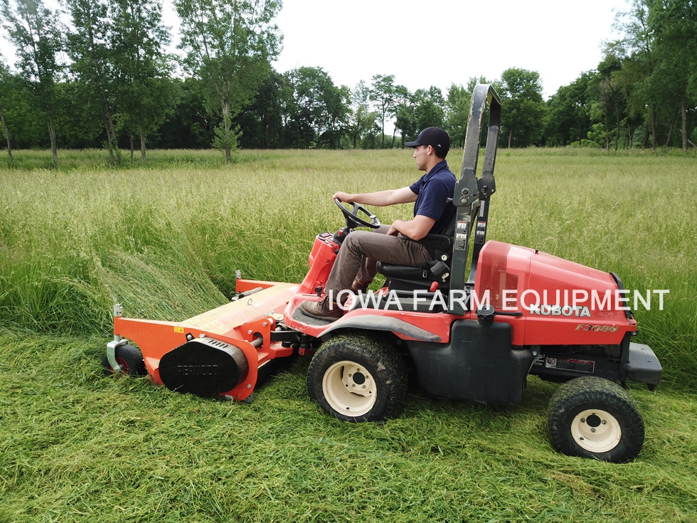

The Peruzzo flail mower deck from @arto98607 post in another thread has much bigger front deck tires than the stockers.

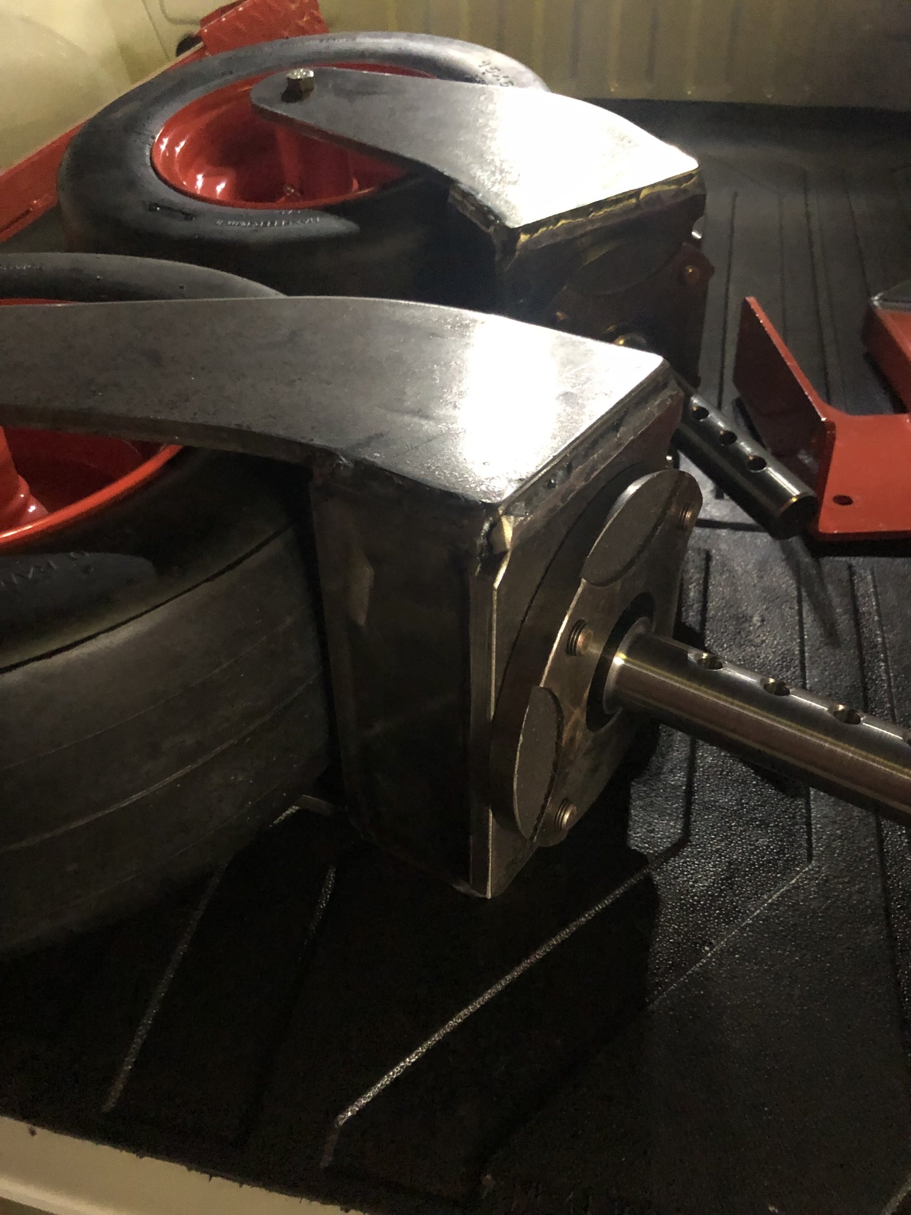

   / DIY replacing worn out gauge wheel assemblies Kubota F series #38
I’m still waiting on my machine shop buddy……
To cut, raise & lengthen my deck frames plus build longer spindle bearing wheel yokes.
Maybe next week 😬

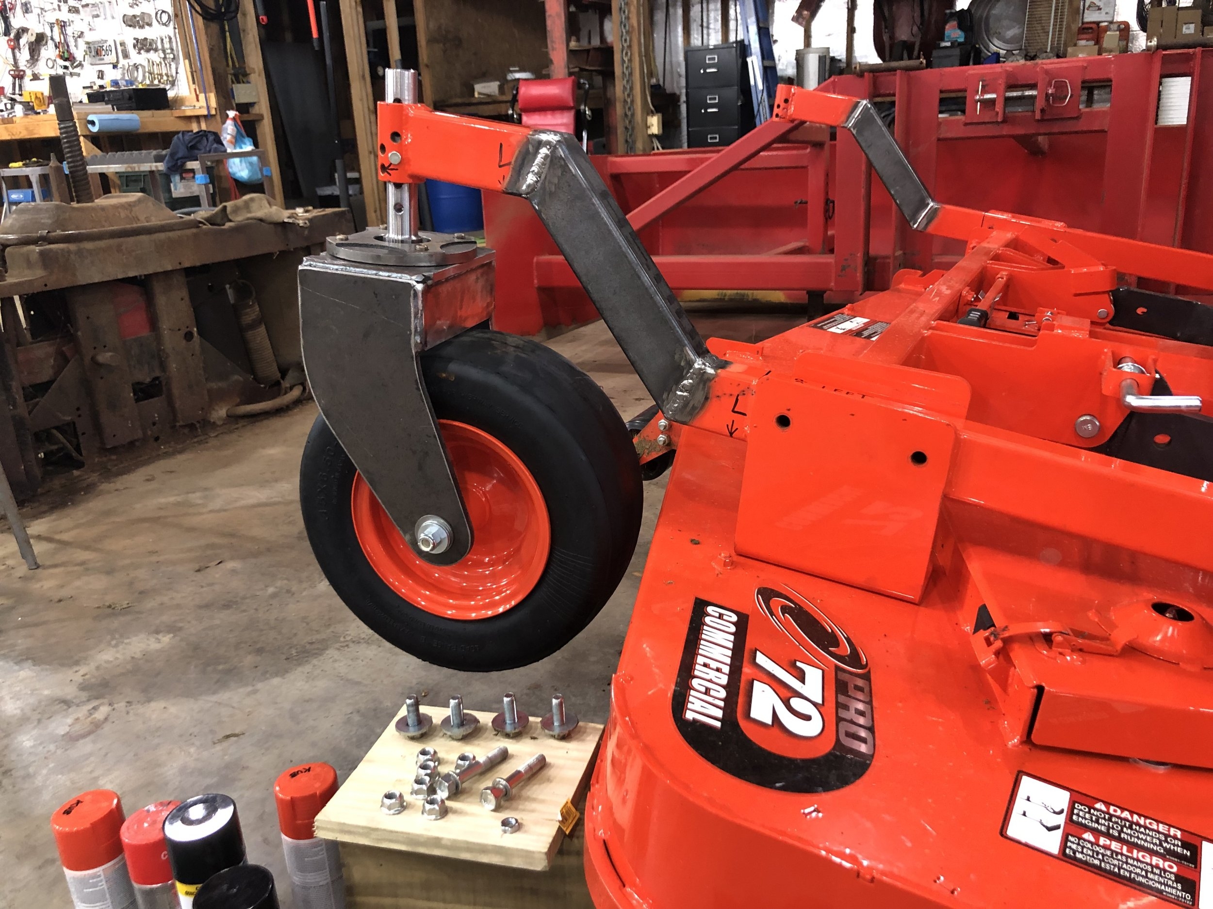

   / DIY replacing worn out gauge wheel assemblies Kubota F series #39
Mocked up to make sure Big 15” Tire would clear the Deck Before welding gusset plates on 1.5x2.5 tubing frames.
They are extended 4” longer & raised 7” taller.
These custom spindles are Super Beefy & turn butter smooth thanks to the 4 bolt implement bearing spindles .
I’ve got to paint everything with Chevy Orange Engine paint & install spindle seals & dust caps.
   / DIY replacing worn out gauge wheel assemblies Kubota F series #40
Notice the cross brace over the tire to wipe mud and / or wet grass off just like the stock caster yokes on my ZD1511
