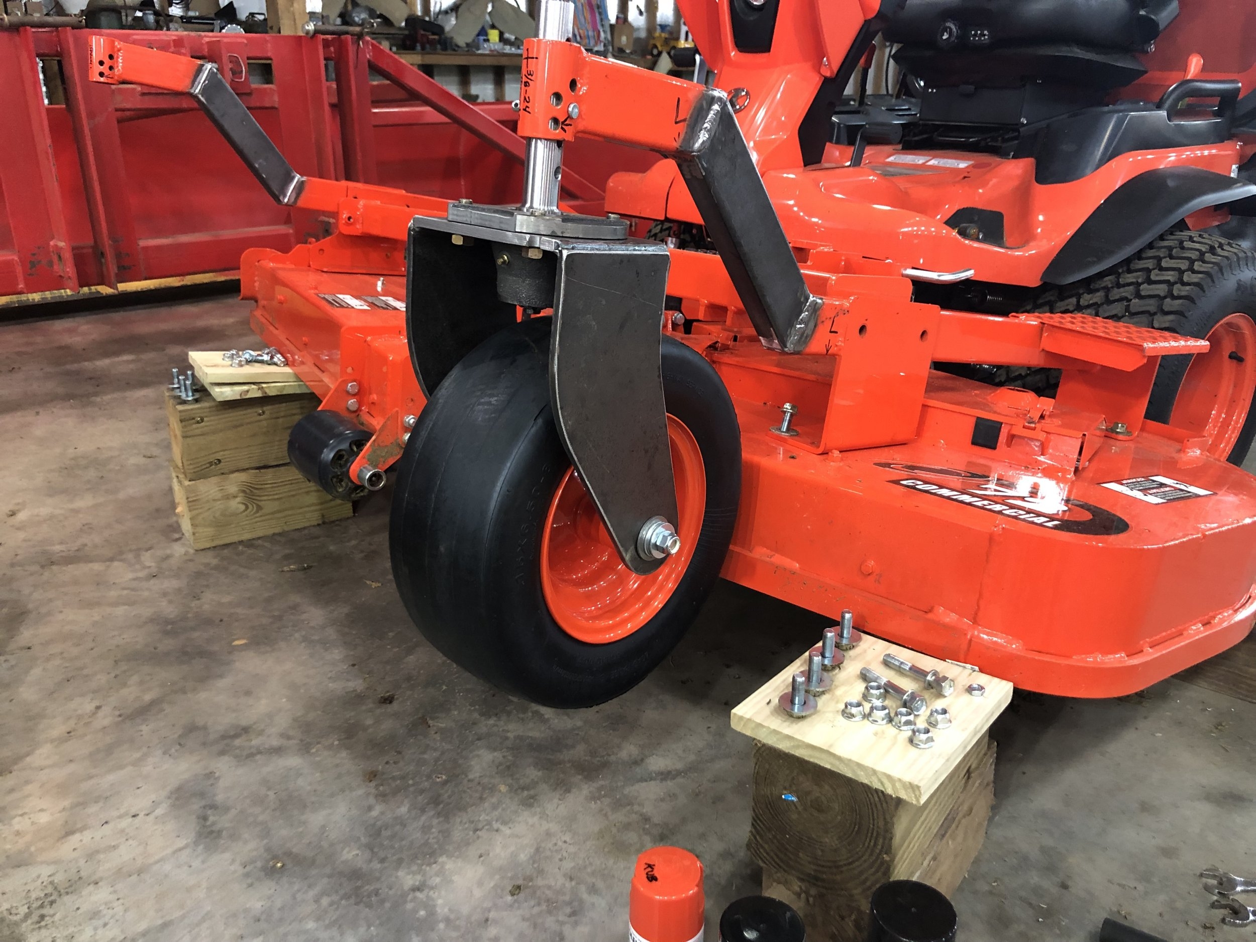

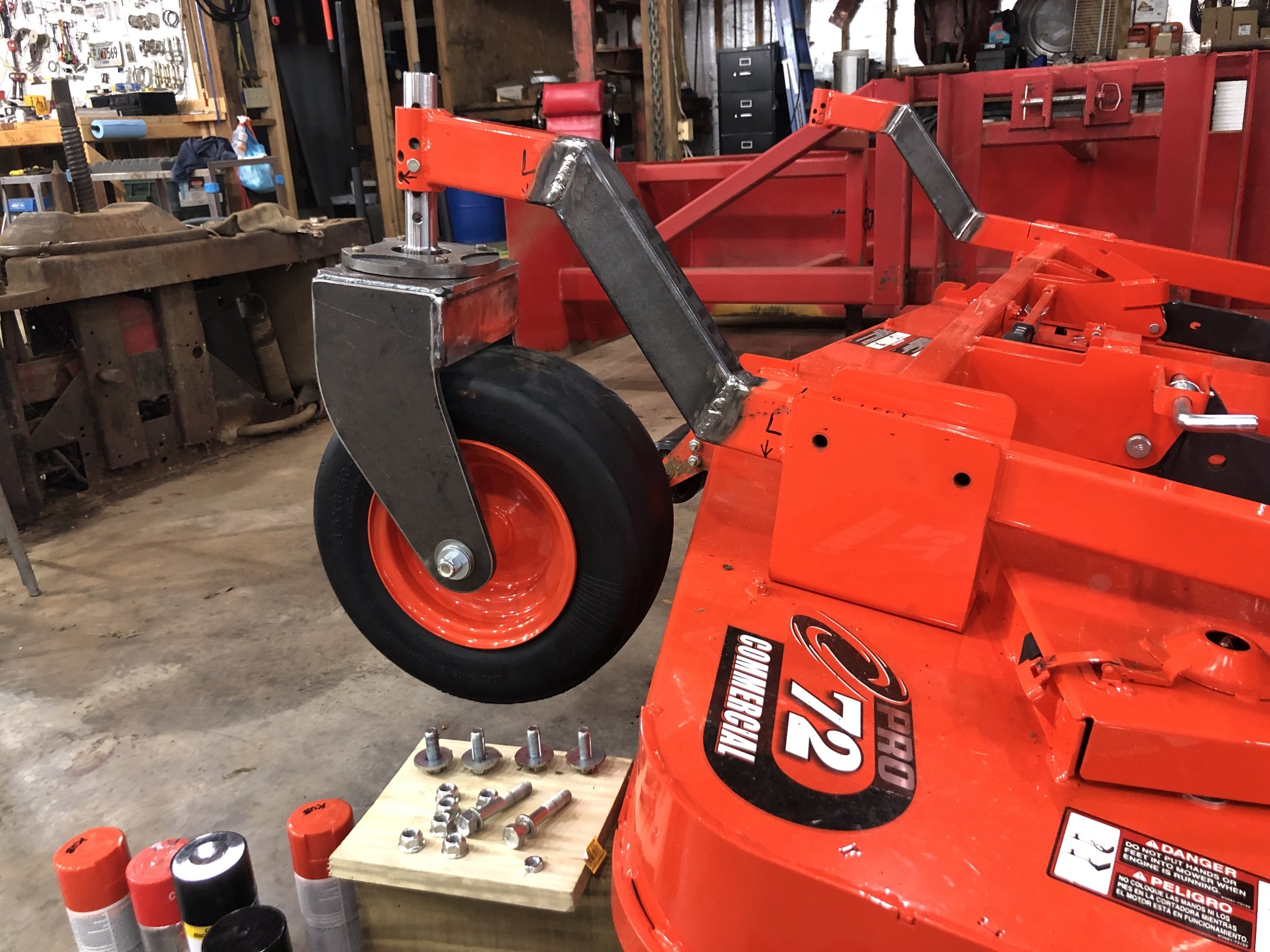

Mocked up to make sure Big 15” Tire would clear the Deck Before welding gusset plates on 1.5x2.5 tubing frames.
They are extended 4” longer & raised 7” taller.
These custom spindles are Super Beefy & turn butter smooth thanks to the 4 bolt implement bearing spindles .
I’ve got to paint everything with Chevy Orange Engine paint & install spindle seals & dust caps.

That looks very good - it's good to have a buddy who can do quality machine shop etc. work like that!
I was also planning adding couple of small gussets on each arm at both ends, where the new steel meets the original steel.
Please keep us posted!

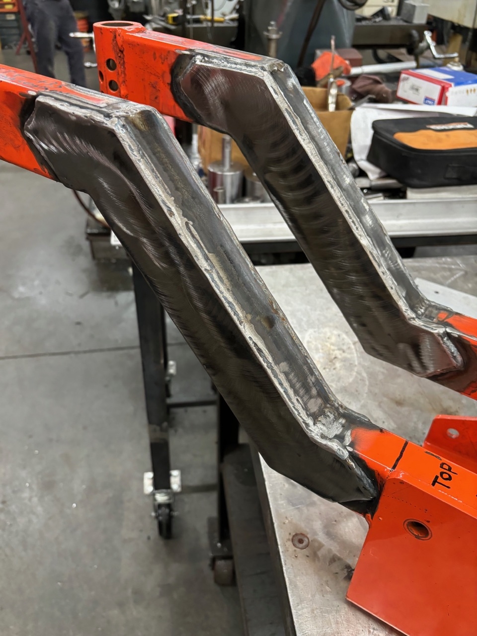

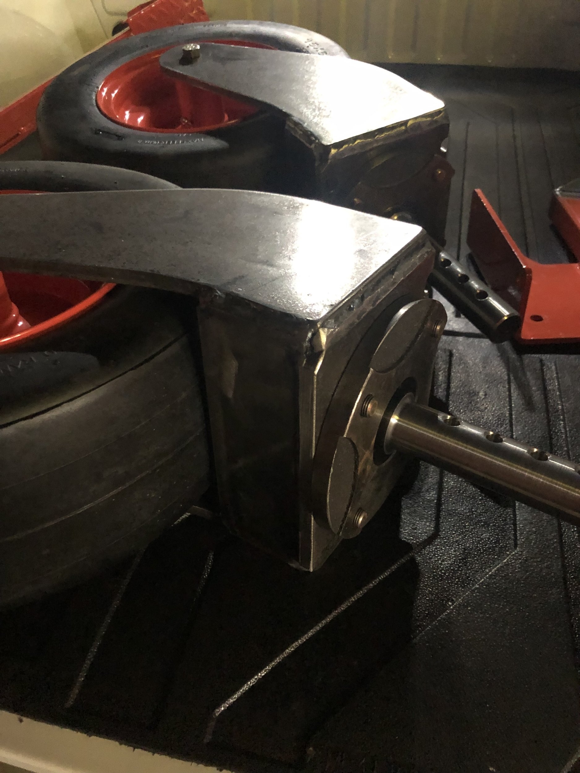

I was originally going to stack two or three pieces of the same size tubing & weld to get the correct height until my machine shop buddy suggested this 45° riser which I’m glad he did as it looks way better lol
He is working on 3/16 side plate gussets today.
   / DIY replacing worn out gauge wheel assemblies Kubota F series #43
They are done I’ve got to go pick them up …..
The new gauge wheel assembly looks like it will be bullet proof! I like it.

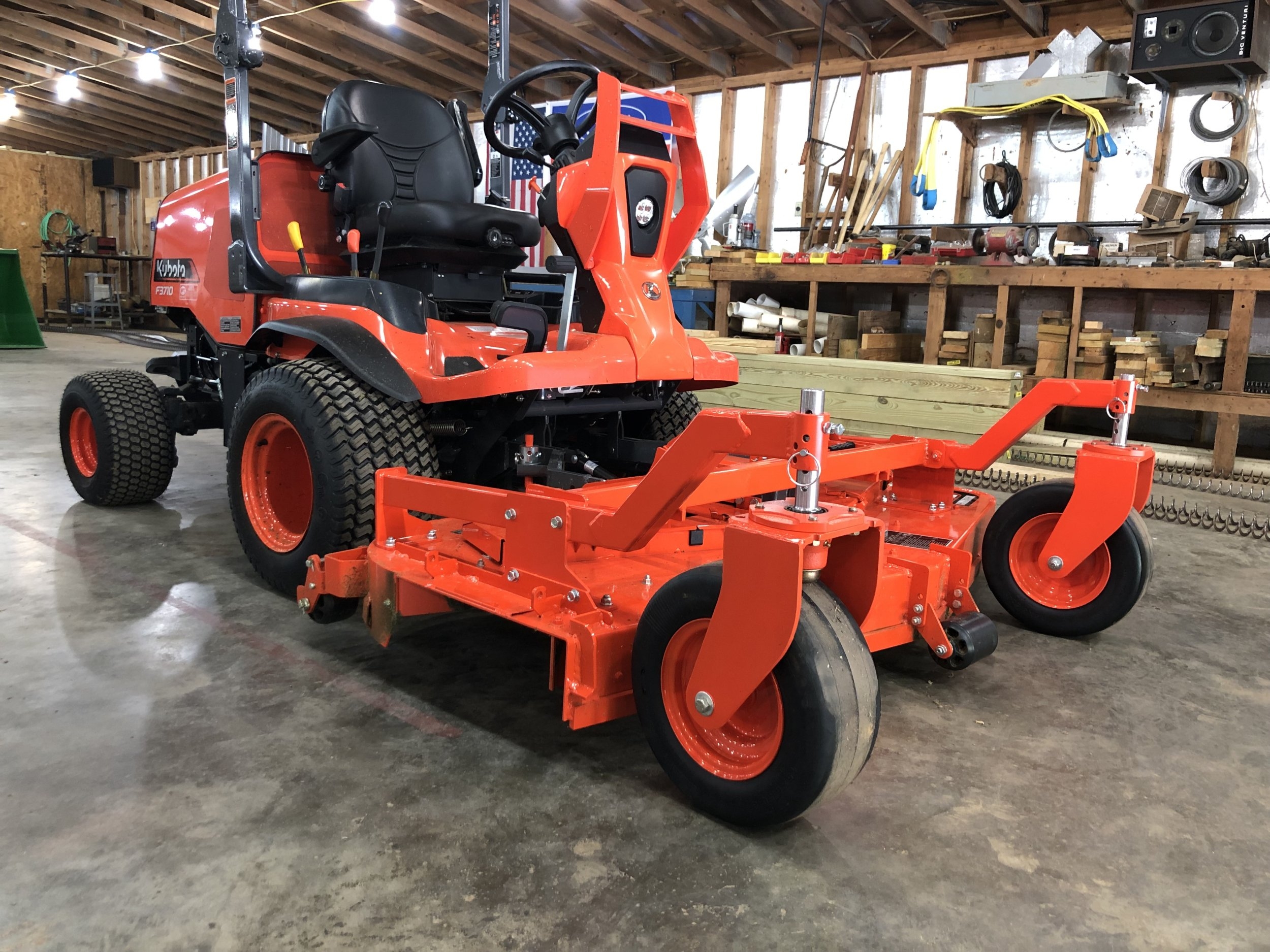

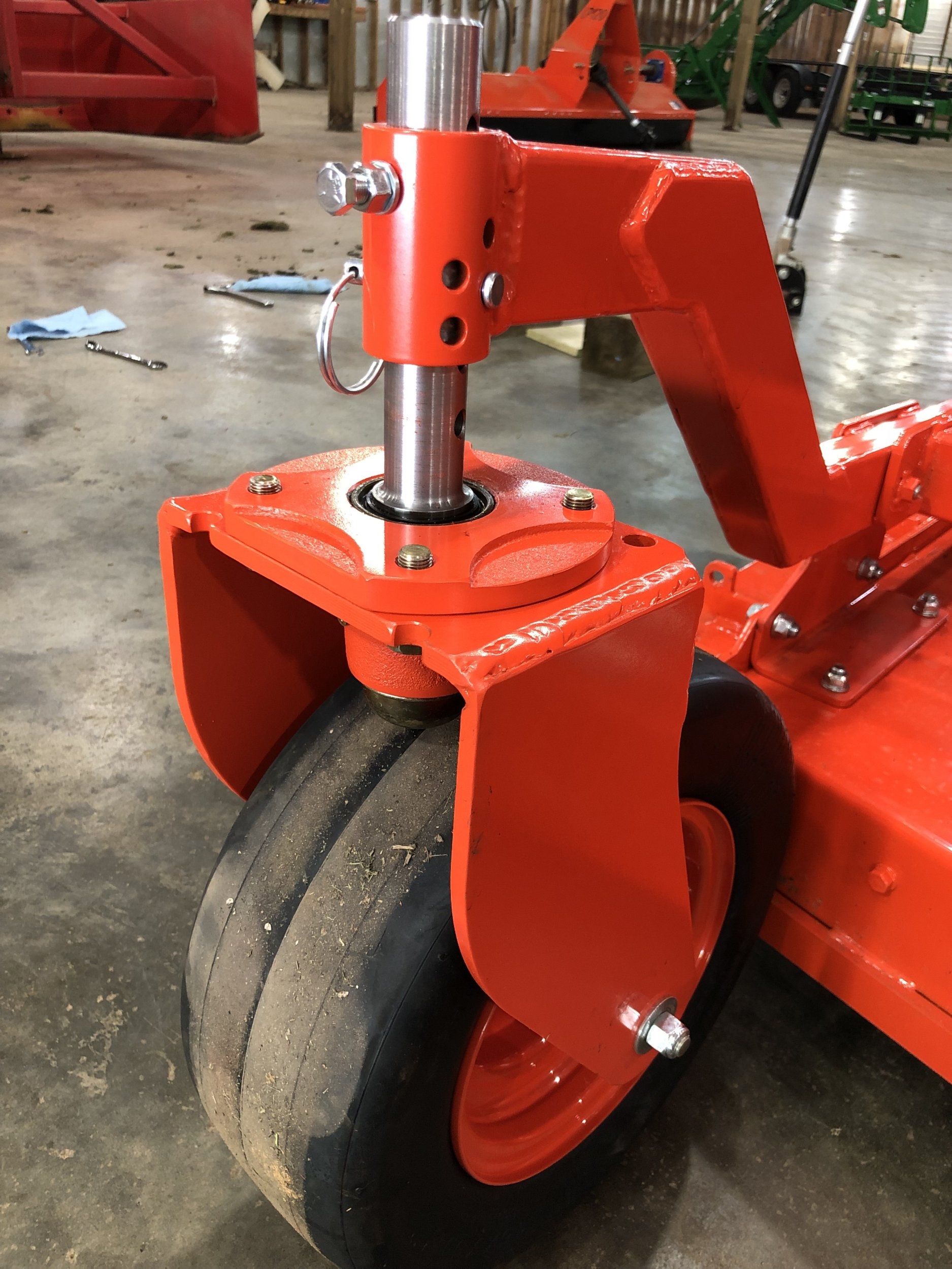

It’s complete
I’m glad I have plenty of adjustment up front because I had to run left side of deck higher to make blades dead level measuring from concrete floor.
It mows great.
The ride isn’t that great with dry tires after mowing 4.5hrs non stop : they will all 4 be fluid filled asap.
It doesn’t like mowing horizontally on my steep bank at all on bone dry ground.
Slides downhill bad & unloads the upper front tire 😩
It mows it up & down fine except for a few places it wouldn’t climb it.
   / DIY replacing worn out gauge wheel assemblies Kubota F series #46
Notice the 3/8-24 bolts & jam nuts to lock down the 32mm shafts to reduce any slop since they’re pinned & don’t swivel
