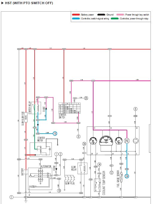

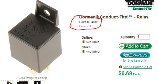

Looks like I need a new relay. I believe there is an identical relay on the firewall that goes to glow plug?
Don't need that in Florida but if a relay is all of say $20 I'll go get one.
It may be "just swapping parts" (which I normally don't recommend) but a new relay is a good thing to try. Even if the old one turns out to be OK, these are high failure items so a spare is a good thing to have in stock. With luck, a new relay will fix ya.
As noted, the start solenoid relay and stop solenoid relays are the identical ones. The glow relay is different, rated for higher current. Swapping connectors between start and stop relays is a proven diagnostic technique but, for unknown reasons, some marginal relays function OK in one circuit but not in the other.
The +12v signal to that start relay coil comes directly from the key switch, which is also a common problem item. If the switch is the problem a few shots nod WD40 in the key hole may restore function. The ground path for the relay coil is through the cruise module, which only completes the ground path if it sees transmission in neutral and PTO off. The cruise module itself may be bad, the PTO-off signal could be bad, or the potentiometer that indicates gear range (L-N-M-N-H) could be bad or out of rig. I think one owner (in frustration) bypassed these safetys by rigging a permanent ground jumper to the ground side of the start relay coil.
   / DK 40 Starter Question #22
As noted, the start solenoid relay and stop solenoid relays are the identical ones. The glow relay is different, rated for higher current. Swapping connectors between start and stop relays is a proven diagnostic technique but, for some unknown reason, some marginal relays function OK in one circuit but not in the other.
I am just curious how you found that the starter relay and the glow plug relay have different current carrying capacity? In my parts manual, all 3 relays show to be the same part number...(they are also all labelled "Glow Relay") On my tractor all 3 relays have the same connector size & configuration, so all 3 harness plugs will plug into any of the relays, and the wires are the same gauge in each of the plugs.
If the glow plug relay can carry higher current, there is no reason it could not substitute for the starter and/or stop relay,,, in fact it would (probably) last longer in these positions as it would be less 'strained'.
Also, I just noticed the "Kioti knowledge site" link (at the bottom of your "equipment list") I visited the site, & it is fantastic!! If somehow you could just make that link more prominent, it would surely help a lot of people with diagnostics. Now that I've found it, I will keep it marked. Thanks!! that is obviously a LOT of work you have gone through.

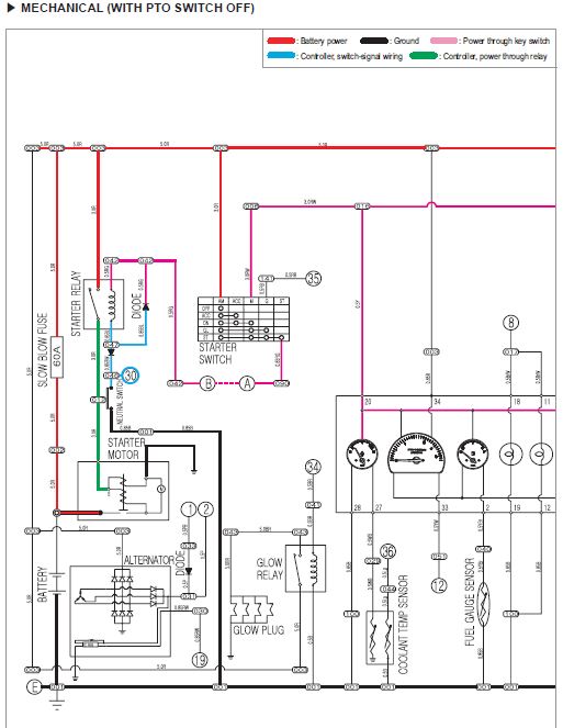

Like James said, Kioti has been changing the relays over the years. Previously, they use relays with only normally open (NO) contacts when that's what they needed. Later they switched to relays with NO and NC contacts for all applications even when only one set of contacts had a function. On my 2006 DK45s the glow relay contacts are rated for more current than the start and stop relays. I suspect the engineers spec'ed the cheapest relay that would do the job but later the logisticians determined that common parts saved more money than some cheaper relays. To answer your question, there is nothing wrong with using a relay with a higher contact current rating, at least not for this application (some really high power relays need higher current to keep the contacts clean). The glow plugs probably pull close to 40 amps for, maybe, a minute and about 50% more initially. The stop relay only passes 25 amps for one second (until the hold coil can keep the plunger retracted). These relays generally have the ratings and pinouts printed right on the plastic case.

Yours is a different tractor I believe. They may all be the same on yours, but they are not the same on our DKxxSE series. The glow plug relay on ours is rated for 70 amps. Just bigger heftier contacts.
OOPs, you're right, I guess I just ***-u-me-d any DKxxSx would all have (basically) the same electrical systems; but I see by my parts manual, it covers many DK45 series, but no "SE" (I think the "E" is for the hydrostatic trans??) I also see the OP has a hydrostatic trans, so I guess I was giving poor advice about the relays. I do see in my service manual the contacts for my starter relay are rated 70 amps - which might be why I have 10+ years, & 1000+ hours without having relay problems.

Hey vet, sounds very similar to an issue I had a few years ago on a dk40se hst. Dealer came out three times, replaced cylinoids, and finally sold me a battery that I didn’t need. Issue kept recurring. I finally figured my problem out. From memory, it seems there were two wires connected to the hot side of the battery. The smaller gauge wire goes to the starter and was just clipped to it and worked itself loose often allowing just enough juice to make a little noise when trying to start. Push the clip back on and starts great.
   / DK 40 Starter Question #34
Bendix shemndix
Ritchesvs was on the money. Glad i did not go spend yet another $100 on starter.
I was jumping starter the wrong way. At least I did not fry anything.
Key off jump + and spade terminal cranks like a champ
Key on jump + and spade: Starts right up.
In the interim I'll keep jumper wire in the DK

If your relay fails again you may need a starter after all. A relay can fail like any component but, if it's asked to pass more current than design it will fail quickly. In HS I worked in a starter repair shop and half of the starters that came in for repair would have a brand new solenoid/relay on them, showing that the quick fix didn't last long.
You did the right thing, relays are cheap, just be prepared so it won't let you down when you need it...Mike.
   / DK 40 Starter Question #35
The failed relay in question is the small cube relay on the firewall that switches the current to the starter solenoid. There have been many reports of failures for these relays so it's a logical thing to check. I don't recall any reports of actual starter or starter solenoid failures. As you note, these small relays can fail "open" if the contacts are badly burned or pitted or they can fail closed (much worse) if the contacts weld themselves together. But fail open is the typical problem with the starter relay or the identical stop relay. The stop relay provides a high current (like 25 amps) to the pull coil of the stop solenoid but only for one second. After that, power from the key switch keeps the stop solenoid retracted until the engine is switched off. At that point (no power to the stop solenoid) a spring extends the plunger which forces the injection pump rack to the zero-fuel position.
   / DK 40 Starter Question #36
That's a good point. I now see that in this case the relay in question would only see the current of the solenoid and not the starter motor. In the days that I recalled, the combination solenoid/relay was the only relay from the key switch to starter motor...Mike.
