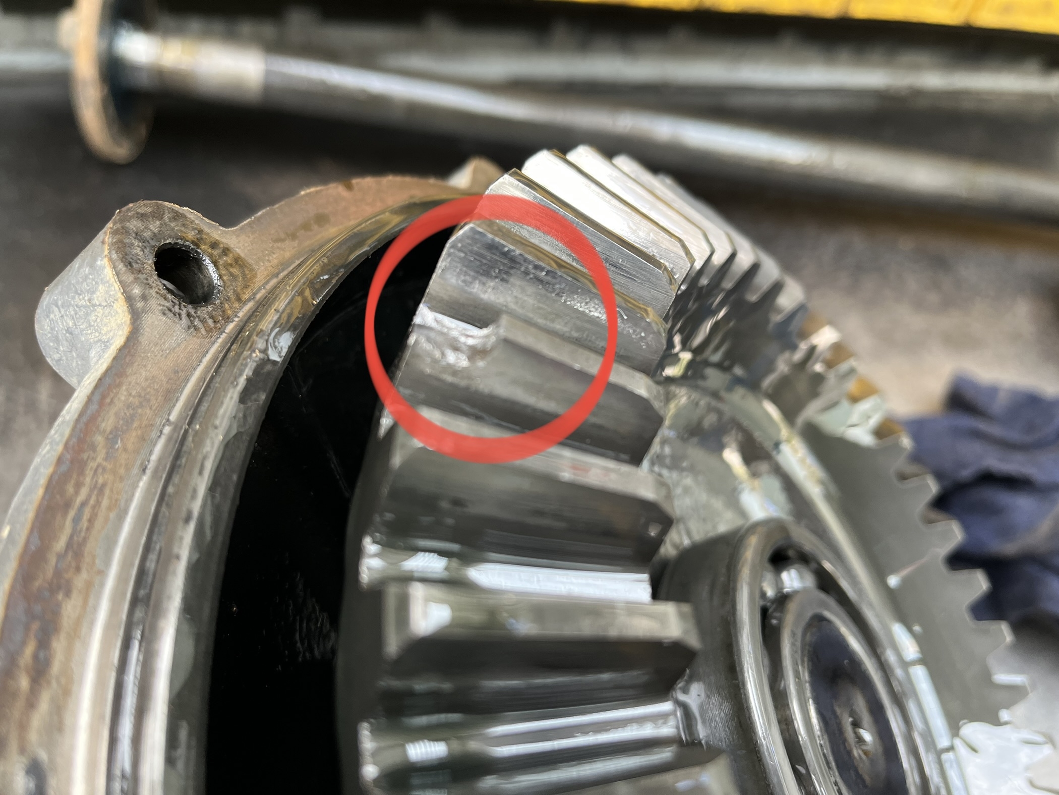

hi all, i havent been on for a long time, now have 975 hours on mine with heaps of heavy front end loader work.
just doing a service on our EX50 and found a piece of tooth in the drained oil from rh front bevel hub. - i always remove the lower cir clip and plug to drain the oil rather than the small drain plug, as you get to see and remove any wear metal. in this case i found a bit of tooth that has come from the main bevel gear - see picture.
i was unaware of the bearing issues with this model until tonight
i will be changing all bearings while in here - and now due to this post will look at replacing the wheel bearings on the other side also.
thanks for the heads up.
anyone seen the bevel gear loose a bit of tooth like this before ?
it sucks as this would be the best maintained tractor around, front gear oil are changed every 75 hours - go 80w90

Sorry to hear of this failure. I do not know your tractor. Are you using at least 1000# of counterweight on your 3PH?

To me what would cause this is turning on hard pan in 4x4 and the wheel in particular was jumping due to driveline wrap. I run 85 - 140 in my 4510hst.
the tractor is the same as a DK50 i think in the states. and yes always have at least 900LB 3pl load on the tractor
