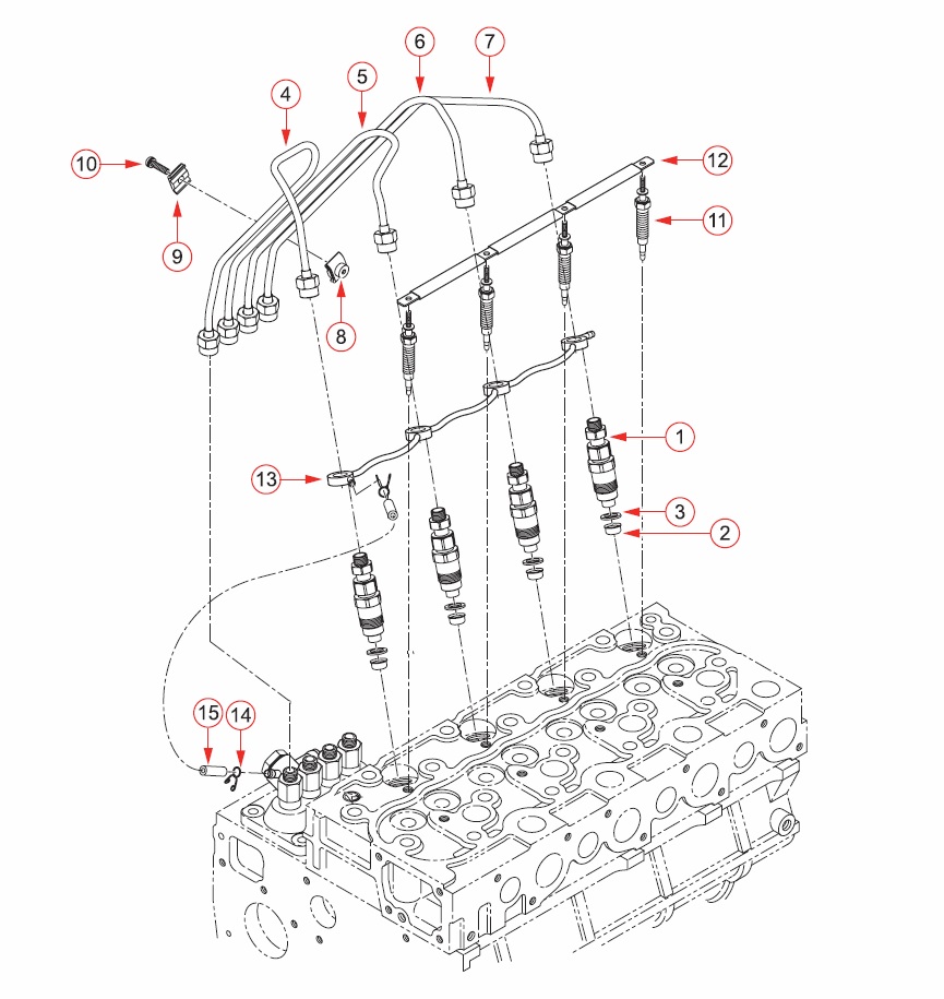

Ok solenoid and relays for fuel shutoff confirmed functioning. Took it out and watched with my own eyes. Still no light off.
I put the multimeter on what i think are the tops of glow plugs and i get no voltage when key is on.
I notice the trouble shooting chart in the book says - no cold eng start is the timer relay.
I shot the key switch up w wd40 - doesnt appear to have changed situation.
Whats best way to check that glow relay?

Keep in mind the glow timer is on for a few seconds, but it also "post glows" after start about 15 seconds. But if you don't have any voltage on the glow plug buss, then either the relay coil is not energized by the timer circuit in the module or the relay is defective. I would measure for voltage on the coil contacts and also the "make" contacts.
BUT.. If the weather is warm, I am doubting the pre-heat system not working at all would cause it not to start. Isn't it warm in Indiana now? I would think the tractor might stutter and stammer a little but I would think it would still start at these temps.

Can you clarify where to take measurements? Im a bad electrician...
In this diagram, the glow plugs are number 11 and the bus bar is number 12. You can measure the voltage between any bare metal on the engine block (like a screw or nut) and any bare metal on the bus bar. A nut at one of the glow plugs is a good place. There is a wire that connects to the back end of the bus bar to provide the power; make sure it hasn't come off. The glow plugs will only be powered for a short time after the key is turned to "on". There is a timer (in the display unit) that turns on and then off the instrument panel "glow" light after 0-8 seconds (depending on engine temp) and then shuts down power to the plugs 15 sec later. The display unit supplies 12v to the glow relay coil to energize the glow plugs and zero volts to turn them off.
Some indirect-injection Diesel engines (like yours) will start on a warm day (like 75 degrees) without glow ... and some won't. So you do want to be sure your plugs are getting power.

<img src="http://www.tractorbynet.com/forums/attachment.php?attachmentid=423179"/>
Ok i get astream of fuel from mechanical pump up to filter bowl on cranking.
Havent checked lines out of injector pump yet.
I get no power on the glow plugs with key on. Indicator light works for glow plugs.
I will check fuel flow out of injector pump tomorrow.
Is the preheat relay the one that sends power to glow plugs?
