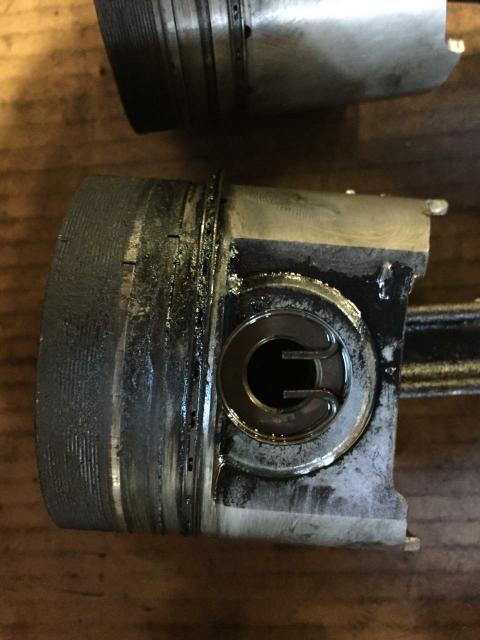

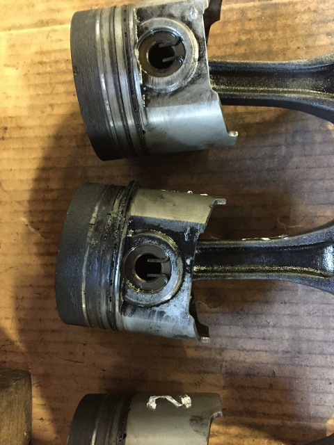

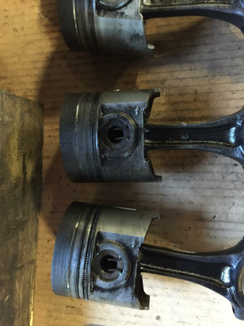

Ok long time no report. I've been changing jobs and a host of other things....
Had the beast towed to my nearest servicing Kioti dealer (expensive btw).
Report today was that fuel delivery was intermittent - so injection pump is a suspect part.... bad news number 1.
Worse news is that very low cylinder pressure was found. They tore off the head and no obvious issues (cracked casting / head gasket).
So tearing out bottom end they find the piston rings fused with burnt oil down into the grooves.
No apparent serious damage to cylinder walls (not sure if this has liners).
So his generous estimate to rebuild short block is over 4k.
Rather disappointing news.
He is going to call kioti and see what a new engine runs compared to his 125 an hour rebuild. I dont expect a good trade on that front.
At this point with 300 hours on a 2007 machine - i will lose a fortune.
I will not be buying kioti again. For a company that was founded as an engine builder - I'm not impressed at all.
Once this is done i will possibly have a rebuilt tractor for sale.
Sore spot is that i cant think what could possibly do this to a nearly new engine. Its never run hot never been low on coolant or oil.
I would be angry but I am too stunned to even get charged at this point.
Ill see if i can post the pics of the pistons from my phone.

That center piston looks like crap but all that carbon is likely a symptom of another problem, like poor fuel delivery/atomization/combustion. It's possible that those pistons and rings would be fine after they were cleaned up; they need to be measured and inspected for damage. Diesel engines with poor fuel delivery (bad injector spray pattern, air in fuel line, defective glow, running too cold, etc.) can produce a great deal of carbon that can clog rings or foul valve seats making normal compression readings meaningless. In mechanically-injected Diesel cars, the carbon cure is an "Italian tuneup" which means prolonged running at high power to burn off the carbon. This is typically described as "drive it like you stole it." In short, I'm not convinced there is anything mechanically wrong with your pistons and rings unless measurements indicate damage or wear. So before springing for an expensive rebuild, be sure your pistons, rings, bores, or bearings are actually damaged,

I spent my 3 hr delay in laguardia reading the thread regarding the shattered piston of chris'. I was thinking a similar thing. 4 of us have been cranking that motor a lot while troubleshooting, could have fouled the cylinders with all that.
I figure a injector rebuild with a cleaning and reassembling of the bottom end might be worth exploring.
User illini22 gave me some hope in that other thread - as i have my rig at ronsons in lowell - i really like them and have more confidence hearing the endorsement.
I'm just worried that fouled chambers send junk every where during when cranking.
Im going to wait for some more analysis by dealer before i start on a plan of action.... a shattered piston this is not.
Its still a dead machine tho.
But im still baffled by 20 minutes of cranking causing that much fouling.
We did have a nasty winter... any chance cold running would contribute?
