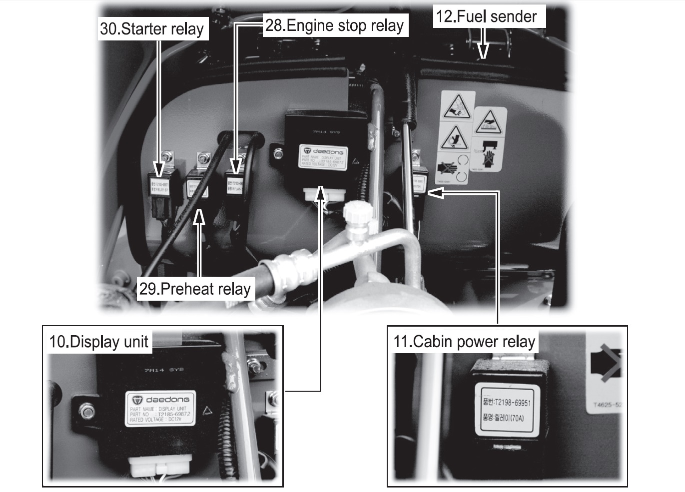

Is the preheat relay the one that sends power to glow plugs?
yes, it is the larger one in the middle
   / DK40SE HST No start - fuel problem? electrical? #32
This should help:
I think your no-glow must be either the glow relay (most likely and least costly) or the display unit, although all the other display unit functions seem OK.
   / DK40SE HST No start - fuel problem? electrical? #33

OK frustrating results on quickly replacing the preheat relay. Same no start.
Didn't have time to check the voltage at the plugs... but if I had to guess - no juice.
Anyone know how much the Timer relay runs? Or should I bite the bullet and get both that and the display unit - which looks pretty pricey - just judging by the wires it has going in and out of it.
Do all the safety switches etc. cut the actual starter motor circuit? I don't have the full diagram with me during the week... not entirely sure I would be able to tell even if I did.
I've replaced the preheat, start, and fuel stop relays so far. Getting fuel from the bottom of the tank up out of the top of the injection pump. Harness connections seem OK for all the ones I can pull up to where I can see. I guess I should check the actual connectors to see if anything weird is going on there - but no obvious indications like a wire hanging out the back.

OK, so you have fuel to the injectors, that's good.
I previously assumed that all the SE models used the Display Unit (photo in post 32) to control the glow relay (and also the pulse to the SS pull coil). But maybe some earlier DK40SE models use the older preheat controller (T4620-69054) (plus a timer relay) instead of the Display Unit (T2185-69872 to T2185-69875). So I will assume you really have a preheat controller (vs Display Unit) on your firewall. It is possible that none of the published DK40SE service manuals show your exact configuration (this is the case with the stop solenoid on my DK45s).
The timer relay only effects the SS, it does not effect the glow system. If your stop solenoid works OK, don't worry about the timer relay.
I'll assume your schematic is similar to the DK45s, which also used the preheat controller. In that case, the ONLY things that can prevent power from reaching the glow plugs (key in crank) are the key switch and the glow relay. The black/red wire to the preheat controller is the output to the glow relay coil. It should get power from the preheat controller before starting and for maybe 15 seconds after the engine starts (called after glow which helps the engine run smoother. This wire also gets power directly from the key switch whenever it is in crank positions. The fact you see about 12v on this wire means the glow relay coil should be getting power (i.e.. the switch and preheat controller are OK).
The glow relay is the same as the start relay. One quick check is to swap relays and see if it still cranks. Usually you can do this by just swapping the connectors (e.g. don't move the actual relays). If you get a no-crank after swapping relays you know you have a bad glow relay. These are common automotive relays which should be available at any local parts store (like Autozone).
You can also take voltage measurements at the relay connector. There are two wires for the "contact" pins (#30 and #87) which should have bigger wires. One of these should always have 12v and the other should be wired to the glow plugs. As a test, you could jumper these briefly (less than a minute) and see if you get power to the glow plugs (you should if the wires are OK). The other lugs (#85 and #86) are for the relay coil. One of them should be ground (zero volts and zero ohms) and the other should read 12v but only when the key switch is in glow or crank. If these voltages don't check out, there is a problem with the wires. With the relay unplugged, you should be able to measure 50-60 ohms between 85 and 86 and an open circuit between 30 and 87 if the relay is OK.
