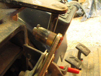

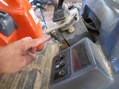

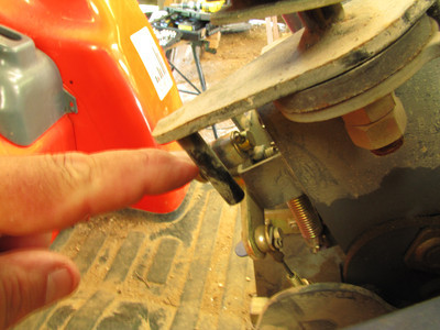

Well I couldn't get two of the screws loose that hold the upper housing cover on. As shown by arrows, those holes were filled with fresh black silicone. It looks like water has collected down in the holes and rusted the nut inserts. I believe these nuts are molded into the plastic housing.
Original view for those with broadband internet.
Chassis Instrument Cover
I could get cover #3 off but cover #7 has the seized screws #6.
I didn't have an inspection mirror but was able to put my cable lube tool on the cable. I now believe the problem is under cover #7 due to the noises I was hearing.
I suspect the dealer put the silicone in the end of those holes in the picture. The picture was taken after I dug the silicone out. It appeared that some water was still down in the "well". I soaked it out with a towel and it didn't smell like anything petroleum based. I shot it with some PB spray. I will soak again when I go back over because the alternate is to drill the screw heads off.

UPDATE This problem got worse recently so I tore into this weekend. Turns out those screws where combo screw head/hex head bolts.......don't know how I didn't see that the first time. That little roller is a bit sloppy and dry. Greased all parts up and works smooth as silk now.
