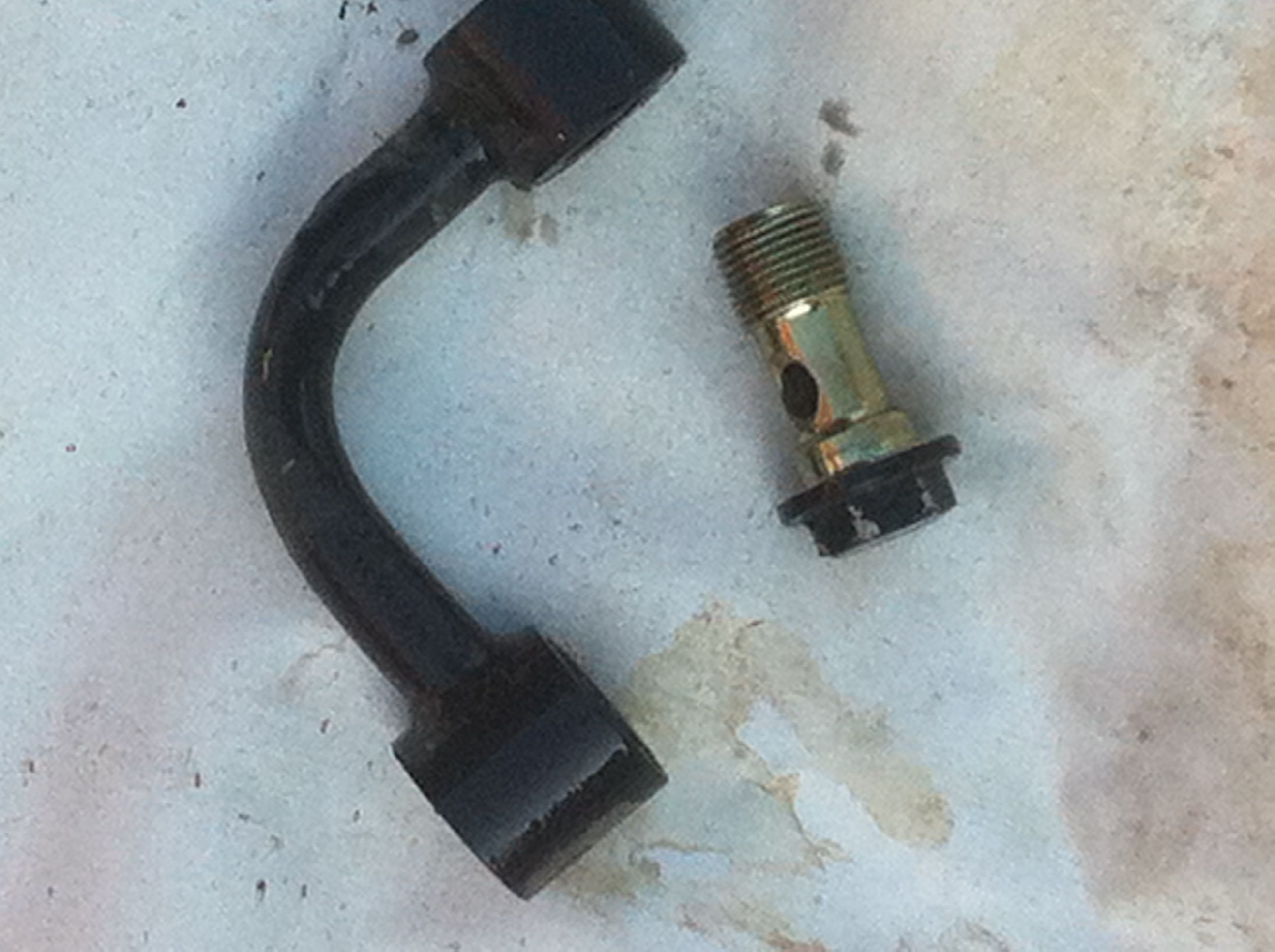

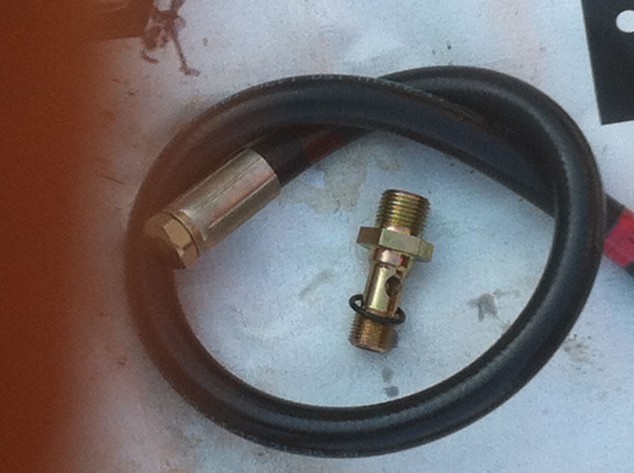

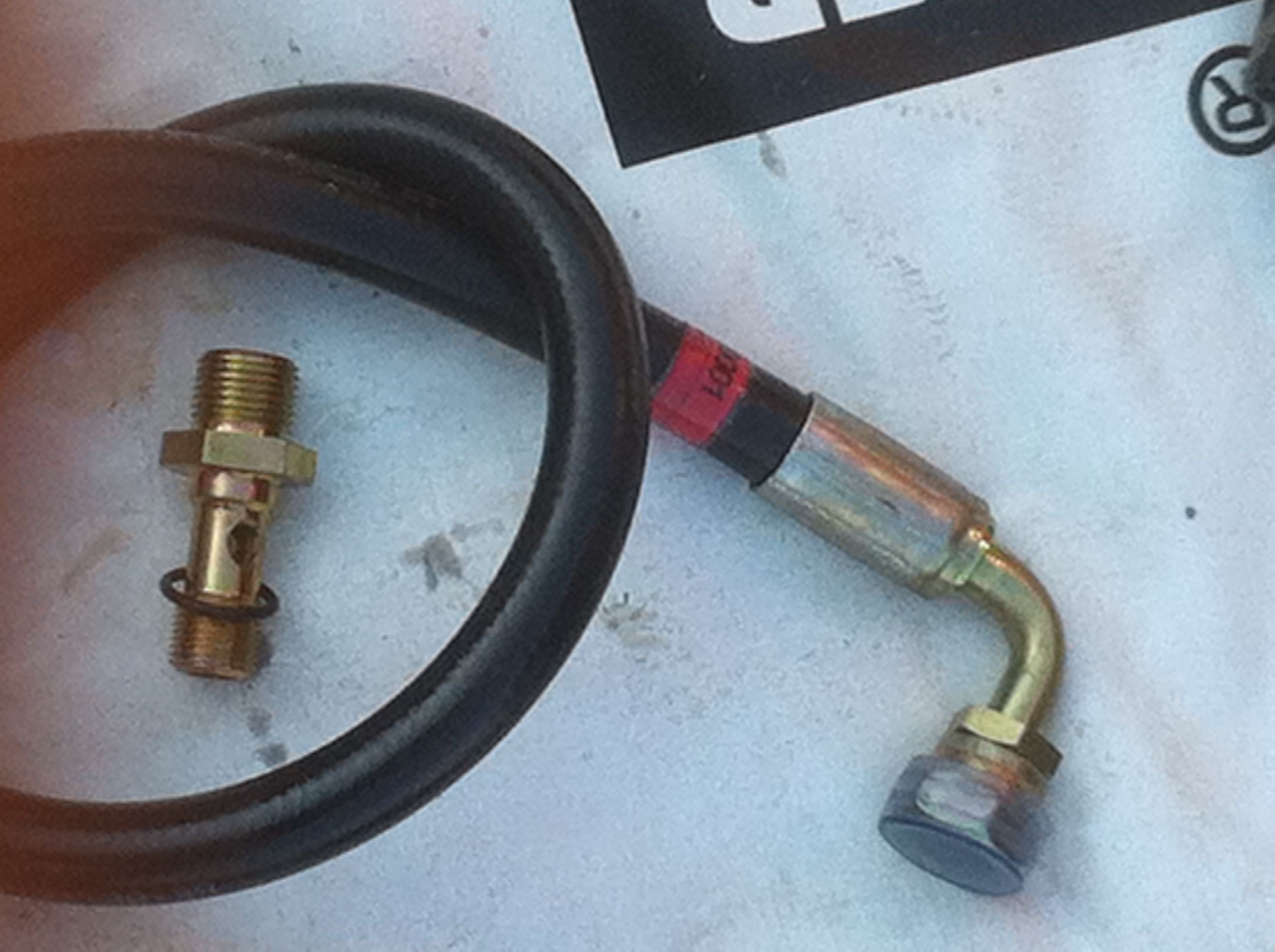

Hey grsthegreat I know what I said when I found the bolt and hastily checked my pressures. The squeal is gone that is for sure over 15 hours of work in 80+ degrees not a single squeal. There are other noises though that concern me the major one is singing and mostly in forward. The artist sounds vaguely familiar to the squealer. There is absolutly less restriction without the banjo bolt in question. I can't tell you the difference the other bolt will make until I receive it. I am waiting just as all of us for it to arrive.
CM backoff there is nothing I can do. I do not have any special connection with Kioti. Call your dealer and order a banjo bolt. I ordered the one that is on the bottom of the HST filter. That is all that was needed they can lookup the part number and I don't know what it is. You can also get yourself some M18 fittings and make up a bypass hose as desribed earlier and shown by kattywumpus (thanks for the details and images).
Now I don't think the bolt is the real problem. This is a restriction in the system and not good but this is not why my (I say my because none of you have tested yours) HST is low on charge pressure. Removing a restiction improves the flow and the supply to the HST precharge. In addition to reducing flow this restriction could also cause an oscillation (squeal or noise) in the lines.
The output of the power steering is the low pressure flow that supplies the HST precharge. Maybe your dealer thinks you mean the output of the power steering control valve to the steering cylinders. In a perfect systems this pressure should be identical to the HST precharge pressure (255 PSI). Any restrictions will add back pressure and 200+ PSI is almost 2x not what I want to see (that is one big oil heater).
We bring them a tractor and say there is an annoying squeal which I'll admit is subjective. They start up the tractor and mash the pedel down ... nope no squeal. After much debate you show it to them and how to reproduce it. You must be doing something wrong. The squeal is subjective and easily deniable. Finally you convince someone and they go to work and try and fix the squeal. The amplitude and frequency of occurence starts off low but as we all know grows to even the slightest touch of the reverse pedel. How many service departments are going to take that much time?
If you bring your tractor in and say the charge relief pressure is low this is easily measured and verified. This is an objective problem there is no denying a measurement. Well I guess Kioti could issure an ECO thats modifies the value to say 205 PSI (that would be a huge mistake). Now you can't do this if you don't actually measure your tractor and know its low for sure.
Ok so let me try and explain the real problem without all the details. Your HST is a closed loop variable displacement pump and motor circuit. This circuit requires makeup oil to replace losses while operating. These losses vary depending on load and use. This is the flow in question and is controllerd by the charge relief valve. This valve should be closed until the pressure builds to 255 PSI. Once this happens the valve opens and passes the flow to the HSY case. Once the case fills with oil it overflows into the transmission and gears and back to the tank. If the relieve valve never fully closes then the pressure will only build to the remaining restriction. This leaves the HST with a reduced supply of fluid and under load conditions the HST can starve and cavitate. Just read through the desriptions in the "Service Manual". There are several places that identify low charge pressure with noise and a faulty or stuck charge relief valve. There is one problom though this valve is buried in the HST requires splitting the tractor and HST to examine (not good).
I suspect Kioti knows this (not sure about our dealers they may be on the darkside of the moon with the rest of us). Kioti is trying to find a solution that does not hurt them. Tearing all these tractors down to fix the charge relief valve is a major hit to their margin. If they can improve flow maybe it will be good enough for us to go away (for now). After all we are not complaining about the charge pressure its the squeal. I suspect they found the banjo bolt restriction as did I and hoped it would do just that. Now for what ever reason they chose to change the hard line out entirely. Maybe this improves flow that much better. Maybe they did not consider just the bolt. By the way I have a larger hose and fittings than kattywumpus in my bypass maybe that accounts for the differing results. I won't know for sure until the parts arrive and hense the reason for delaying the solution or partial solution.
From what I have heard I am sure Kioti will back us but we need to bring them the real problem. They are not going to do extra work if they don't have to. All they need to do is nurse this along till the warrenty expires. This is not hard considereing the hours most of us put on the tractors per year.
Tom
