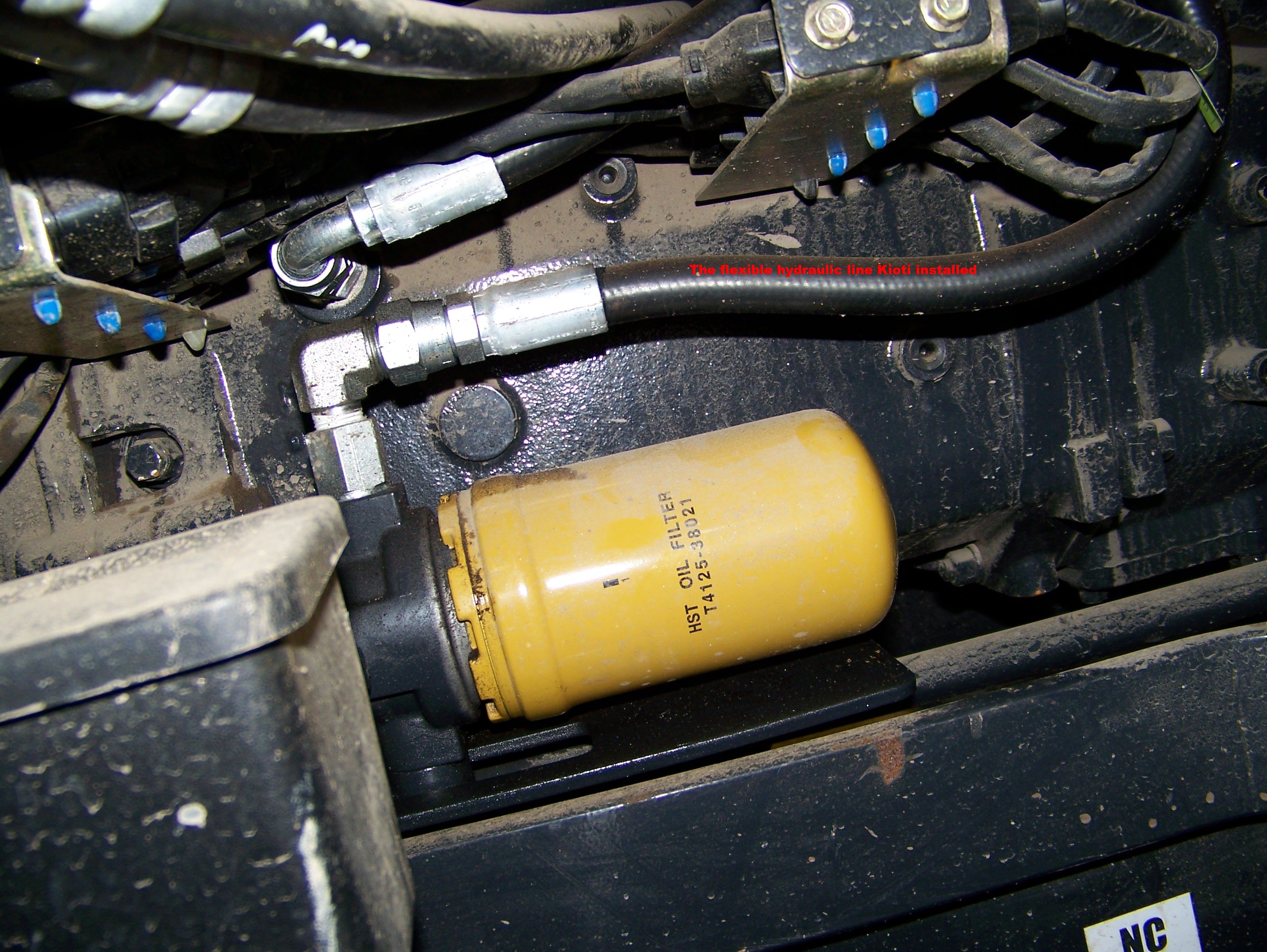

I missed the new banjo bolt design, is this how kioti configured it please see attached diagram.
Nice block diagram!:D
The old 'green colored' loop is now gone. The attenuator hose is attached as shown, and the old banjo bolt now caps the port on the HST filter housing.
Hope this helps.:thumbsup:

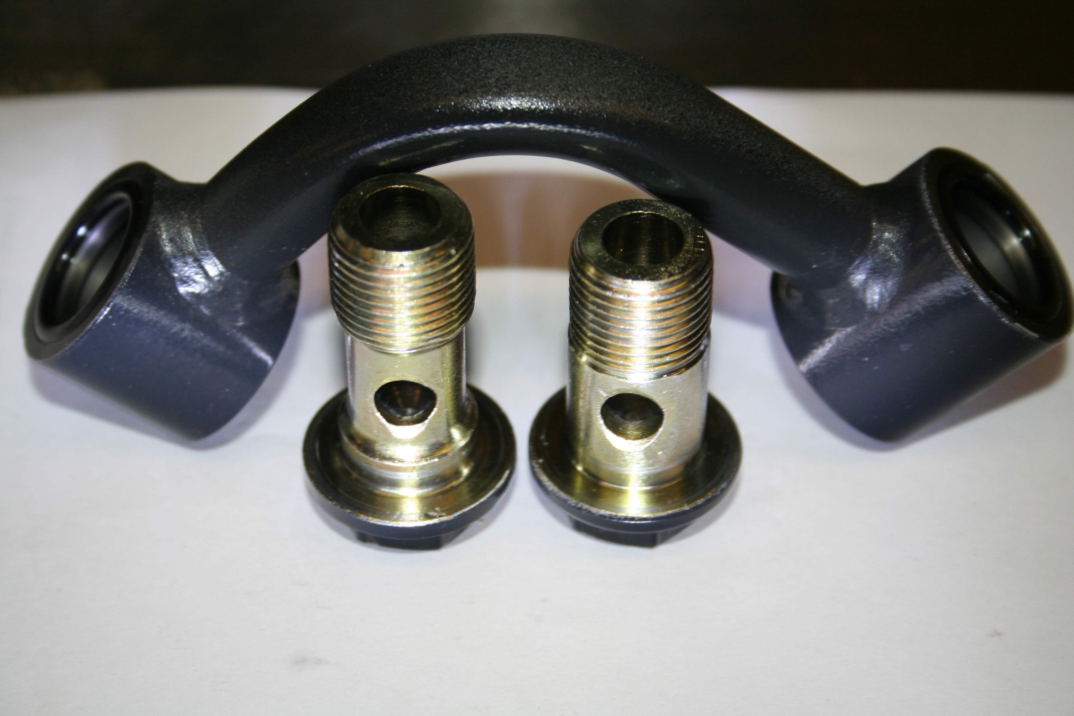

Coyote, I reviewed your postings but don't see a picture of the transmission where the hose attaches. I only see pictures of the parts.
You're correct - Sorry about that- caught up in the confusion and didn't realize it wasn't clear how the parts attached, though I did mention, I believe, that the old U-shaped tube was no longer in use. Anyway, please see my answer to your block diagram question which should make the installation clearer. (The area of the tractor where the hose goes is difficult at best to take pics of - there is just too much stuff obscuring good pics).

So I assume Kioti replaced the 90% hard line (green in the diagram) with a flexible hydraulic hose like what was done on my tractor but add the attenuator hose? There still needs to be an hydraulic line between the HST Filter and the HST's pre-charge port.
I updated the diagram to indicate the HST Pre-Charge port location.

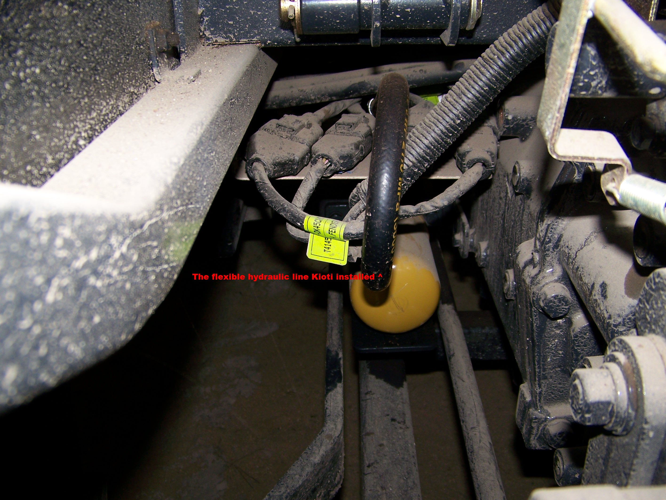

Actually, NO. There is only ONE flexible hydraulic line and it goes from the precharge port back toward the rear diff. The green hard line is no longer used.
I will check it again today-just to be sure, but that is what I saw when I inspected it originally.
Thanks for asking.
/ DK40SE Squeal When Moving in Reverse. #365
I was WRONG! They DO still use the U shaped line from the precharge port to the HST filter. I couldn't see it when I first glanced under the tractor.:eek:
I had to lie on the ground and look up to see it this time around. Before I just glanced under the tractor and didn't see it between the HST and the filter. Since its grey its sort of hard to see because it blends in with all the other grey stuff under there.

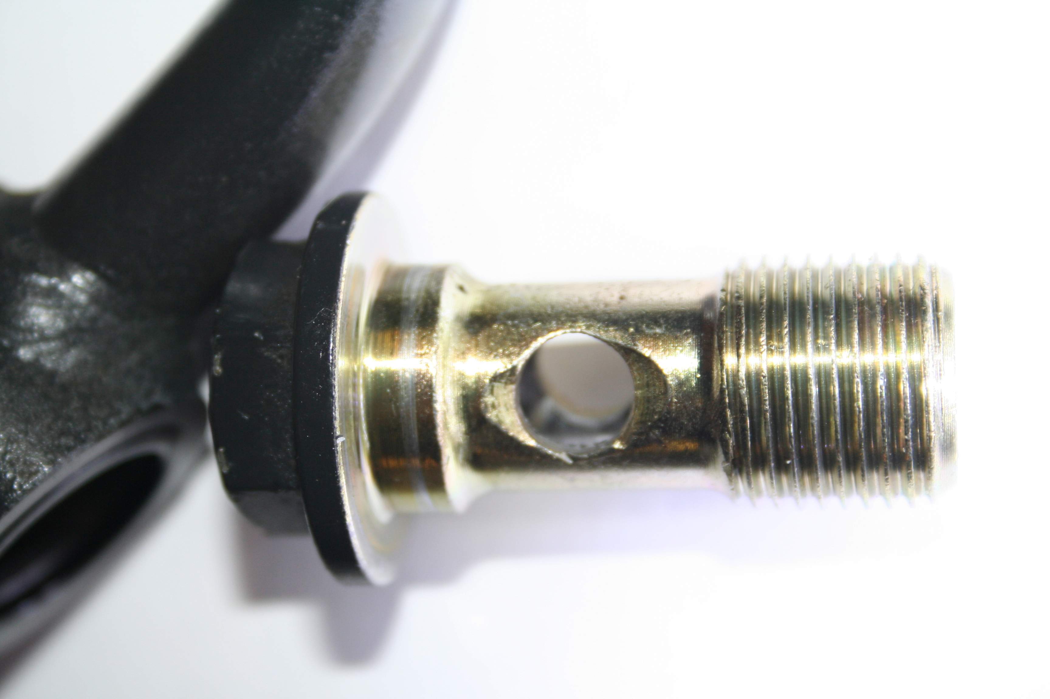

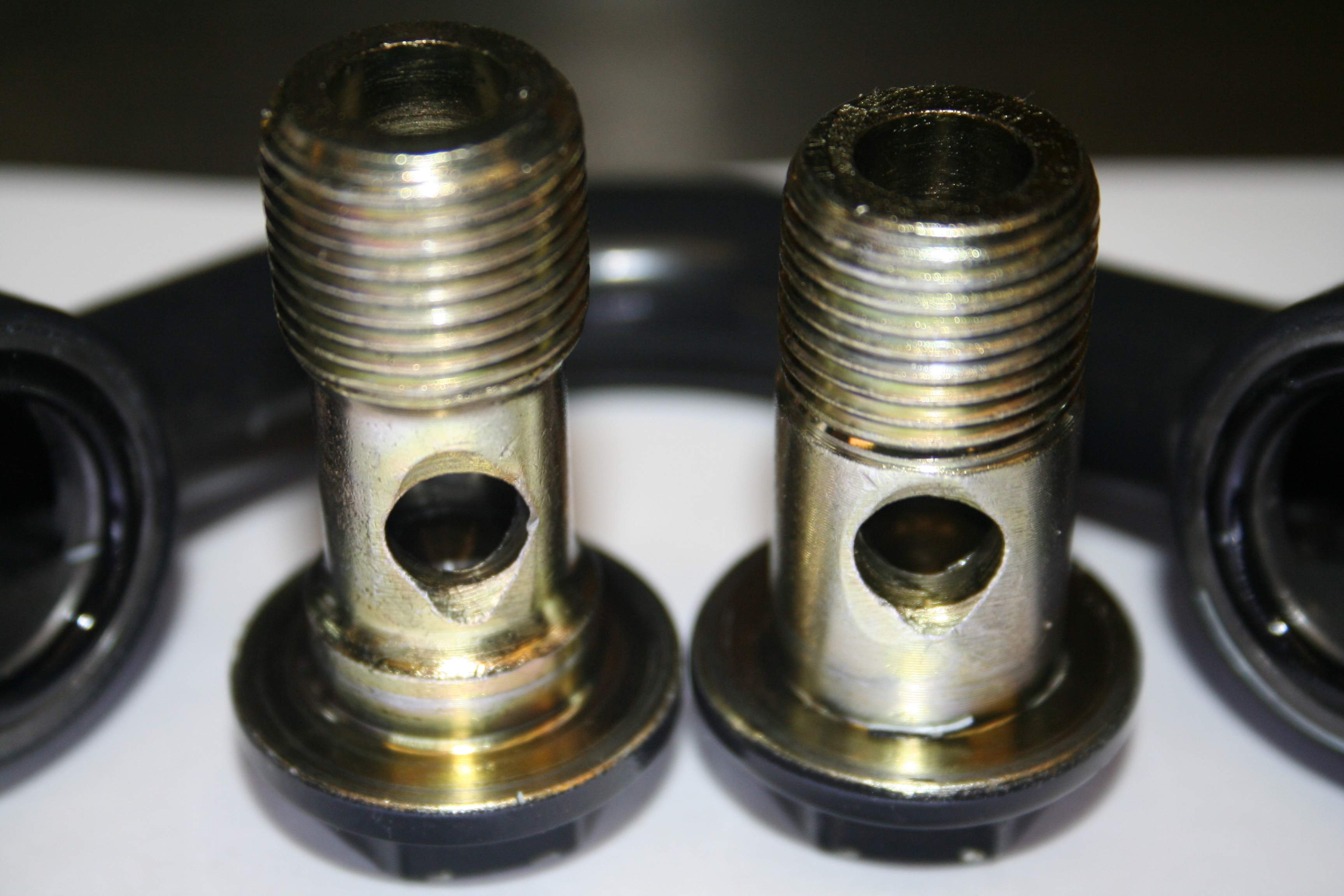

Anyway, the new banjo bolt allows both the old style pre-charge metal, U-shaped tube AND the new flexible rubber hose attenuator to connect to the side of the trans, and everything else stays the same.
Sorry for any confusion, my bad.

To save hauling my dealer delivered the kit for my DK35 yesterday and I installed it this morning.
My kit included the same part numbers as Coyote's for the new banjo bolt and attenuator hose but did not include the cord to attach to the transmission casing. That's fine because I chose to run the hose to the front instead of the rear and it is supported by the structural member for the operator's platform. The hose end rests on the loader mount and below the starter.
I have attached a few photos. The blob taped on the hose is some dense foam padding I wrapped around the hose to protect where it rests on the operator's platform support beam.
It is forecast cool here for the next few days. So I won't know if it fixes the squeal until I get to do some work on some warmer days.
Thanks for your work to obtain this modification Coyote. :thumbsup:
