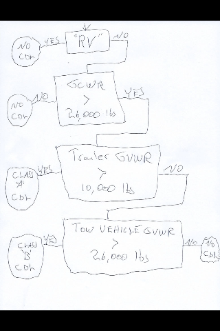

These Pa laws are so hard to figure out, I guess I was under the assumption that 10,001 and over a guy need a CDL or atleast a medical card?
But atleast im sure if I left it a 12K I would need a combo reg for my truck like a class 8?:confused: Right now I have a class 3
Any ideas?

I can't comment on your registration requirements but the CDL doesn't kick in until the Gross Combined Wieght Rating hits 26,001 lbs. ( Except CA)
As far as DOT & Medical requirments, they typically start at GCWR of 10,001. So if you add the GVWR to your truck to the GVWR of the trailer it wouldn't matter if you had the 12k over the 10k

In my post for NY (in quote marks) anyone with a class D (regular drivers license), or B license can haul a trailer over 10K providing the combined vehicle weight is less than 26,000. When towing and the GCVWR is over 26,000 a class A license is required.
In the PA post it says a CDL A is required for towing a trailer with more than 10K. Even their class B CDL is limited to no more than a 10K trailer.
   / DK45S/10k Trailer #30
Your previous post does not mention a Class B anywhere.
New Yorks new rules now fall inline with the Feds standard (You can't pull a 10k+ trailer with a "B" size truck with a Class B license) just like PA does.
Only if the GCWR is over 26k (just like every other state but CA)
These two states CDL requirments are the same as the Feds now.
