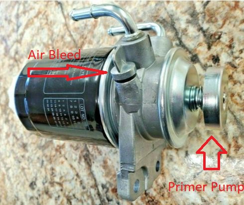

My Also, the 'plunger' that sits on top of (my) fuel filter is not a primer pump (per se); it is an air bleed.
According to the parts diagrams, you should have the following assembly as a fuel filter. The spring loaded plunger on top is a primer to move fuel through the system. The air bleeder is on the side of the casting.

My fuel filter unit looks exactly like the one jimglassford posted. I think the pump on the top helps bleed air out when the air bleed gadget is open, but primes when it is closed. My fuel supply system is pretty much all lower than the fuel tank, so any leaks shouldn't let air into the system...I don't see a mess of fuel leakage anywhere, either. Can relays and solenoids misbehave intermittently? Since the tractor runs well once I get it started, I don't think fuel contamination or plugged filters will be the problem. A glitchy relay or solenoid could act like this, though. I hate the way Kioti seemed to relocated relays from year to year; it is hard to trace wires to the correct relay!
