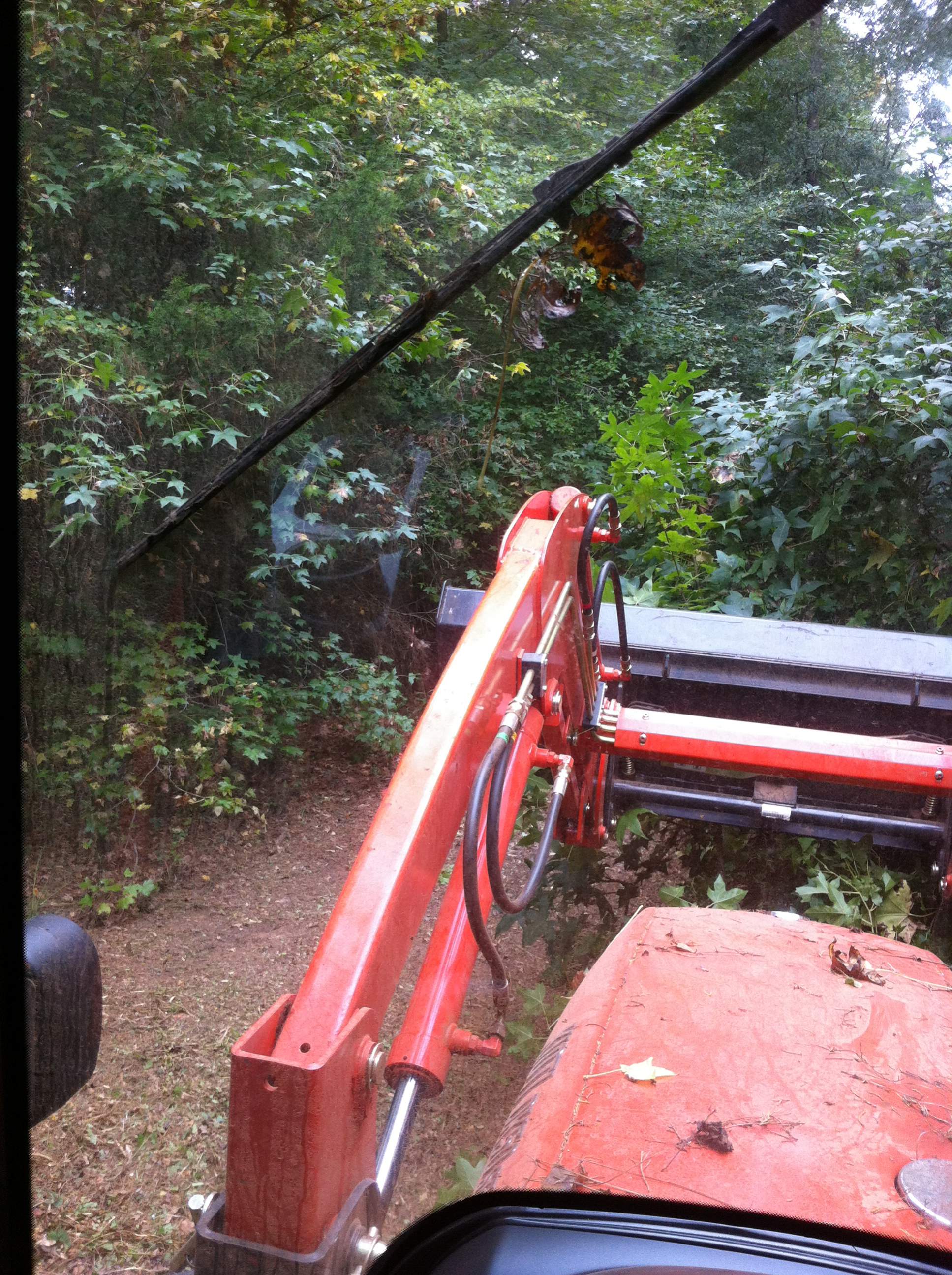

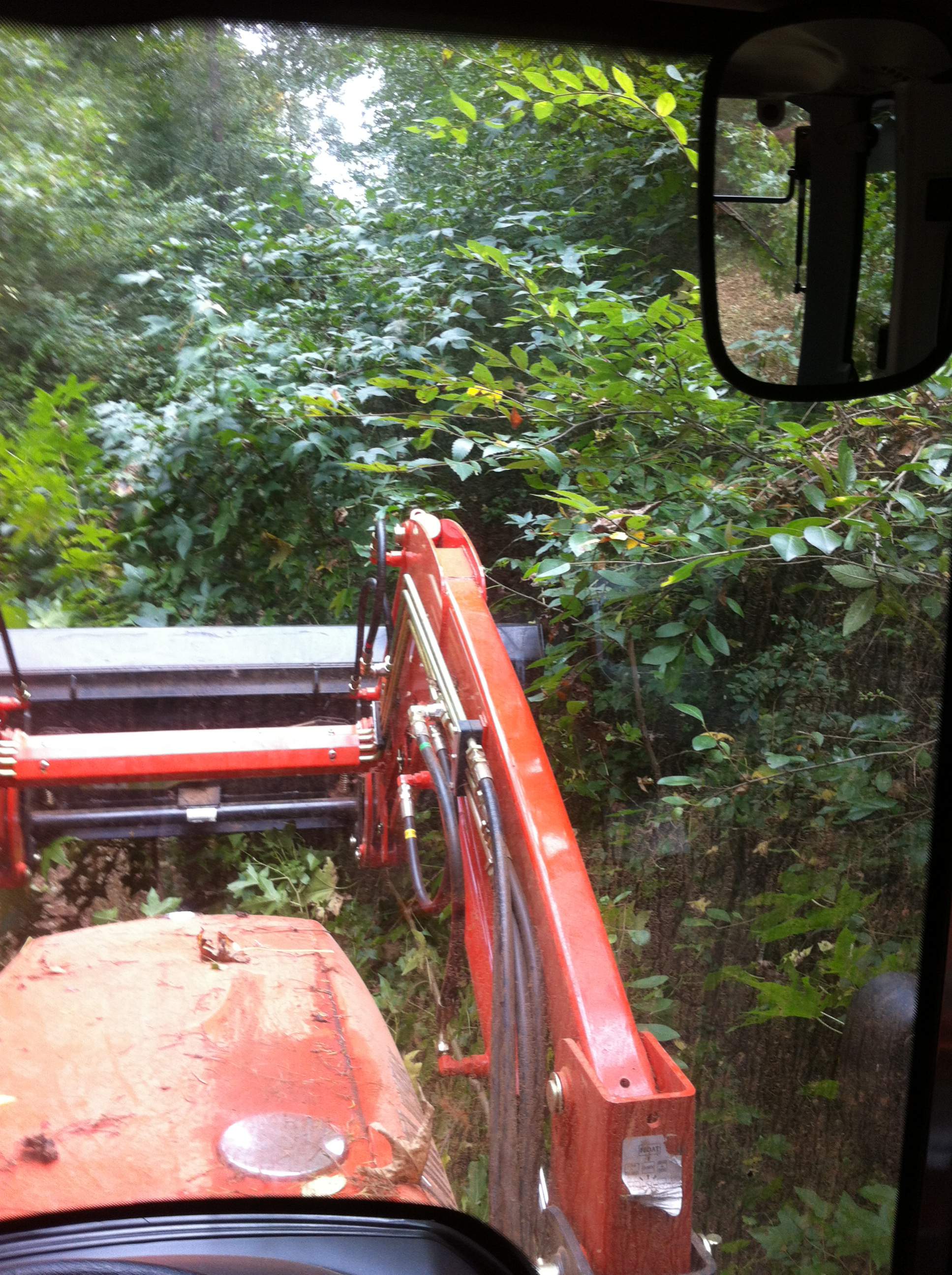

The tractor was delivered Saturday, and I spent some time using it this weekend. Here are some pics of the routing of the hydraulic lines from rear to front:
I need to take the slack out of the one that's hanging down a bit. It's just begging to catch on something. All the lines for the loader and grapple are pretty exposed. I'm gonna have to fashion a guard for that area.

Would having the QDs on top of the tube help things out? :confused3:
That was my thought too. I like the set up. Very neat. However, I would have fashioned that bracket on the torque tube so the hoses and connectors were above rather than below the tube. Should be easy to change that and it would both keep the hoses a little higher, out of danger, and it would allow you to see them more easily so you don't inadvertently let brush jab them.

Another point, you don't show photos of the lines to the grapple but encasing those in a nylon sock will provide both direct protection from abrasion and will also protect against snagging by brush.
