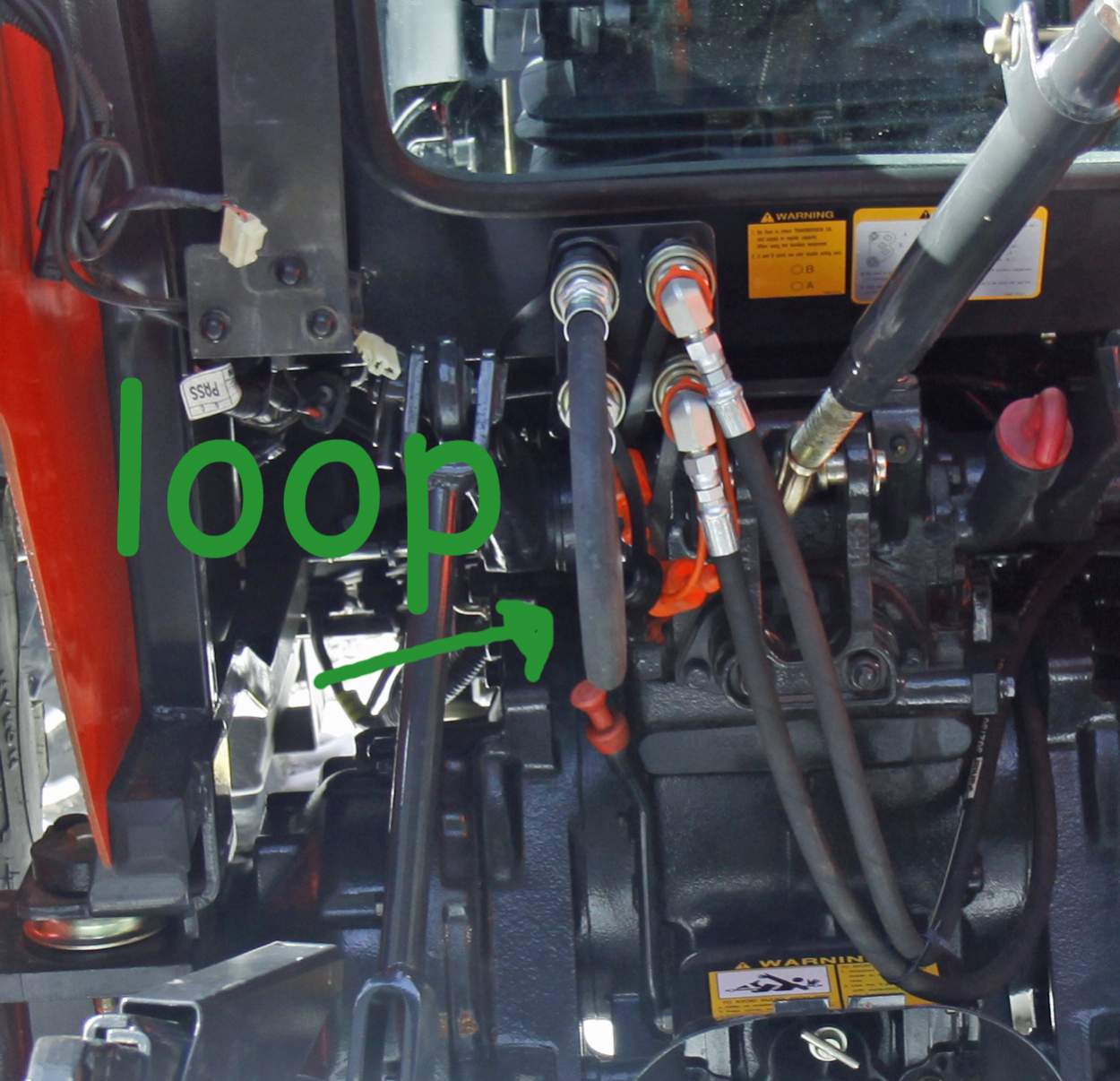

. . . also, a heads up
If you have the detents installed on the second set of rear remotes, think about adding a loop to prevent deadheading the engine and hyd pump if you ever accidentally engage the lever without anything installed. Cheap insurance.
That's a great idea. My 2nd set of remotes does indeed have the detent. I intend to remove the detent asap, but I'll add a loop in the meantime just for safety. Thanks for the tip.
   / DK50SE HST Cab #42
i left the detent in cause i use a 3 point log splitter. cheap insurance...especially as Kioti warranty does not cover deadheading damage
   / DK50SE HST Cab
#43
No log splitter for me. Or anything else that would use a detent . . . at least nothing I can think of. My main use for the 2nd set of remotes will be a hydraulic top link.
