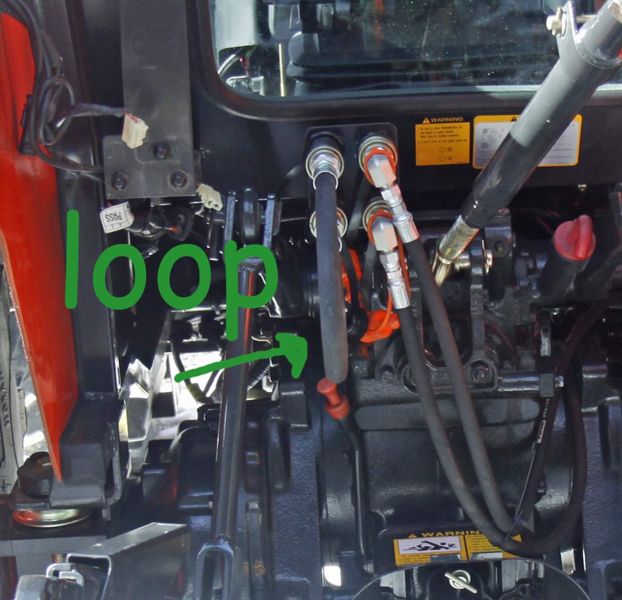

My dealer installed a similar set of lines to the front so i can use my snowplow with an extension handle on the rear ports. I ended up removing the lines and adding a quick disconnect at the same location as the factory disconnects because removal of the loader was a PAIN IN TH *** without the quick disconnects.
I didnt want to pay $$$ for a 3rd function either, and actually have no issues with the way the dealer set it up. Extending the control shafts about 10" really helps...and is easy to do.
also, a heads up
If you have the detents installed on the second set of rear remotes, think about adding a loop to prevent deadheading the engine and hyd pump if you ever accidentally engage the lever without anything installed. Cheap insurance.
