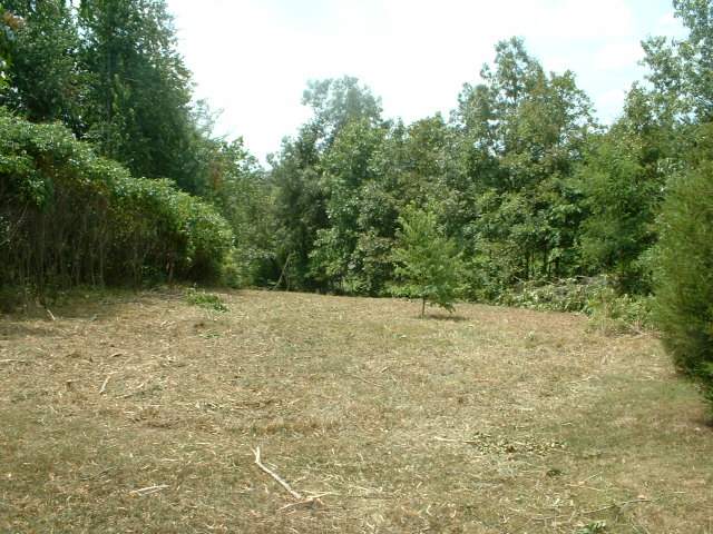

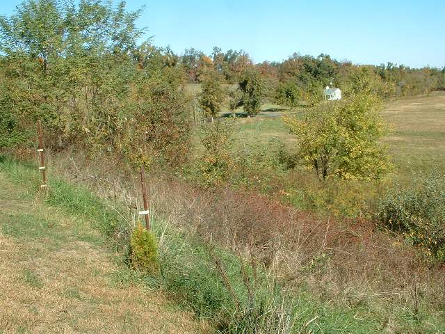

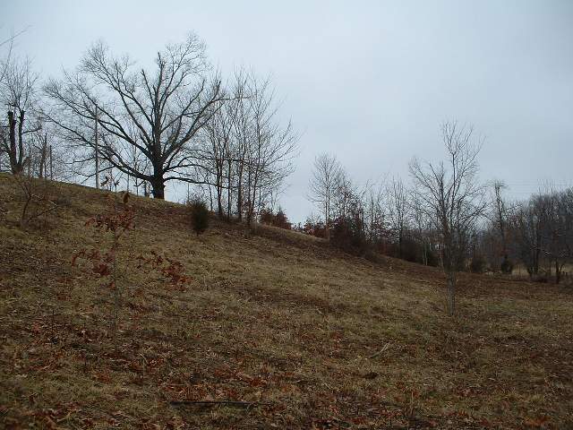

I went from this:
To this:
With this:
Granted it wasn't 5 acres, and it took a while. But it was done.

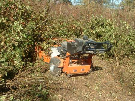

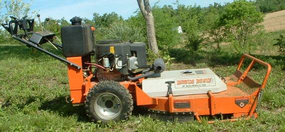

Diggin It - - Man, am I ever glad you didn't ask me to help run that rotary thru your brush. I can still remember breaking virgin land with my brand new 8 Hp Troy Bilt Horse. Better name - Wild Stallion. I EARNED every square foot tilled. I thought that bucking horse was gonna rip my arms right off at the shoulder.
This is 22HP, 36" cut and rated for a 3" sapling. It'll definitely give you a workout, but there is very little, if anything left. If it can get over it, it'll pulverize it to nothing. I had problems with the blackberry and honeysuckle vines getting wrapped across the font like barbed wire. Change the angle of attack, come back at it and it was gone.
