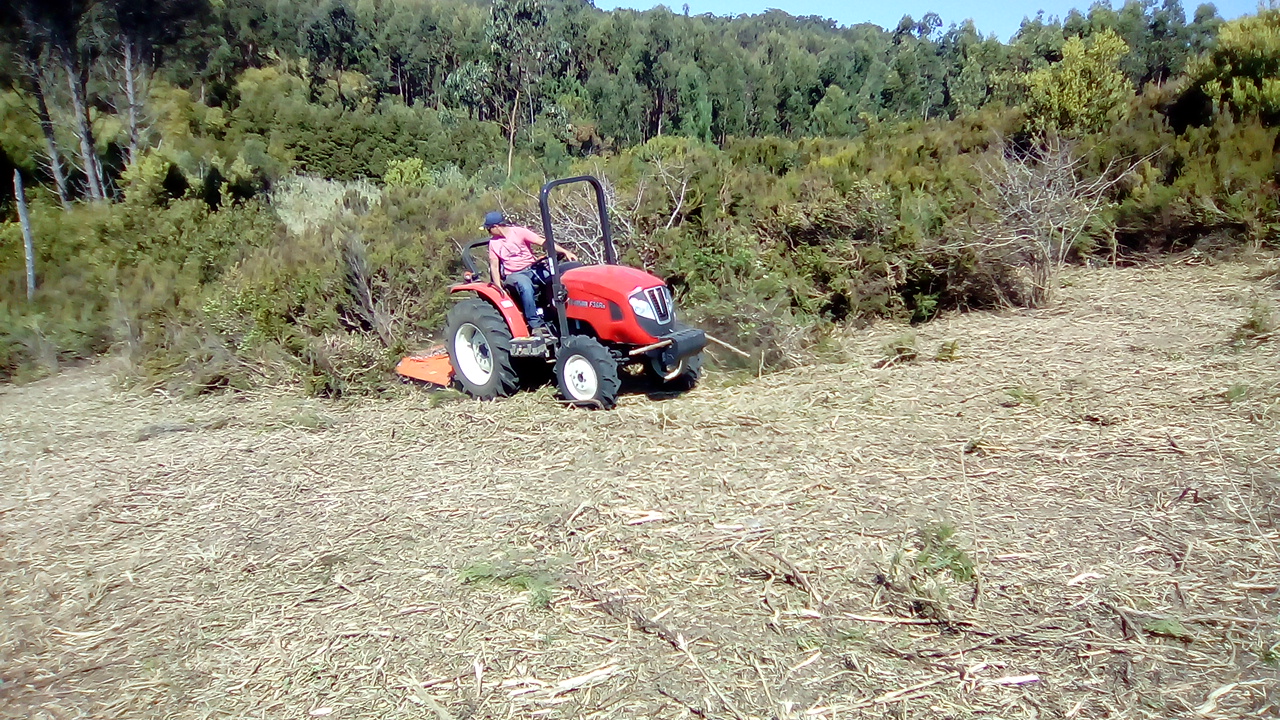

I've done worse with a 35 hp tractor and a 4 foot mower. However, over here, we use high strength chains in the mowers instead of blades, for this exact purpose. Shown in the second picture. It eat more HP of the tractor, hence the small since mower, but it shreds pretty much everything and won't get hurt if it hits rocks.
I've mowed small trees close to 3" in diameter. Taking it slow so I won't break anything.

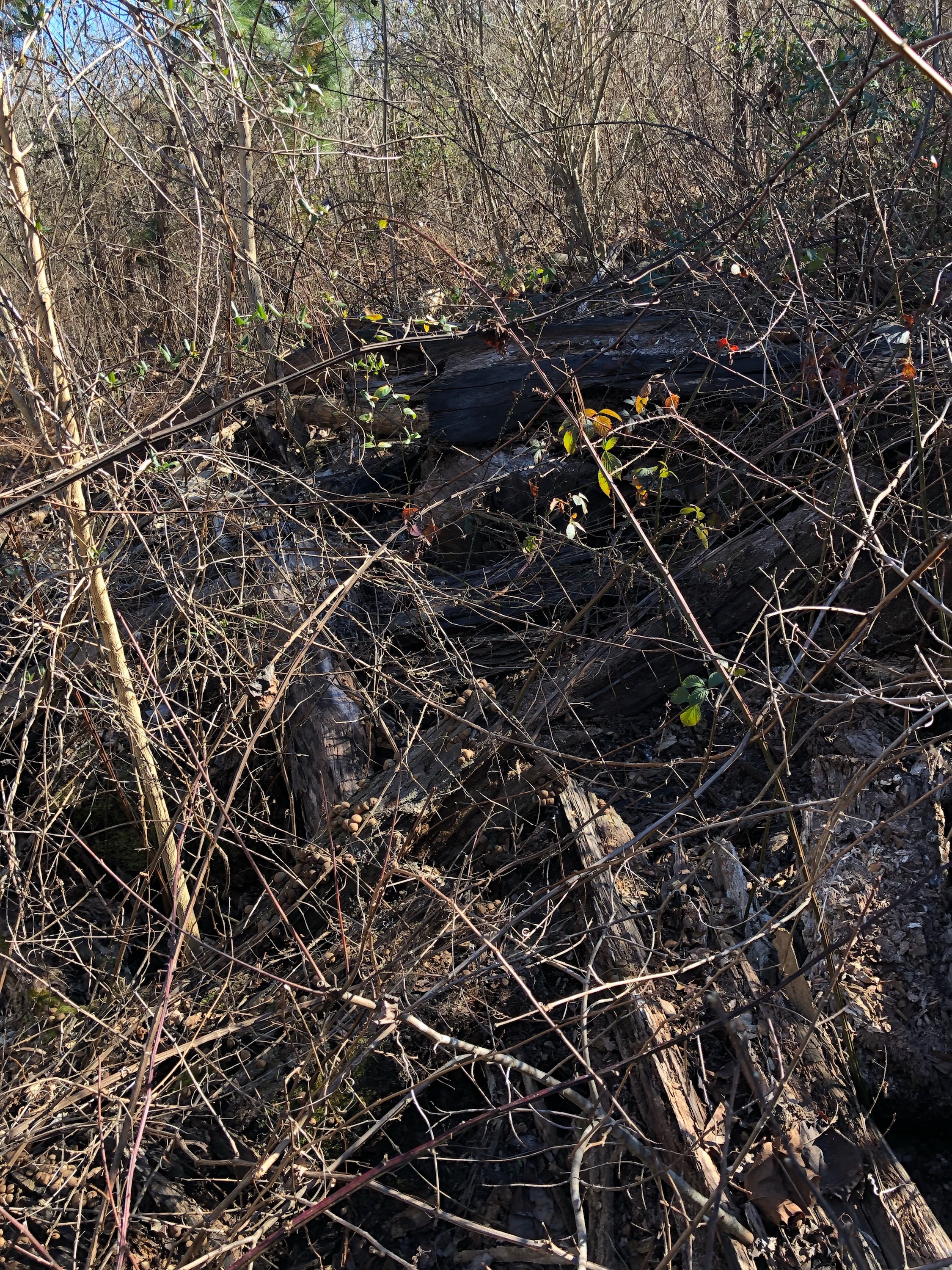

5.5 flat acres of this, ignore the logs in the middle as its the only spot on the property with them. Id love to buy / rent a bobcat with a proper forestry cutter but that just so expensive. One day of rental is $800 locally for the bobcat and cutter. If I can get away with a rotary cutter and a 25hp tractor that would be ideal since we'll have the tractor forever and the bobcat would only be for a few months. Largest trees we could find are 2-3 inches and softwood the bulk of the work would be the stupid vines and such.
That looks super easy with a bush hog. I wouldn't tackle it with a BX but a B series should work, it will just be really slow. Just lower the FEL to about a foot off the ground and let it push over the vines and saplings. Note I said saplings:1-2" diameter, perhaps 3" in soft wood. Just about anything the FEL can easily push over, a bush hog should shred up easily. The small brush should mow easily. When pushing over the larger stuff, just ease your bush hog blades into the sapling which is already bent over so it will cut easily, but the shredding is what will be a bit harder so let it feed slowly. You may even need to raise up the BH and then lower it gently back on to the brush. Just use the speed of the engine to determine if you need to raise up the BH to keep the engine from lugging down.
I cut trees 4-5" in diameter with my light duty Howse bush hog and my 45 HP tractor. Anything that the tractor could bend over would cut and shred. Sometimes it would just shred the limbs and leave the main trunk but I just let them rot naturally from that point.
The biggest concern is that your tractor doesn't have any delicate items exposed underneath, like oil filters and hoses. My Yanmar didn't have anything exposed so there wasn't any worry.
NEVER back up after you have ridden over any brush going forward as this will really gum up the works underneath the tractor.
You can back into the brush but you could bend the sheet metal back into the BH blades (been there, done that) so be really careful that when backing up that you dont run into something to large for the bush hog to ride over without bending something.
Since you currently dont have a tractor, I would suggest that rather than a 25 engine HP, go with at least a 35HP and 40 HP engine would be even better. It will cost a bit more but you gain a lot more weight and durability in the larger frame tractors than you get in the super light 25 HP frame size.
I wouldn't intentionally drive over anything like that without a full skid plate under the machine to protect hoses, tubing, wires, filters, etc.
