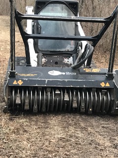

Hired this machine, with operator, at $110 per hour, two hour minimum, $90 move in fee. I did not mind the move in fee because he had to drive 1.5 hours to get to our camp. Does an awesome job.

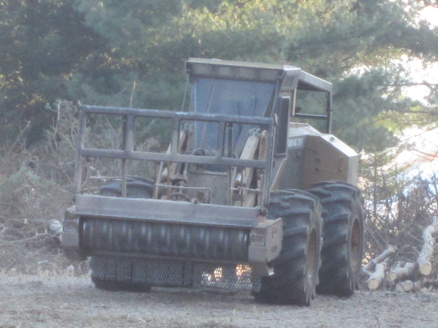

I had 5 acres of dying evergrees removed and they used a Hydro-ax to clean up the buckthorn/mulberry and limbs afterwords.
