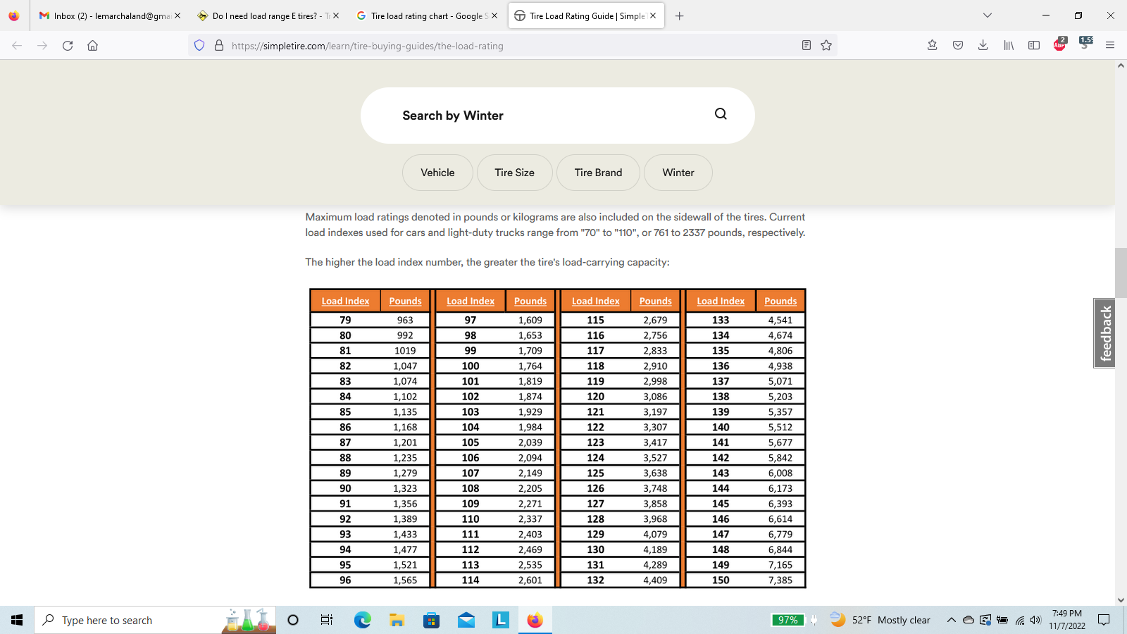

I bought a used Nissan Titan about 5 years ago. The OEM tires were shot and I got a decent price on some load range E all terrain tires and that is what has been on the truck since then. They have been great in terms of towing and okay off road (about what you would expect for an all terrain tire). The highway ride is okay but on any bumps or irregularities it is harsh and it even makes the steering jittery over rough hard top.
This truck has more flaws than strengths but it could be that its the tires and not the trucks fault in this particular issue. When not towing I keep the recommended 35 psi in them. Depending on the tow load I might put as much as 60 in them but usually 50 psi. They are rated at 80 psi.
Now they are getting close to needing replacement and I'm wondering if I need load range E tires.
The truck is rated at 9000 pounds towing. My 19 foot trailer is rated at a total weight of 7500. I occasionally pull that much but usually closer to 5000 is my typical load.
So my question is, can I get by with load range D tires? Are they likely to ride any better?

You can get by with standard load tires, B or C range, of course now they are all load index rated;
A decent article on tire capacities and such,
https://simpletire.com/learn/tire-buying-guides/the-load-rating

Thanks. That is helpful.
