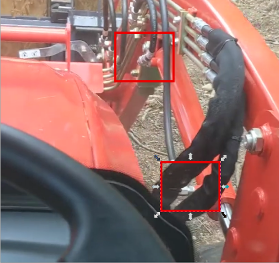

Swapping out the upper cylinder on my Kioti DK6010SE. Curious if those hydraulic hoses sealant or not.

Not sure how well these can be seen in this picture but these are the two fittings.

NPT(pipe thread)needs sealant(not teflon tape),tapered threads do not(metal to metal).

Tapered threads need something, tapered seat fittings (SAE/JIC) do not need sealant, and if there's O rings then those do not need sealant either.
On tapered threads tape is fine if used CORRECTLY which most people don't do, the tape should start one thread back so none get into the medium inside... Thread sealant is a lubricant and a sealant so it covers both but some people use tape and sealant...

The hoses themselves are self sealing. Usually they have 90 degree fittings that screw into the cylinders. Some machines have O rings on those fittings but pipe thread that requires sealant is more common.

Just went for it. The existing fittings didn't have sealant. There was also an o-ring inside so i think I'm good with just tightening.
Thanks everyone

The 90 degree elbows threads into the boss on the cylinders, then the nut, is actually a jam nut with a o-ring inside. This provides the sealing of the fitting and also allows you to rotate the 90 degree elbow to whatever position you need.
The hose seals on the elbow using a taper.
No need to any sealants on those fittings.

Loctite 545 (purple) is for NPT hydraulic threads. Only NPT fittings need anything. It isn't required to use, but helps stop any small leaks or weeping. Cylinder fittings are often NPT, but not always
