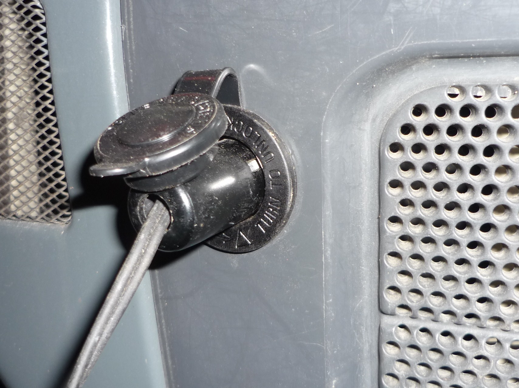

I have this one:
Amazon.com: Battery Tender 022-0150-DL-WH Waterproof 800 Battery Charger: Automotive
It comes with ring terminals and clamps. Just took the battery bolt nut off and slipped the ring terminal over it and put the nut back on. Tighten everything up and shove the batter back in the compartment. On my BX I have to open the battery cover each time and connect the charger. I bought the same charger for my Dad's JD2440 and installed the same way. There's a gap big enough on the battery door that we just leave the cord hanging out. It prevents the tractor from having to be jump started every time we use it.
The way these things work is they will only output up to whatever the rating of the maintainer rated at. All the time they are monitoring the battery and when it gets "full" it just keeps checking and adding a little bit as the battery naturally discharges. Also, when keeping a maintainer on your battery it keeps the battery "in shape" by preventing buildup on the plates of the battery.
If you have a really big battery and need something bigger than the 800ma I think I saw ones that go up to 3A that were sold at NAPA auto parts.
