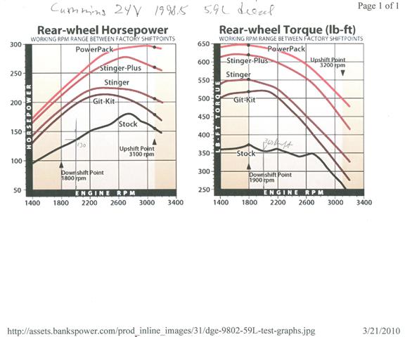

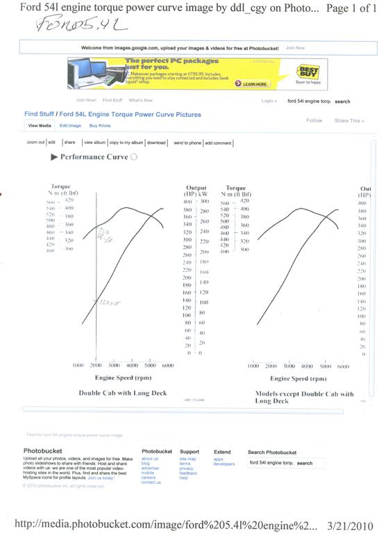

For example, I need to tow my parade tractors (one at a time), which weigh up to 4500 lb. The towing will amount to less than 4000 miles per year. After looking at 1T diesels and 20ft GN trailers, I'm pretty much going with a 3/4T gasser and an 18ft bumper pull car hauler. Lately I've been interested in the F250 with the 3-valve/cyl, 8 cyl 5.4L Triton gasser. I know many folks think the 5.4L is a puny engine for serious towing. So I tried to educate myself on that score.
I found the torque power curves for the stock 3V 5.4L
and for the much prized 1998.5 24V Cummins 5.9L turbo diesel (stock). Cummins, of course, is by far the preferred diesel engine for 3/4 and 1T PUs and the 24V enjoys an impressive reputation.
Diesels are touted for their low end torque (the grunt in towing), so I looked that these two engines at 2000 rpm. Interestingly, the hp and torque numbers are nearly the same
130 hp and 350 lb-ft for the Ford 5.4L
and
130 hp and 360 lb-ft for the Cummins 5.9L
Remember, that the Triton is a normally-aspirated, fuel injected engine while the Cummins uses a turbo to get its numbers.
Sure, the Cummins gets better fuel mileage and you can tune that engine to nearly double the hp and torque. And the resale value is better for the diesel, yadda, yadda, yadda.
But I'm only interested in doing a pretty simple towing job and can't justify the extra $5-6K for the Cummins and I'm not interested in performance enhancements. Stock engines will do my job fine.
Moral of this story: you need to do some legwork to get to the bottom of things.
I hate to tell you,but those numbers on paper mean NOTHING.They do not translate to the real world.Diesel fuel burns slowly,when the fuel ignites,its initial bang isnt all that big,but it is pushing on the piston the whole way down the bore,unlike the quick "bang" of power pulses from a gas engine,quick,and its over.......this is where the torque of a diesel comes from....a cummins has almost 400ft lbs of torque at idle....the power ratings are low,it is underated.The 5.4 is a fine engine,but in no way does it even come close to having the towing capability or effortless pulling power of a cummins 24V....Im sure a 5.4 will work for you just fine,but please dont ever,ever think you've got the equal to a 24V cummins because a power curve on paper says so....
