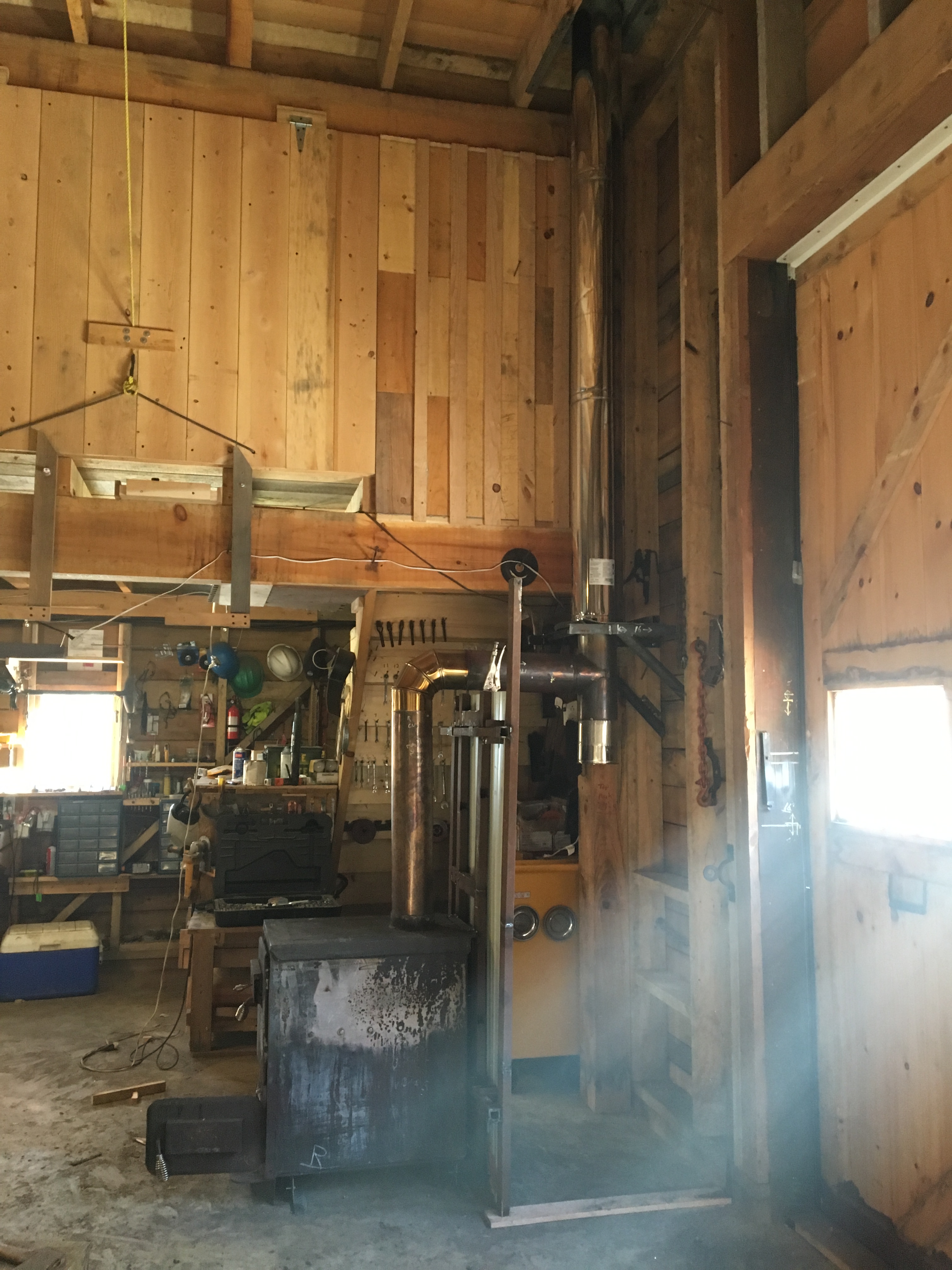

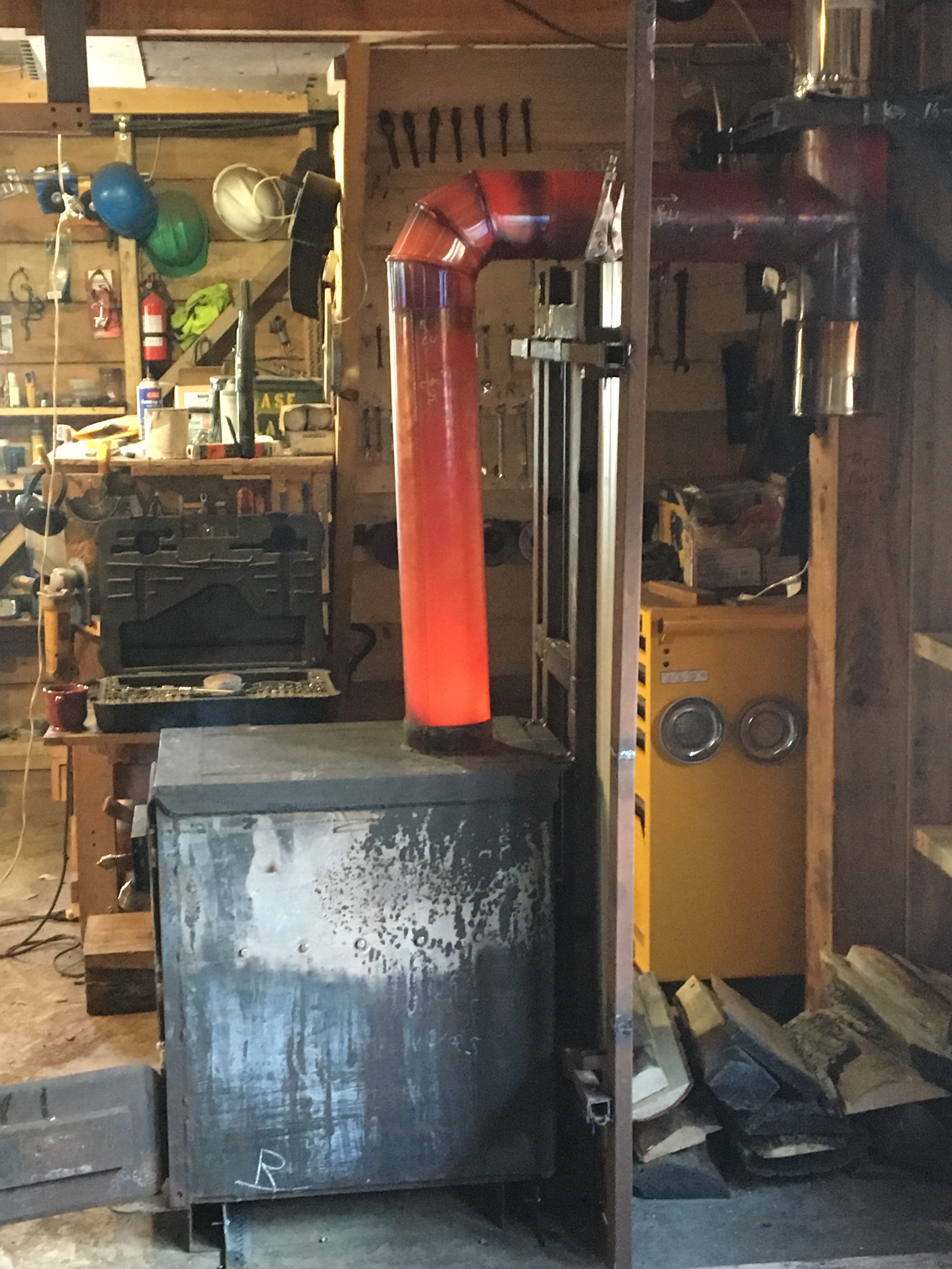

I call it a chimney pipe success, fire started a little slow, but after a few minutes, started a little hotter, then I cut some sawmill slabs up that I've had bundled up in 2x2x8.5-ish, they've been sitting for 3 years, loaded up the stove with them and things really took off, none too soon either, in the teen's today. Now I'm glad I didn't go that high with single wall stove pipe.
   / Do we need a warm garage.... #85
That would have freaked me out!!!!
If you have one of those laser heat sensor guns get a reading on that if it happens again!!!

I was gonna give you a quick response on the chimney temp. But my battery is dead on my laser. I'll get back to you on that.
My concern to a glowing "tin" chimney flue would be that if it in fact does get hot enough to sag/droop and come apart you will immediately have a disasterous result.
I use a homemade heater reclaimer just above my stove and then tin chimney for 5' to an insulated flue thru the wall. I've had my stove so hot you couldn't get within 5-6 ft of it but my chimney has never glowed. That would freak me out....... But I might be overly paranoid after losing a shop to fire 7 years ago.
