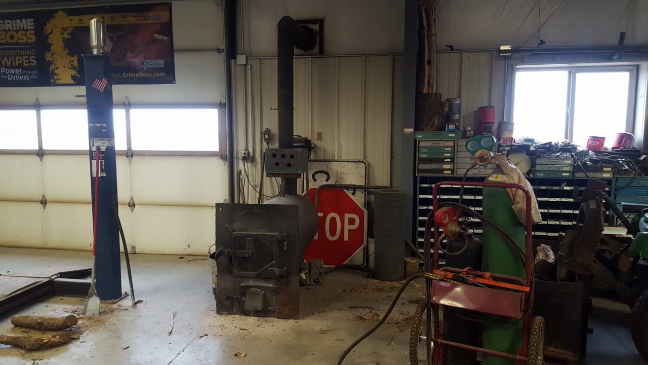

Oldpath,
Just curious why you didn't run your single wall up about two more sections of the double wall and put the transition up there. That would have saved on the cost of the double wall and put more heat into the room from the single wall. The transition at the double/single interface, with the nice shelf you made, could have been a straight transition to sweep the whole thing down to a TEE behind the stove. Just curious.
Nice looking installation.
It only took me 6 hrs. to make up my mind on how high to start with the double wall pipe, looking at it now I could of easily started 3' higher/one section/$85.00, and your right, could started 6' higher and saved $170.00, but when my said he had a 4' section of SS pipe&Tee, I measured from that and just buy the Elbow $38.29 and Cap for the TEE $23.84, but tomorrow when I light it up, if there's not enough draft might have to buy another 3' section.
