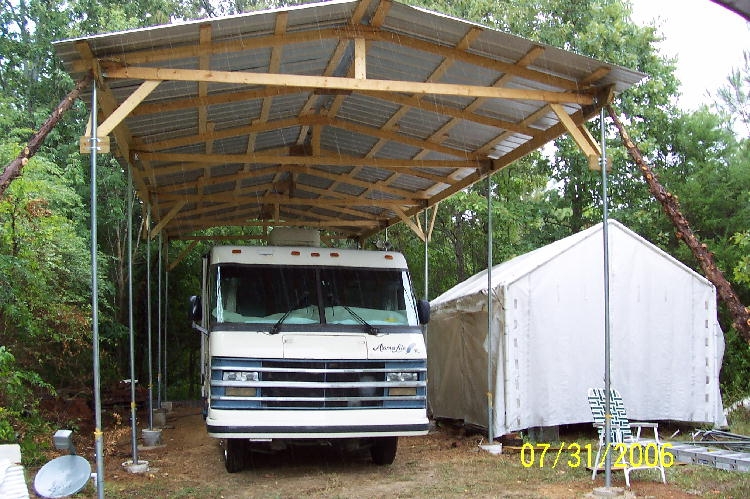

Guess I posted this wrong
I built this in 2004 by myself and it is still standing.
The cost was around $450, short pipe 2 1/2" in 5 gal buckets filled with concrete with holes in the bottom then I think 2" pipe inside them. A bolt was put in the base of the 2 1/2" pipe with a line level at each pipe, another bolt was drilled through both pipes as an anchor. I calculated no more than 33lb load on each pipe 50ft long 14ft wide.
I really had no idea what I was doing and really planed on this as temporary until I could have a barn built.
Never got around to having a barn built.

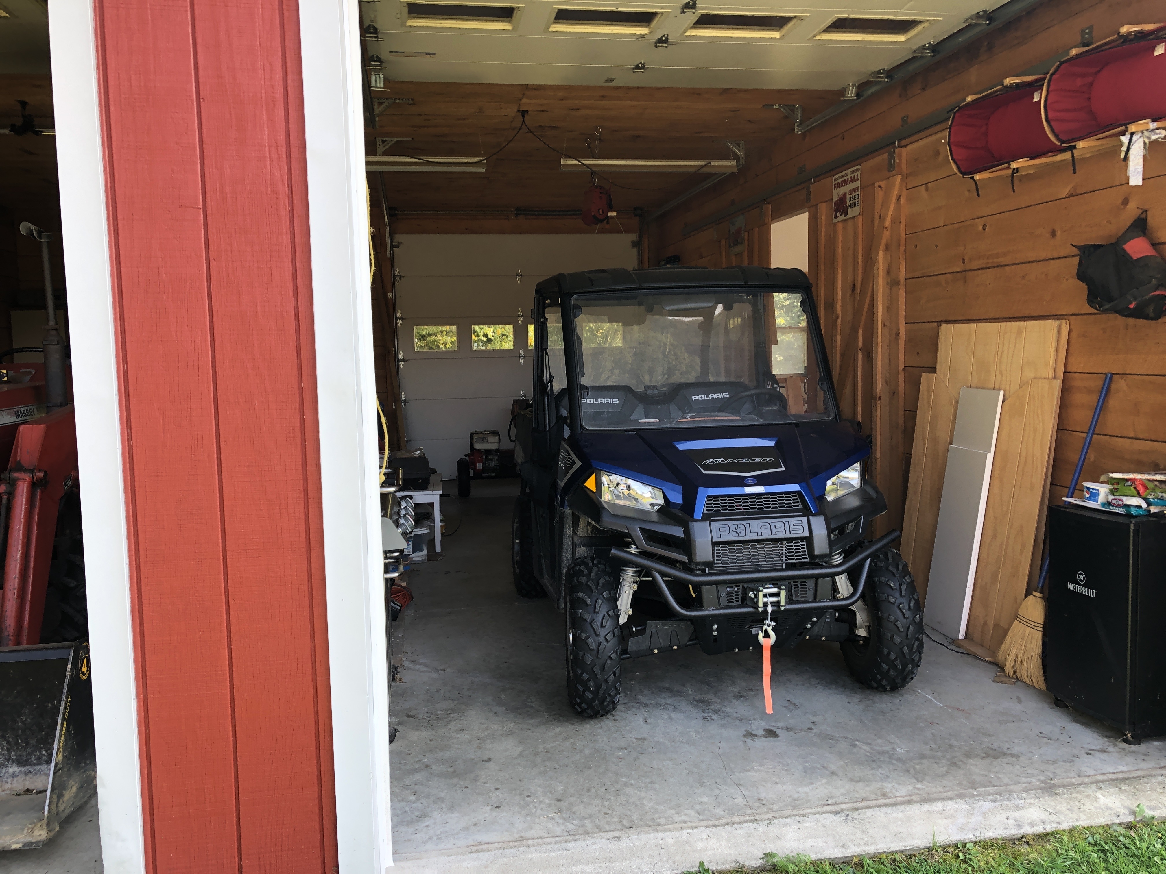

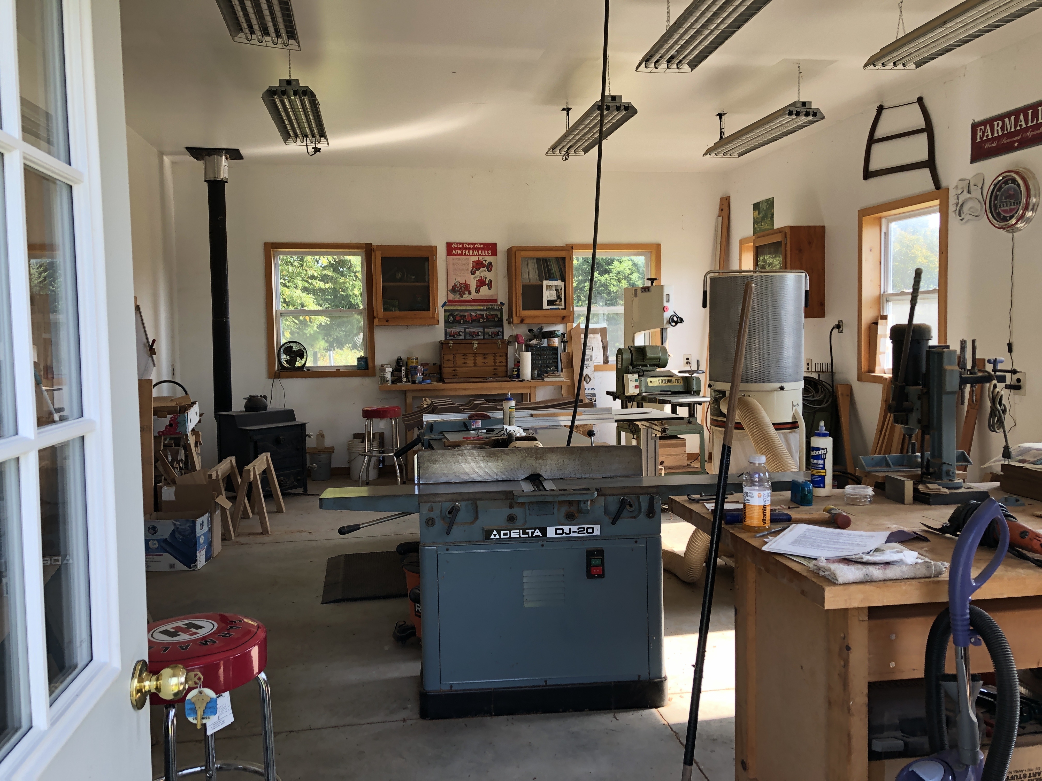

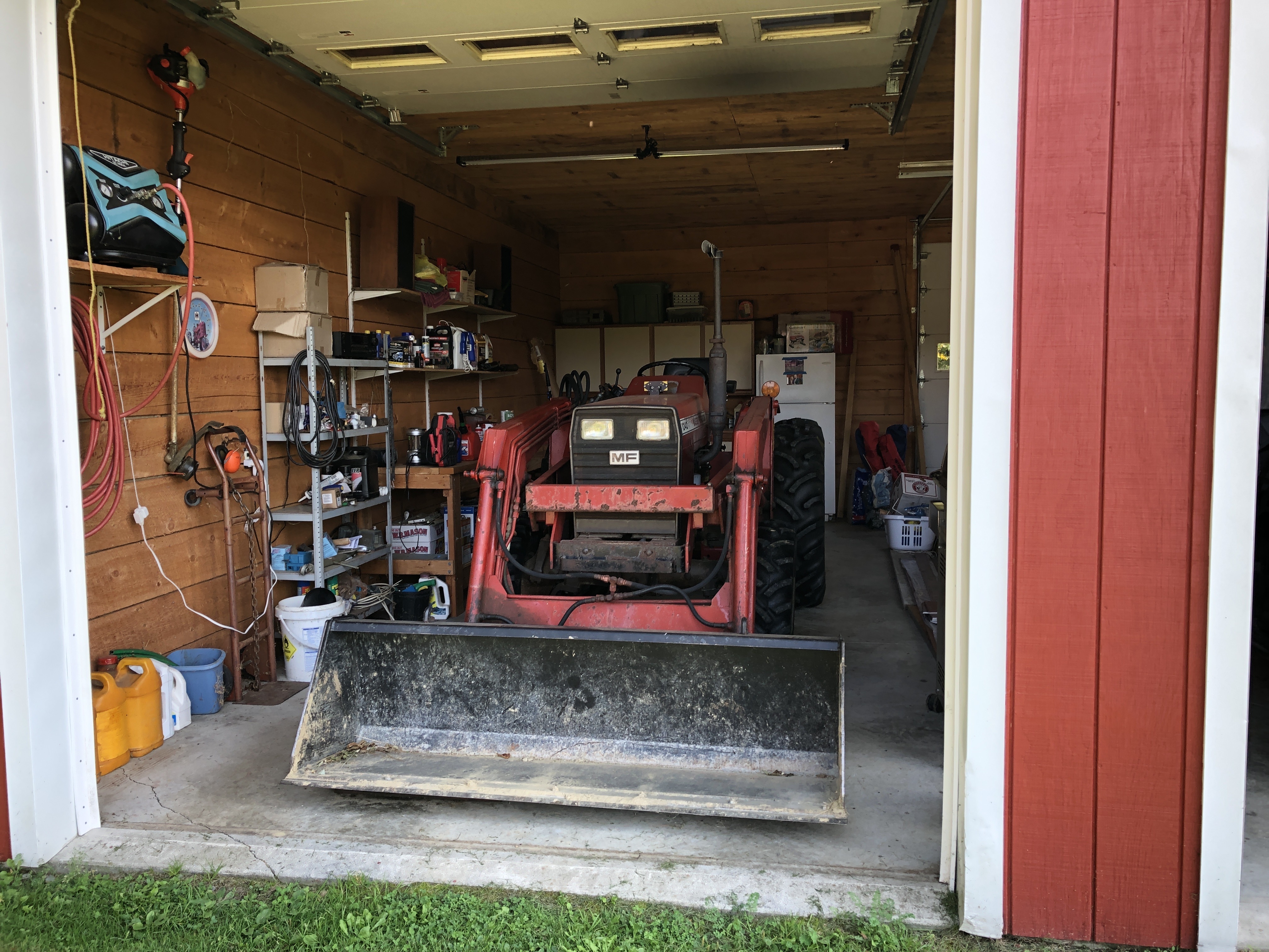

Yes, back in 2010 months put up a 28’x 44’ barn. One drive through bay in the middle ! Tractor storage, Polaris Ranger , log splitter and the front side of the building is my wood shop ! Wish it was a bit bigger but that’s what I could afford at the time ! 😉

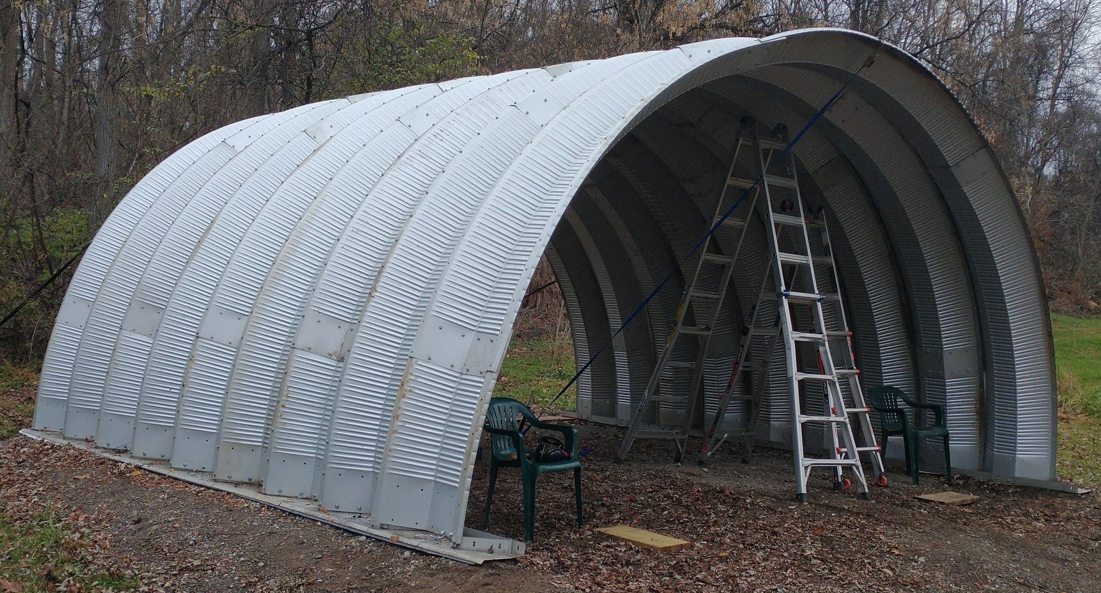

I put up the final arch this morning, 9 total for 18', 20' wide. Ends and barn doors next.:)
Dirt floor = damp interior and rust, once enclosed. How do you plan to ventilate, if you're closing in the ends? I understand wanting to keep rain and snow out, but I'd want to ensure substantial airflow, to keep interior dry.
