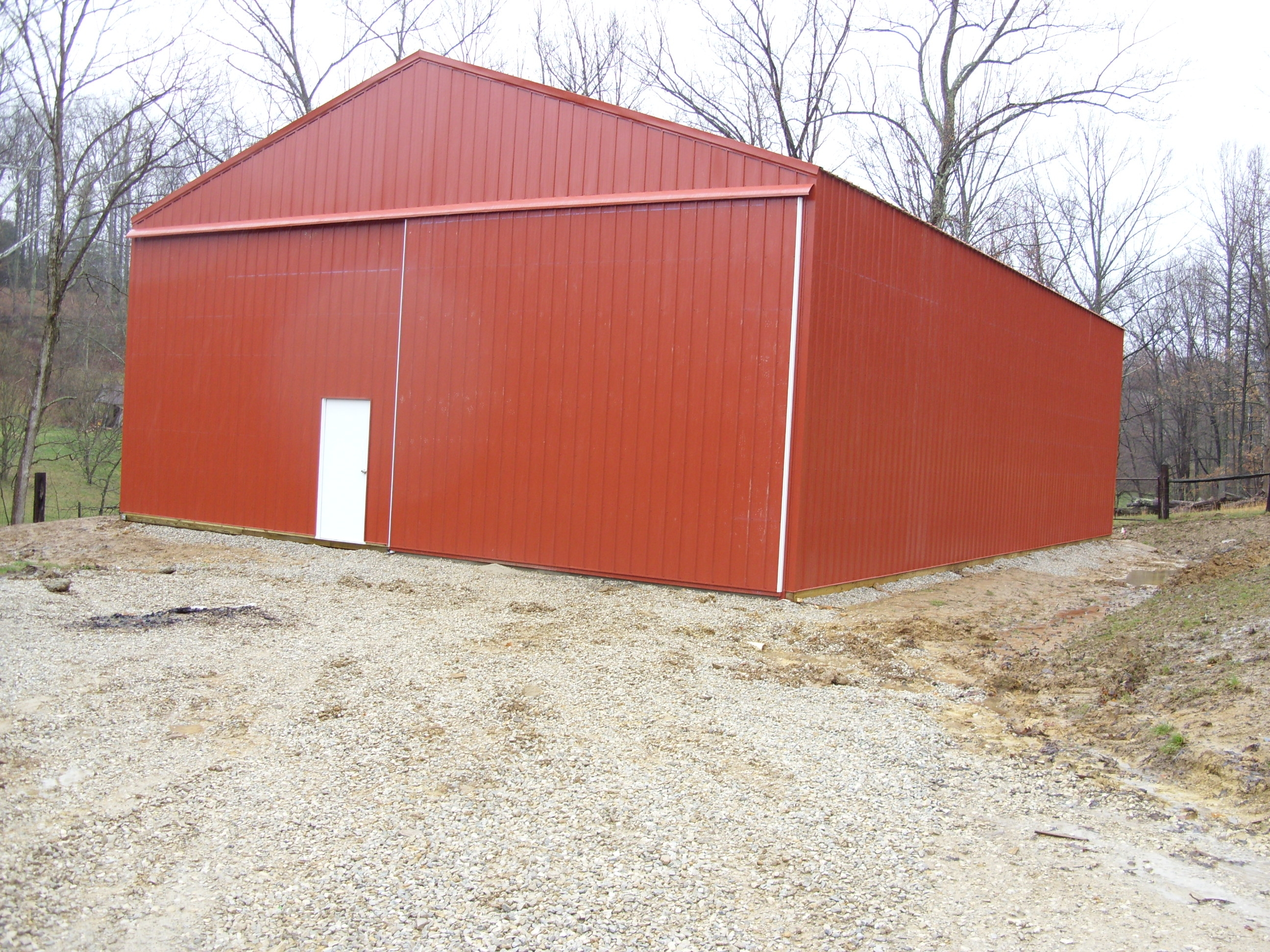

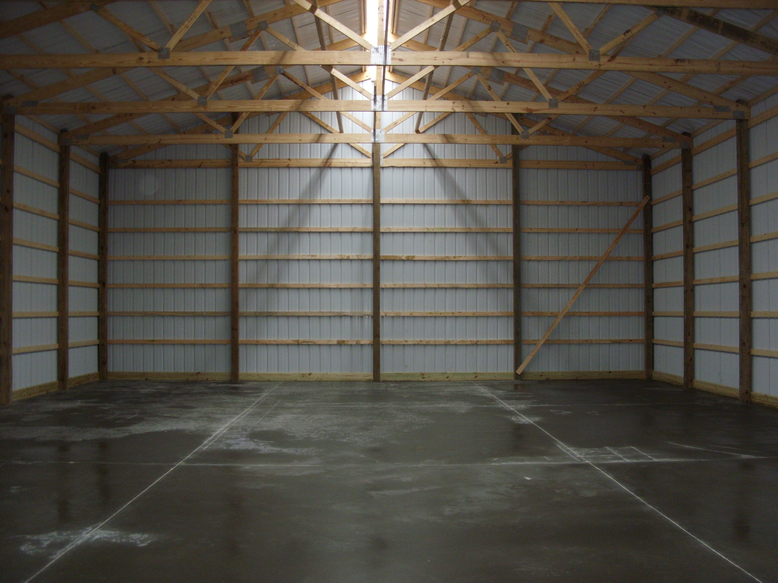

   / Do You Have a Tractor Shed/Barn? #226
60' x 40' x 15' w/ concrete floor. sliding door is 20' x 14' built by Davis County Metal Sales. Ridge skylight.
