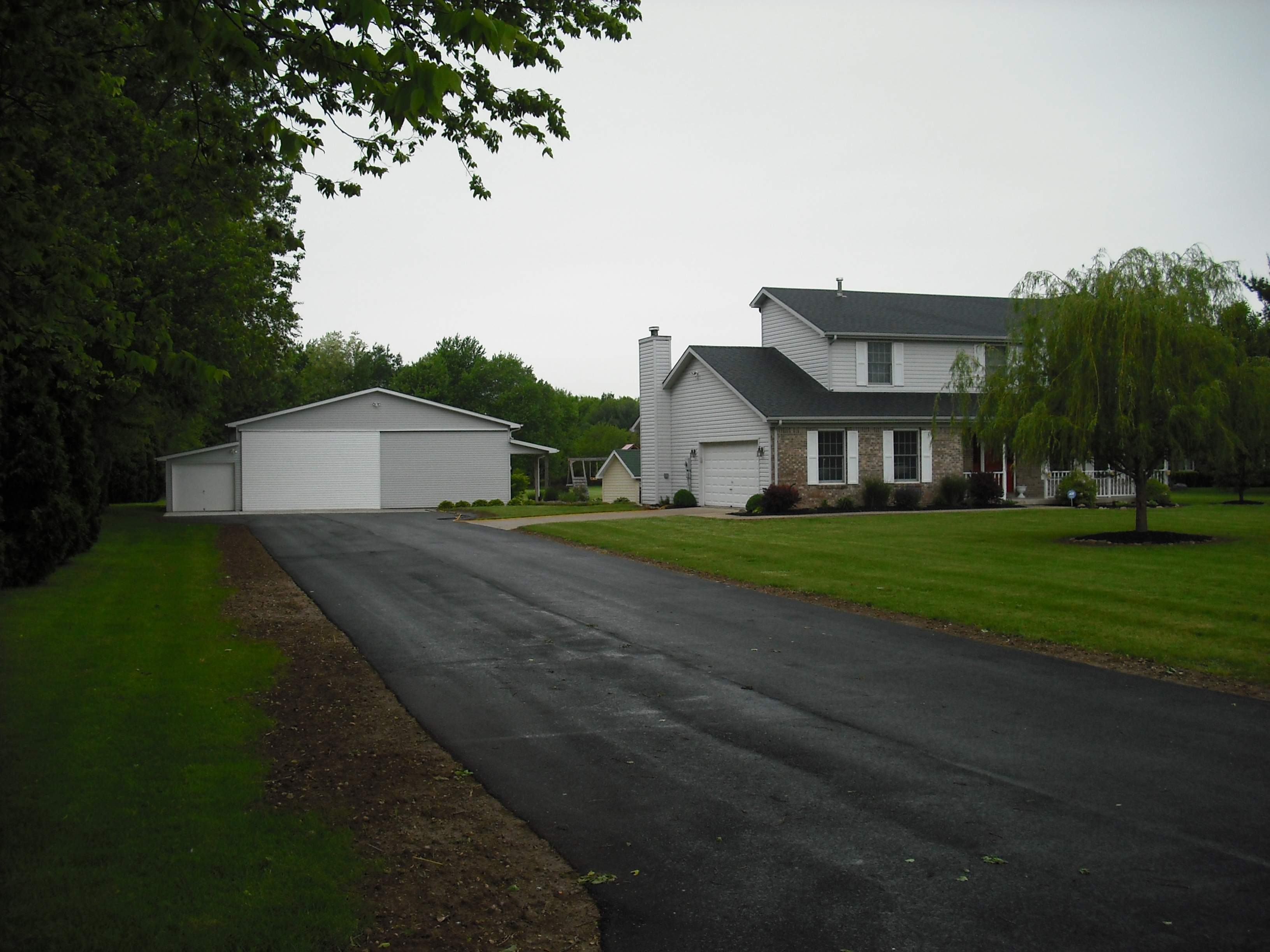

I just went though this. I had a 6" deep 40x16 concrete slab poured in front of my barn and had the rest paved. The pavement was 2" of 8D base and 1" of 12 top coat. Its been down for a month so only time will tell. I can not remember the length but its 4,600 sq ft worth according to the invoice.
The guy who did mine did my dads in 1981 and it still looks good. He has had it sealed every 4 years. Same for my neighbors. They have been in the house for 25 years and it was done when they moved in.
Here in Indiana we have a full gamete of weather. Highs around 100 in the summer and lows around -20 in the winter. Yes there is a few cracks but filling it and sealing takes care of that.
