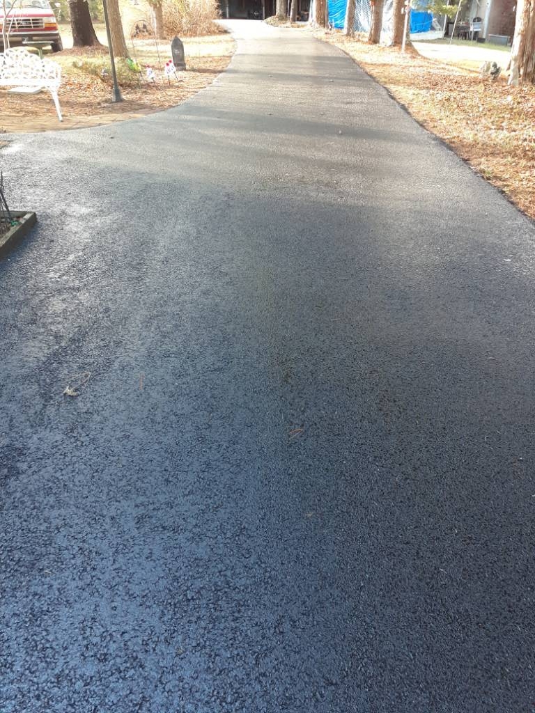

I had it repaved a year ago, drive a bit wider so 8,500 sq. ft. picture shows close to end near house. $24K. I recently had it sealcoated $6,500 what original paving cost. It's the best thing I ever did. The house floors stay clean, no gravel dust. We roll carts on it almost daily. Unless we get over a foot of snow I hand shovel...it's so easy.

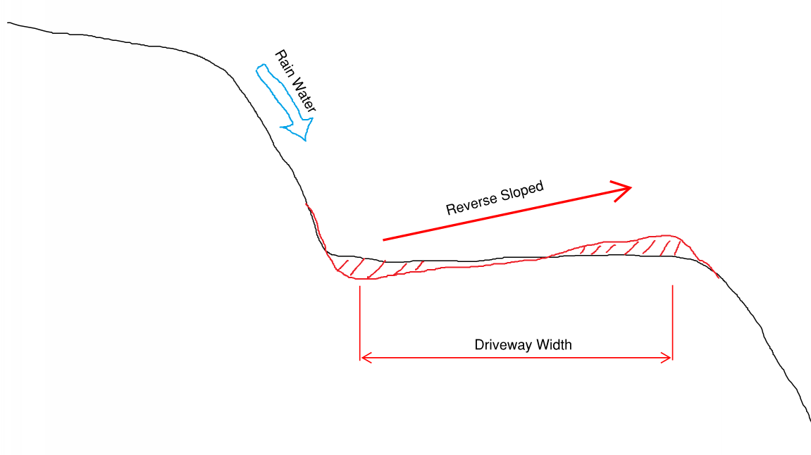

A crown or an inverted drive (minor V) to channel water either off the drive or channeled down the center, to where you have drainage structures. I prefer a crown, unless there is a good reason to capture the water.
On a 10feet road running parallel to a mountain, would something like this work?
   / Prices on driveway paving #49
Yes. Two or three points to think about though.
That ditch on the uphill side; if it's a long continous slope, your going to need to control water velocity, with ditch block, rip rap, disapator blocks, ect, or your channeling a huge volume, and velocity of water into a very narrow area, and will have erosion issues
The down hill side; your gonna want the area of improved road to extend beyond your wheel path, and then stabalize that with some kinda vegetation, ie seed and straw.
Depending on your landscape, topo, ect, you might need to get that water from your hillside ditch to the other side; so that means pipe (or a concrete lined swale crossing the drive). If you use pipe; go bigger and longer than you think. Dont use 4" flex pipe; I'm talking about an actual culvert. You want atleast 4-6 ft from the edge of the cross drain to the driving surface. No fun to find the edge on a rainy night with a trailer...

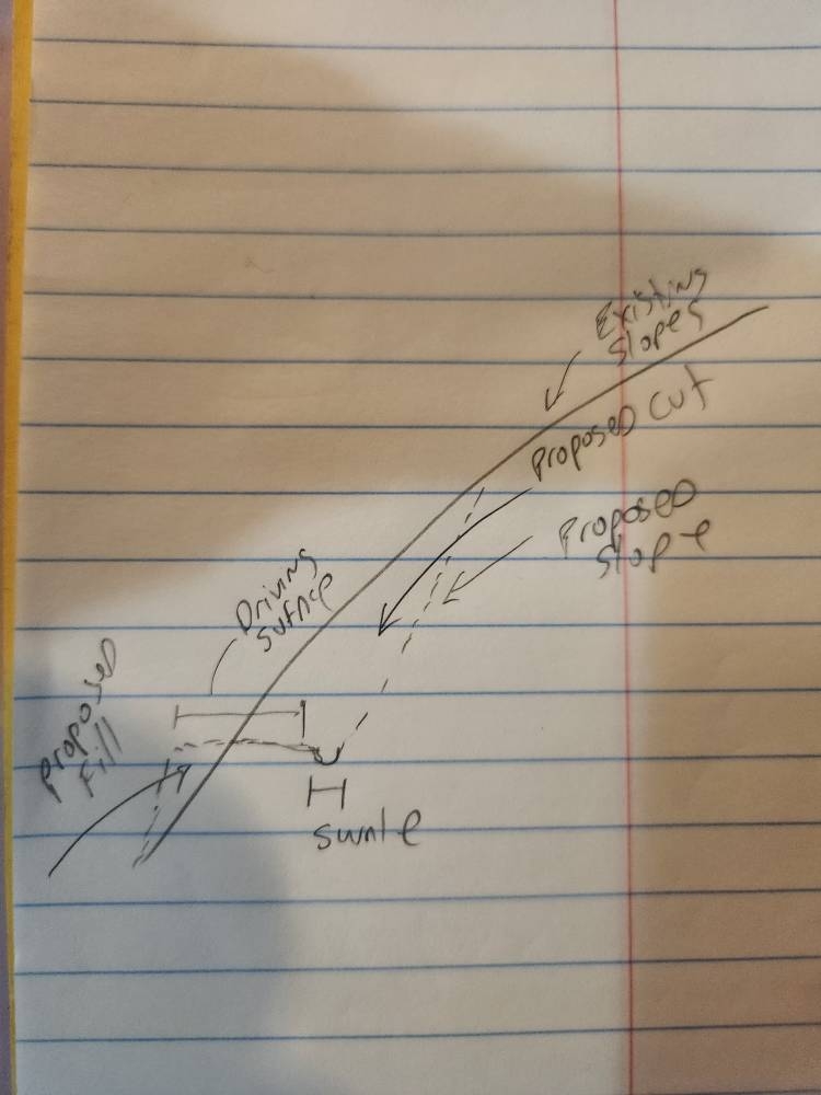

Maybe I wasn't really clear, the picture you shared is Basically correct, except that where the hill slope meets the inside of your drive, your going to need to create a dirtch/swale that keeps the water from running down your driving surface.
