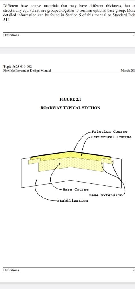

   / Prices on driveway paving #34
Attached is a pretty basic cross section. of a two lane road, wuth paved shoulders.
Also, I had to look up the traffic levels;
Traffic Level A; 300,000 adjusted single axle trips design load
Traffic Level B; 300,000 to 3,000,000
Traffic Level C; 3M-10M
Traffic Level D; 10M-30m
Traffic Level E; 30M+
So; if we take a look at a Traffic Level A; at 20 trips per day ( the ITE trips for a residential access); thats 41 years, of ware resistance to a passenger car. I'm no engineer, but those Design Equivalanrt Single Axle Loads; there is math that factors in weight ect, and it's not 100% linear; a 10,000# vehicle isn't simply double a 5,000# vehicle.
Sun, weather, and other factors will likely decay the asphalt surface layer before you reach the Traffic number for a home.
