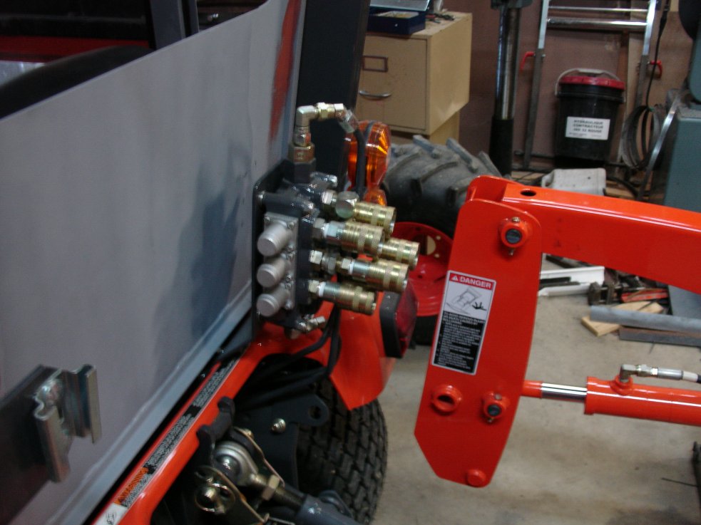

I'm looking into putting remotes on my BX22 for top, tilt, and pivot. But I can't figure out a good place to put the valves.. Does anybody have pictures of the valve placement on their BX?

I just had the valves installed on my bx2350. The plate to which the couplings are attached mounts on the right side of the ROPS and the levers for the come up through the available slot in the right rear fender. I can take a photo and send it to you but I don't know how to attach a photo here.
I have the BX7326 Valve kit which allows me to operate the chute deflector and the chute rotation.

I would realy like to see the picture.. Sticking up through the extra slot sounds better than being exposed on the ROPs. Is there a way to send an email to a member on TBN? I'm not sure I want to post my address in the forum..

   / Does anybody have remotes on their BX? #8
Here is my set-up.

... I used the outlets for the backhoe to plumb the hydraulics for my valve. It is mounted on the ROPS...
Renob, that sounds great. It would seem that you accomplished this on a BX24. Would it be possible for you to post details on which ports on the tractor were connected to which ports on the remote valve?
