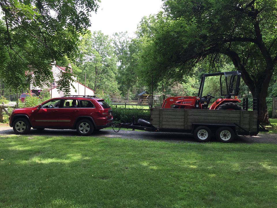

I occasionally (a few times a year) tow 9,000+ pounds with a 2011 Jeep Grand Cherokee. It does surprisingly well with this load. I do avoid hilly routes to be mindful of the transmission and I watch the trans temp. I've seen 205 F max on a long hill on a 90 degree day. It is very picky about tongue weight. It likes ~800 pounds. Less than that and the trailer sways. I've never gone with more tongue weight than that. I don't think the front end getting light is a real concern with my GC or with a 1/2 ton. If you do the math, 800 pounds of tongue weight can be counteracted by a passenger in the front seat. Not a real issue. The real issue is negative tongue weight when going over bumps so you need a good amount of tongue weight.
Surprisingly, once dialed in, I think the Jeep would handle any emergency maneuvers better with 9000 pounds in tow than my old F-250 did. But the jeep is very picky about proper set up and the F-250 is not. I'm not saying the Jeep is a better tow vehicle - no way. It's just a superior handling vehicle and with a well balanced load and perfectly dialed in brakes that trailer follows very nicely.
Is this load abusive on the Jeep? probably. But it is out of warrantee and it's only 3-4 times a year and usually less than 10 miles. So I doubt it will have much impact on longevity.
In the picture below the jeep and trailer are level with 800 pounds of tongue weight. The Jeep has some kind of hydraulic self leveling struts in the rear from the factory and they seem to handle the weight fine. Based on the door sticker GAWRs the Jeep can legally take its entire 1300 pound max pay load on the rear wheels. As long as the weight ratings work on the OPs truck, I would think some sort of helper / replacement springs in the rear would be enough for occasional heavy hauling. (along with well dialed in trailer brakes!)

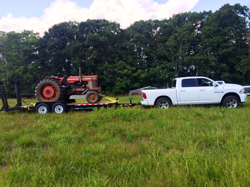

This on a 2006 Dodge 2500 Quad cab , long bed with 4 wheel drive and Auto Trans.
Amazon.com: Air Lift 88295 LoadLifter 5000 Ultimate Air Spring Kit with Internal Jounce Bumper: Automotive
Pull a 2015 Big Tex LX14 dump trailer . Accidently loaded over 10,000# of Granite in trailer a few weeks ago and it still pulled Great . Went From 10,800 gross empty to over 21,000 loaded . Fortunately only had to go maybe 7 or so Flat miles to my Moms from the rock place were I got loaded . ( And Dang , That Big Tex Dumped the load also :thumbsup: ) .
Minimum I run pressure is 20 lbs. . Cannot Run Them without air , voids warranty . Thus it will stiffen a little bit when empty , but run them up to 80 - 85 loaded and it rides Great . Use to run actual overload springs on old F250 , But they are Not adjustable thus constant stiff ride .
Fred H.

I run bags on my ram 1500.... Huge difference in sagging over the stock rear coils. The coils ride great but drop 2-3 inches with 500 lbs on the hitch. Here's the most load I've done.... Figure it's about 11,500lbs trailer and all with my bags at max 30psi. Only went about 8 miles. Had plenty of power and didn't stop horribly. Not sure id do it a lot though.
