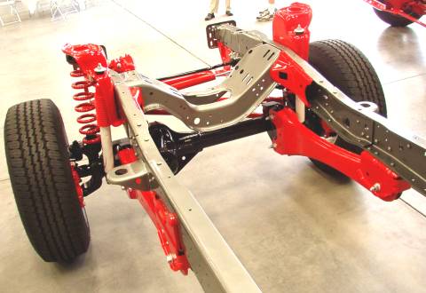

Got a 12 ton harbor freight jack today, but it was raining tonight... Waiting for a dry evening to have another go. Got a replacement caliper and ordered some of the Permatex copper anti seize compound, will have that tomorrow.
   / Does anyone know a special trick to get the wheel free from hub (F250 SD) ? #32
Put a screw jack between the wheel and leaf spring. It'll come off. Might want to put a 2x4 to distribute the pressure a bit. Had to do this on my Excursion.

Coils on the front of this 2008 model...
